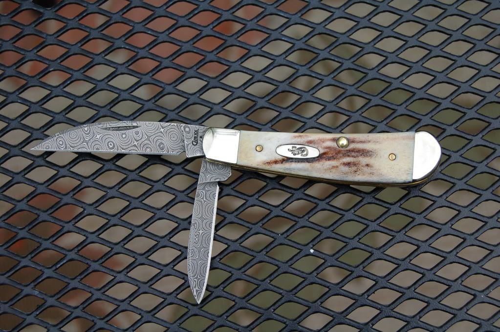

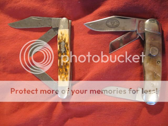

I have a Raindrop Stockman that i have used a lot, and I really have no problems with it now. When I first got it some of the features bothered me (blade placement and a couple other things). Mine is ground thin so it is a slicer, but I have taken it EDC and on (unsuccessful) hunting trips and it performed very well with sundry and bushcraft tasks, plus I think that it looks beautiful. I am not generally a fan of Case stag (I love the jigged bone on mine), so I would suggest having a look at the exact knife if possible, or get a trusted vendor to look it over with your preferences in stag in mind. I have the Swayback and am a lover of Wharncliffes so I wish I had the Raindrop pattern, but perhaps some day in the future. Sorry, I have no experience with the half whittler, but would like some.
Proof I have it:
Okay just a reason to try and show off, but can you blame me (you can for the bad pictures though).
As you probably already know, the damascus is Thomas Damascus . It is top level steel and will preform as you hope it will.

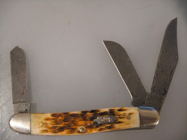

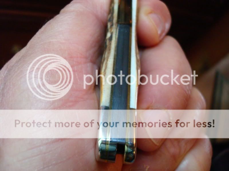

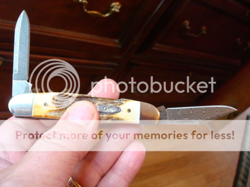

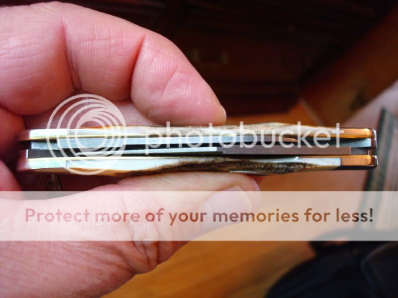

Christian, I just got this Case Damascus Half Whittler a week or so ago. The example I received is a very well built little knife. The only issue I have with it is Case's stag, it's pretty bad on this one.
The swedging is crisp, not rounded like you see on the CV and TruSharp blades. There are two springs but no center liner, which I found interesting. The width of the knife at the bolster is 3/8" so it's still pretty slim for a two blader (my Norfolk looks to be about 5/16" across the bolster. There are notches on each side to allow for accessing the nail nicks and it has sunk(en) joints.
On the knife I received there is no blade rub, no half stops, 5 to 6 pull on the springs and nice walk and talk. As always there was a burr on the blade (both) that had to be removed but it's nice and sharp now.
I have the Sway back in damascus also and I don't think you would be unhappy with either pattern in the Thomas Damascus. The higher price seems to result in a higher level of finish and detail.
Hope this helps.

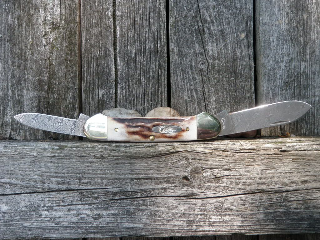

I have the same knife as cuts like a kris. I've found that the damascus blades hold an edge better than case's ss or cv blades. It's gotten quite a bit of pocket time on it and I can't think of a negative comment on it. I've admired the stag/damascus models but can't buy stag online. From a steel perspective though the damascus is good to go.
Pics because everyone else is showing off...

Gary, those shots are really helpful. The humpback half-whittler looks to be a well-made knife. Not to the level of the Bose collaborations of course, but much better than the entry level Case knives. The lines look much more crisp. Even the springs seem to be done well.

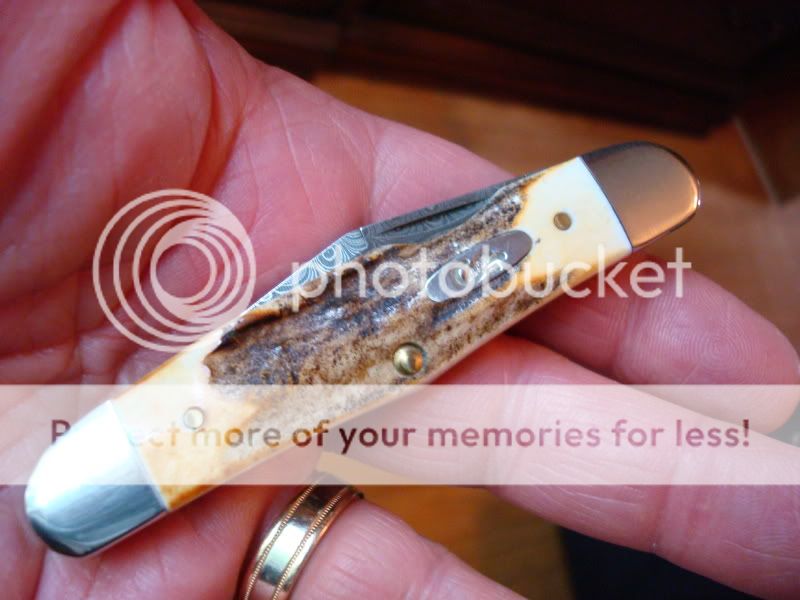

Just logged in and saw this post. I'll add my two cents.
For the last three months, I've been edc'ing the damascus peanut that Hamie gifted me last March. It has not been out of my pocket, and I've not babied it. It's been used as a fishing knife, box opener, whittler, rope cutter, and whatever knife. Broken down boxes after trips to Sam's Club, and once in a while as a paring knife in the kitchen.
I've touched up the blade a few times with my wallet diamond hone, and thats it. So far the edge holding has been very good, maybe better than the regular CV on my other peanuts. It's been a very impressive little knife, never failing to easily do what I needed in the way of a everyday pocket knife. Mr. Thomas made a very very good piece of steel! I've been more than pleased with this knife.
Now that I've broken the ice with the Case damascus, I wouldn't hesitate to buy a nice damascus and stag if I run across one.:thumbup:

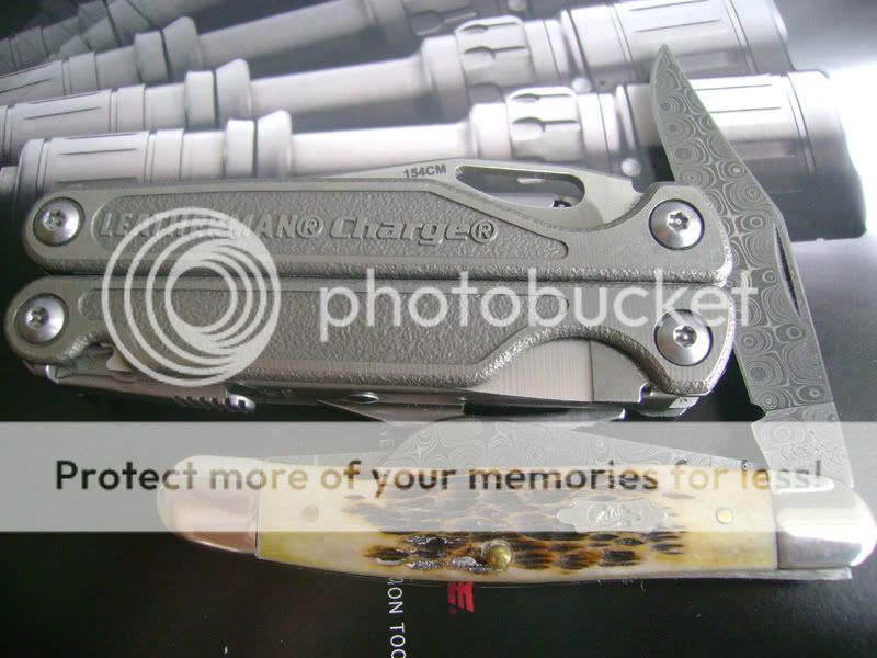

I have a Seahorse whittler in damascus. The steel seems to perform in roughly the same ballpark as CV. The blades have a smooth as-ground finish with nice crisp swedges that are much more comfortable and refined than the rough, sharp-edged as-ground G-10 Case knives, and the grinds have far better definition than the blurred lines of their tumbled blades, so short of the Case/Bose collaborations, I think the damascus blades are the best that they offer, aesthetically speaking. As has been noted, Case's low-grade burnt stag leaves a lot to be desired in terms of quality, hafting and matching. Aside from this one example, I tend to give it a wide berth.
