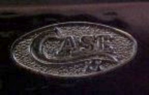

Here's a jack I picked up a while back. Never seen that shield before, any idea when Case used it?
Zooming in on the pic, the tang stamp looks like late-'80s vintage, with the 'lightning S' in the 'CASE' name, and the 'dots' adjacent to the 'SS' mark. The number of dots around the 'SS' will tell; if 3 dots -> 1987, 2 dots would be '88. I can't quite make it out, I think I see 2 or 3 dots.
(I have a 1987 3254 pattern yellow CV trapper with what looks like the same/similar shield.)
David
I'm going to say that is a raised letters and oval bordered shield which was used in late 1980's manufacture....
