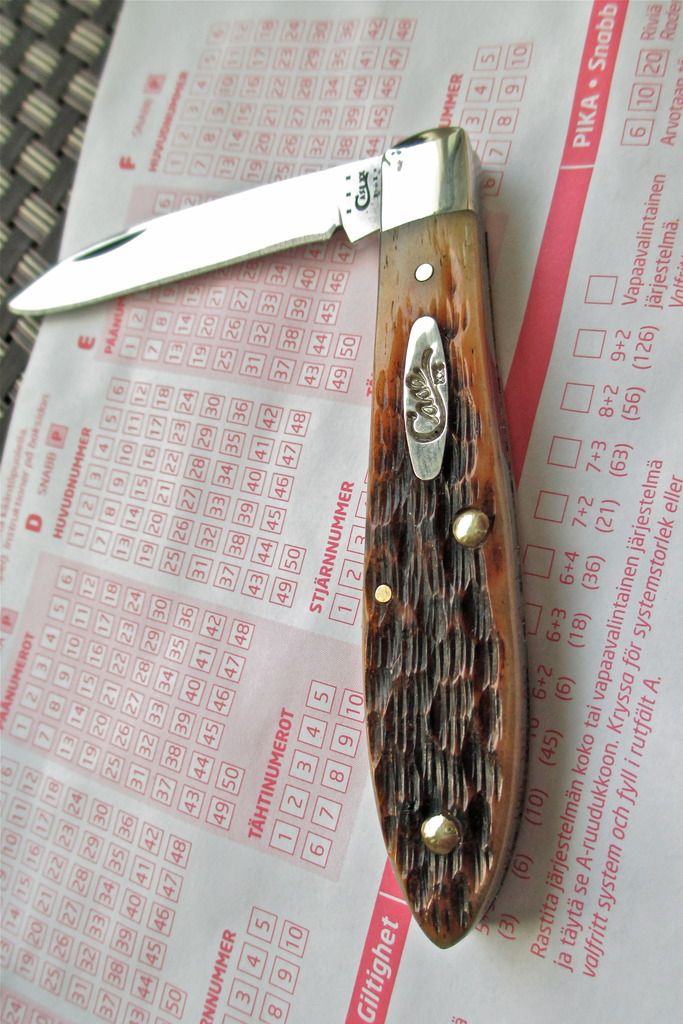

My experience: I had 3 of these knives - 2 blade Jack in Redbone but gave it away. Very nicely finished, wraparound spring is a fine touch but I actually found the knife oddly bulky for a knife with very small blades. Single blade stainless Amber Bone, this is Barehead and has 4 pins with a Spear blade. Once again, F&F is top no question, the Amber Bone is very attractive and there is much to like with this knife. Recently got a cv Chestnut Bone Wharncliffe single blade, F&F is also highly impressive, even good snap and the Chestnut Bone is a pretty handle choice. I like the Wharncliffe better than the Spear as it looks more suited to the frame and has a great pointy tip, the Spear doesn't. However, it's endcappped and 3 pins and that is not as pleasing as the Barehead version, having a very pointed candle tip I like the look of it more without the rear bolster, 4 pins is superior too.

The second I still have is a gift from @Will, the two blade pocket worn red. This is the kind of knife you take and forget until you need it, she is totally unobstrusive in the pocket.
