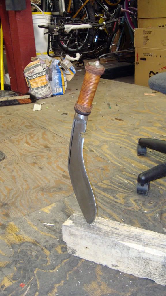

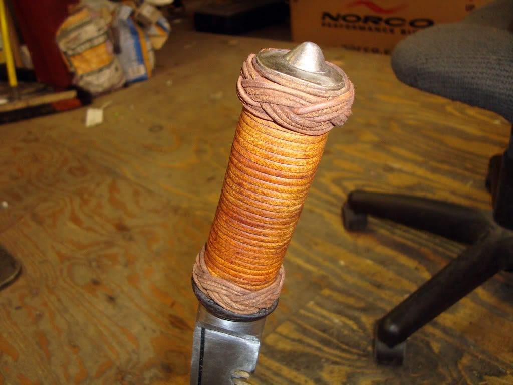

I thought the photo's were in good focus. That's about as good as I can do. And yea,it broke right at the cho. Talking about "abuse". Beating on a piece of metal with a punch to make a decoration doesn't make a lot of sense to me. Heck, there was a thread here about a Becker breaking at the roll mark. When they were made by Camillus, if I remember correctly. And Mr. Becker and, I forget, the guy who was overseeing production or something both said that just the roll mark unnessarily stressed the steel.
To be honest I like the Kukri Chos but also wonder if they don't do more harm than good.
However there can be a difference between a high force roll stamp and some pattern which was cut out with a file.
That it might still be bad is kind of indicated by your experience. Now I just need to google for broken Kukris to get a more complete picture. If lots of them fail right there...
Your broken Kukuri makes me concerned about buying any of the Indian kukuris. You probably should not have been beating on it, but I don't think it should have failed batoning with wood. It appears to me that their was a fracture in the steel if you have not been using it hard prior to this. The rust is the key.
Yes to the roll marked Beckers.That's why they are laser etching them now. My BK-2 and BK-7 are roll marked.
Buy a Himalayan Imports chiruwa ang khola and they are guaranteed for life and warranted as a pry bar. Can a HI blade fail sure but HI will stand behind it.

And you're not supposed to, because it has great potential to damage or completely fracture the blade. But of course you must know that since you just fractured a piece of 3/8" or so thickness forged steel. :)
Seriously though there is a potential it had a crack before you beat it to death.
Khukuri rarely fail but when they do it can be dangerous, glad your okay. The khukuri is mostly a chopping tool but I don't see why using it to baton would be considered abuse unless you were using a rock or another piece of steel. I agree though go with Himalayan imports next time, best khukuri bar none. The chiruwa ang Khola is a tank, theirs a reason why it's their only khukuri warrantied as a pry bar, near indestructible.
Looks like the blade was improperly hardened. The area above the cho is supposed to be dead soft.

If he was batonning by hitting the blade directly on top of the wood being split, why would it break on another part of the blade unless force was being applied to the breaking point as well? I still think the technique was part of the problem.
If he has batonned repeatedly with the knife, it could have fractured from misuse prior to the breakage, and moisture found it's way in the crack. We all know how easily HC steel rusts.
I fail to see how the Kukri, based on it's design, was ever designed to be batonned with.
1. If the knife was cracked to begin with the transfer of energy into the handle from hitting the blade could have been the final blow needed to separate the two pieces. Even with perfect technique the shock from hitting the blade will travel into the handle. With a sufficient defect perfect technique wont really matter.
2. He stated all ready that even though he agrees it was abuse that this was the first time he has tried such a thing with this knife.
3. Honestly most knives arent "designed" to be baton with period. Most companies consider it abuse. Since the popularity of batoning some makers have built special models and claim it is suitable but for the most part a knife is made to cut things.

A khukuri is a chopping tool (in this case a cracked chopping tool), and chopping is more stressful than batoning.

Exactly, except I wasn't applying a lot of pressure to the handle. The wood was oak the baton was hickory. Wood was already split and was about 18 inches long and a foot across. I was getting probably 6 smaller pieces off of each.
And yea, I would have thought that heavy chopping would put more stress at the cho than batoning.

I don't see abuse as the problem with a massive chopping blade that thick. As others have noticed, the blade looks as though it already had a serious crack. Kind of amazing it didn't break sooner.
But what I've never liked is the cho, which looks to me like a serious stress riser. Who knows what caused the crack, but it is suspicious to me that the crack was right above the cho.
Battoning would not be abuse with this blade, but battoning does put a shock load on the blade, and that kind of load will be picked up by any weakness in the blade.
