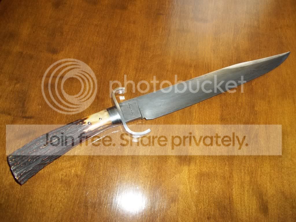

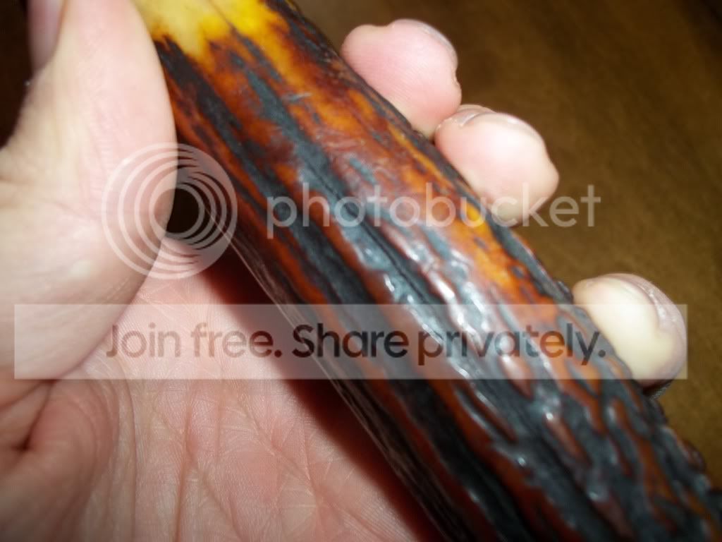

Is this crack in the stag a cause for concern? I have applied some mineral oil to it which seemed to lessen it some but it has returned over a weeks time. Any advice would be appreciated. Just not wanting to have it get so bad that it could loosen or worse.

So it is already a knife handle? If so, I would load it up with CA glue and hope the mineral oil didn't screw up your chances for a good patch job.
I agree with Rick. I've done this before to a couple of my own knives. Use some thin CA.

Remake the handle if it's already a knife - unless it's a real Loveless or Scagel or something.
Or if it's not on a knife yet, I'd cut into scales with the cut on the crack

Sorry for the lack of info. Yes this is my personal Bagwell that I just purchased. It wasn't too bad when I first got it but I think coming from Texas to Iowa where it was cold at the time where I had the heat on might of made it worse. I have boiler room heat too so there is more moisture in the air.

Beautiful knife! Yes, ca is super glue. Get a squeeze tube of the thin stuff(not gel) and drip it in. The stuff will wick in really fast and the porous core of the stag will suck it up good. You may need a lot. Keep a rag on hand to wipe off any pooling or drips. You will know when the crack gets full. You might be able to touch up with a super glue gel or maybe even some tung oil after it is dry.

If you are going to glue it, spray the crack liberally with brake parts cleaner. Wear safety glasses!
After it has dried out, hopefully you will have removed most of the oil.
Don't oil stag, horn, or bone. Ever.
Go over the crack with a black magic marker before you glue it. The glue will dissolve some of the ink, making it black.

Frankly, I don't think that crack is much to worry about. I could be wrong, but I would probably leave it alone. Barring major sudden shocks in temperature and humidity, that stag will probably outlast all of us.

I restore cutlery for a living. Never put oil on stag, horn, or ivory. It will soften and discolor it-and make any later repair attempts futile.
If you want to protect these materials, use paste wax.
