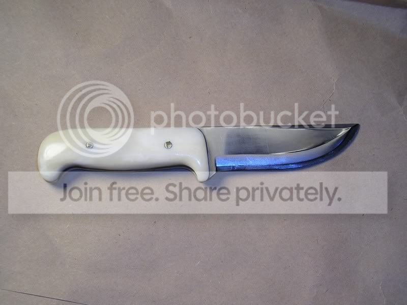

I made this little fellow for myself. It's my first time to use bone as a handle, hope ya'll like it. It's a 1095 SR... It's just 6" overall. Hopefully it will be just right for everyday chores...
Hello elginrunner: You did a outstanding job on that knife and super on the handles work as well. I use 1095 most of the time in my shop as well. But I like using 1084, and 52100 to. God bless and you are doing ok from what I can see.
Nice little knife you made there! If you don't mind sharing, how did you finish the bone handle? It looks quite smooth and shiny. -Matt-
I was pleased with the way it turned out. I went to petco and bought the bleached cow bone (without flavor!) and just cut the pieces out to fit. I sanded the slabs to a 400 grit, which got them pretty slick... then I used my dremel, buffing wheel, and craftsman "white" buffing compound.... they came out slicker' than ... well you know!
I'll be damned! I never would have thought of using bone from a pet store! Thanks for sharing! -Matt-

Be careful when grinding bone, mother of pearl and antler. That stuff can wreak havoc on your lungs. Use a breathing mask with dust filters.

The cow bone doesn't exactly stink, but it don't smell like roses either.... Oh and FYI.. I dont think I'd try and work it in the house, if you wanna stay married. The fine dust particles just hang in the air and take for ever to settle.... not to mention every thing gets a fine coat of cow dust....
Very nice, especially for a first attempt. I too would never have thought of petco as a supply for handle material. I shall be heading there for cow bones. lol. I have some whitetail deer leg bones from a harvest 2 years ago and it still smells like hell. I think this would be a better option.
