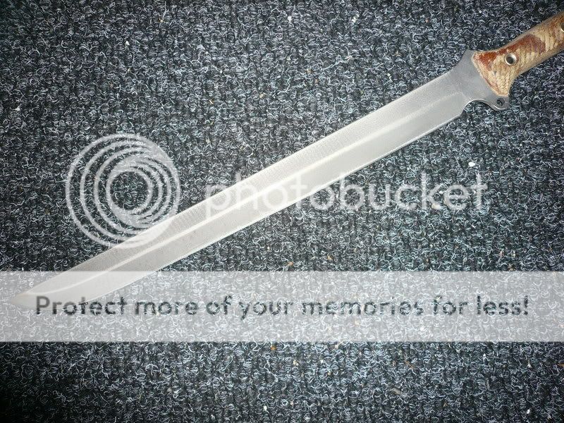

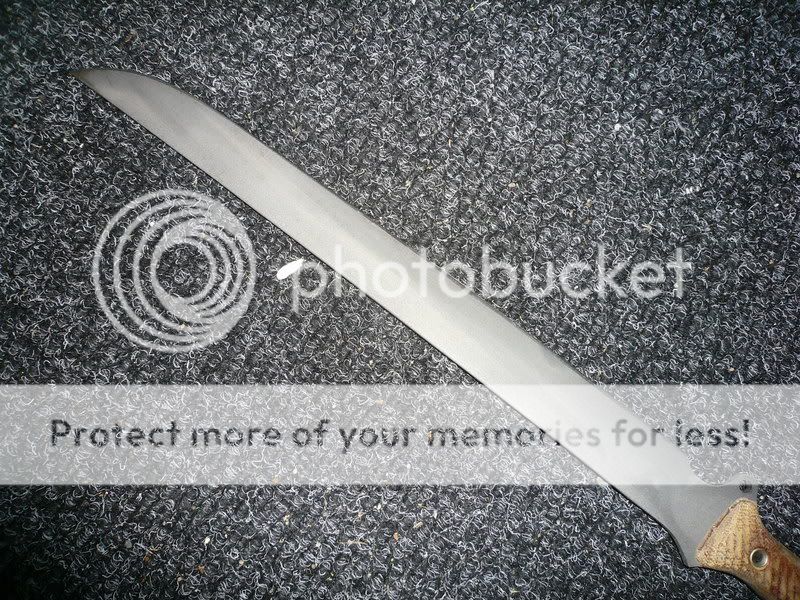

well sorta. after much deliberation, with myself, decided to strip my ruck. i was among the first to beat up one of these, so why not be the first to see her naked. at least post naked pics.

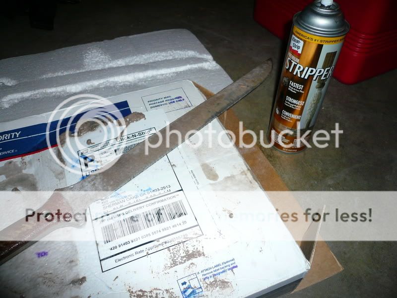

has the greyish undercoat, which i already knew, and the desert camo took some elbow grease to get off. one of the more difficult coatings to remove in my experience.
now the really difficulty part: satin finish this bad girl!!!
more pics as the project unfolds....
dont use styrofoam as a backing. paint stripper will melt the foam. lesson learned.
infi dimples clearly evident.

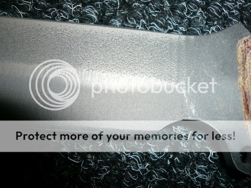

its a ruck. the dimples are average depth. the problem im finding is there is a dimple line on the primary bevel on each side. one runs about half the length of the blade.
this is gonna be tough!!! i have no grinders or such, only paper.

There shouldn't be dimples on the the primary bevels. I have stripped quit a few knives and none of them had dimples on the primary. Although I did have some deep nasty gouges on the flats. Those gouges look as if someone skipped a cutoff wheel across the surface. Those are the hardest to get out. Have fun if you plan on doing it by hand. It will take a long long time ;)
Just go pick up a 20 dollar 1/4 sheet hand sander and glue a hard flat surface such as micarta or plexiglass on top of the soft foam. It will make life much easier. The hard flat surface is to prevent the foam from rounding out your flat edges.

i will have to get the hand sander. there are definitely dimple lines on the primary bevels. ill post some pics tomorrow. there is also a deep grind gouge on one side were the bevel meets the flat. it is about 1/4" and circular.
no way will i be able to get these out hand sanding.

Does the paint stripper affect the handles? Or do you tape them?

You might also consider just hand rubbing the hell out of it with a sandpaper block with foam padding (to help contour a little) and some 2000 grit. That's basically what I did with my SHBM and it turned out great! The dimples/grind imperfections look really cool when polished up. I finished it off with rubbing compound to polishing compound. Might save you some trouble too :p.

no affect on the scales. micarta is tough stuff. aside from sulfuric or hydrochloric acids, i dont think there are many liquids that will affect them.

thats my plan. i like the dimples on the flats, but unfortunately the sides are not ground the same. there are variations along the primary bevel that are only evident once the coating was removed.
