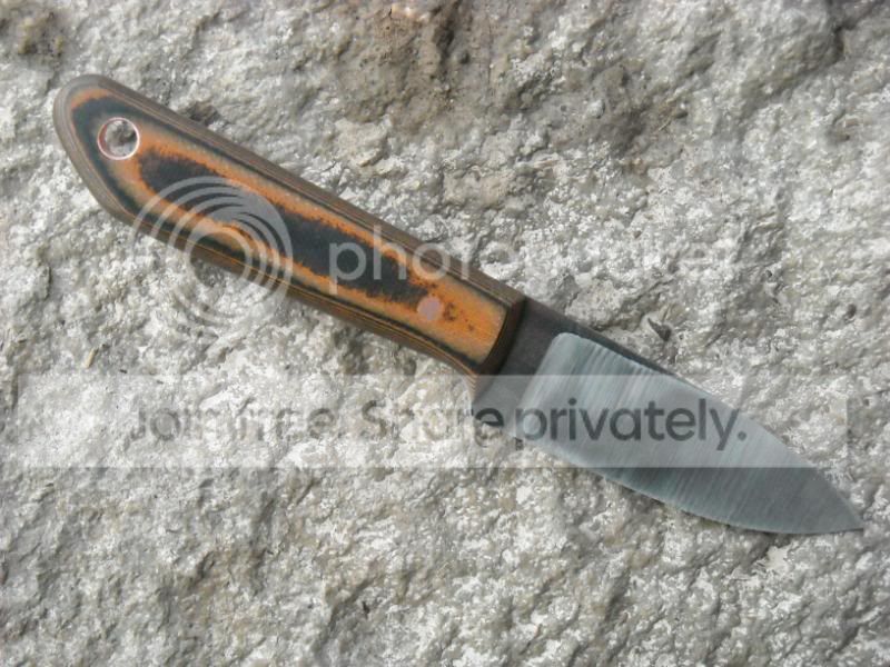

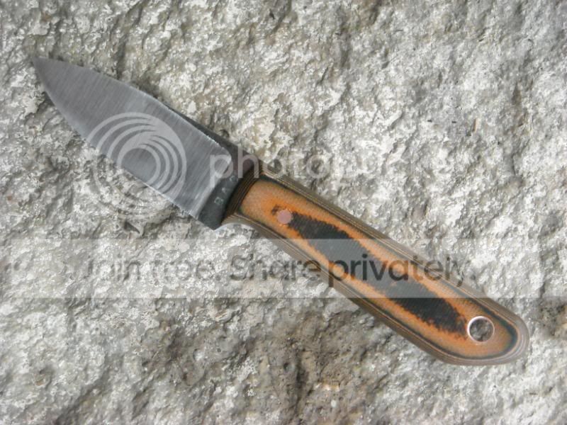

I ordered some black 1/8" G-10 and what came in the mail was Tiger 1/8" G-10. I should have sent it back, but thought maybe I'll try it maybe it will be OK......
I guess it's just in time for Halloween:)

I like the tiger everyone does black , the blade needs more sanding looks good overall
Bruce :D LOL You're being way to hard on yourself ...........
She doesn't look bad at all, however, it could & would look better if you take shunsui's advice and maybe put just a little more work into her.
Do you have a knife vise that will position the knife on its side ?
If so, clamp her up and get some 50 grit paper, preferably with the cloth backing. Rip some strips and do the shoeshine, equally on both sides, until you get rid of the corners on the handle. Take her down to a complete radius on each side. Move up through the grits until she's at ~ 600. I'll bet the "tiger" will look pretty darn good then ................
Spend a little more time on the blade (although it will be a pita to sand with the handle on) and I'll bet she looks like a million bucks :thumbup: ;)

That's not a bad knife at all. As stated, you may have quit working on it before it was finished is all. I really like the profile.
Bruce
I have to agree with you. I think the knife is ugly. No I'm not kidding and yes I feel better for having said the truth.:D Looks to be well made though! Nice crisp straight grind lines. Certainly very functional! Maybe take David's advice and give her a little love?

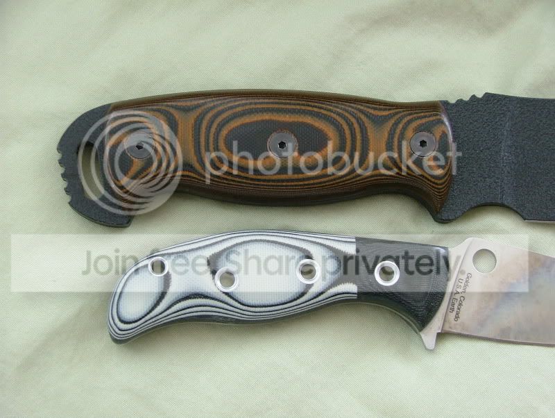

Bruce, that knife looks great! It's a good edc size and I like the shape. Personally, I like the tiger stripe G10. Black is just kinda, well, black. Try giving it some contours to bring out the contrasting layers and I think it'll look even better than it already does.
Here is a pic of a Ranger knife that I contoured the handles on, and Spyderco Mule that I made the handles for. Hopefully this helps with your tiger stripe!

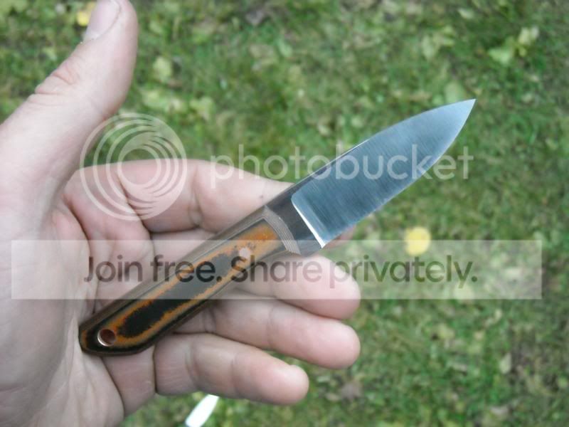

Well thanks guys. Yes the blade finish isn't (wasn't very good). I was playing around trying a few things to get a machine satin finish. It looks better now - last night I finished it with a 400 grit cork belt. I might try the dremel tool on the handle to see how that goes.

dl351 - I like what you did with those handles, looks good:thumbup:

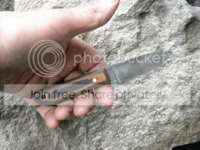

Here is a pic of the Halloween necker after the 400 grit cork belt:
