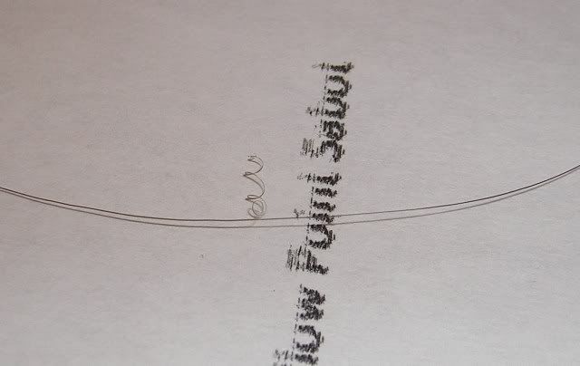

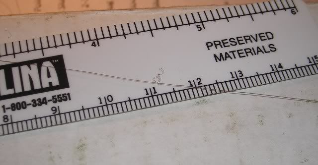

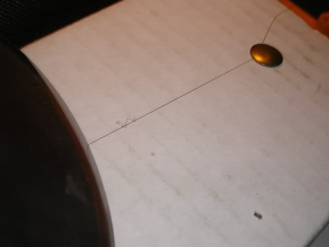

I've been watching a lot of sharpening threads lately. I can get most of my knives to whittle hair so there is not much left to impress me. Having been recently inspired by a thread on refining polished edges, I decided to try to get one of my hawks to whittle hair. I tried first with a cold steel spike hawk (CS hawks are easier to grind.sharpen) but couldn't get it past shaving sharp. Lots of guys here make their hawks shave so that just wouldn't do. Then I decided to try my handforged hawk from Coal Creek Forge. It took a lot more effort to refine the edge (much better heat treat and durability) but the screaming sharp edge I ended up with was able to whittle a hair!!!
Here is the hawk
Here is the edge
Here is the hair
Here is the video!!!
