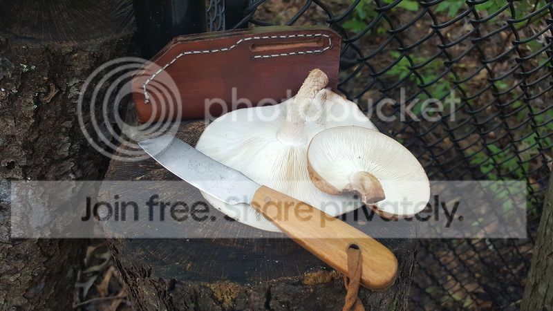

I have used eastern red cedar with good results. Here's a pic of one:
This one was made for a friend from a very old "tobacco stick" he salvaged from a Maryland barn. These sticks are used to suspend the tobacco leaves inside a barn for drying. And the wood in this case was easily 100 years old. So it had undoubtedly been "age stabilized" -- if that's possible -- when I got to it. Anyway, the photo above was taken about 2 years after I finished the knife, and my friend reports all is well and he's loving the knife for his mushroom harvesting forays.
