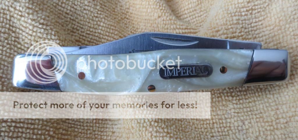

This one uses modern acrylic, it's tough and looks great.
Now I'm more confused. JPD, your Imperial does NOT have celluloid handles?? I was recently looking at Schrade Imperials on a vendor's website, and they're all advertised as having celluloid covers. (I'm not sure whether your example is "cracked ice" or "pearlized", but the site I checked said both were celluloid.)

The Imperial I bought is "cracked ice" and even though they call it celluloid it's a modern acrylic.
