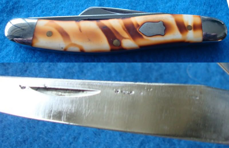

I have a dozen or so celluloid or similar scaled knives. I have often heard of the damaging out gassing that can occur and I have some questions for those who have the knowledge on the subject. I do suspect some of mine are of a more modern material...when was celluloid used and is the same material being used today?
1. Is there a more than a single type of celluloid on vintage knives and if so how do you tell the difference.
2. Do all celluloids cause damage?
3. What kind of damage is it. Look at this Schrade, you will see small pits that developed in the main blade just at the scale line. Is this out gassing problems?
4. Is there any way to prevent either damage or the out gassing?
5. I do suspect some of mine are of a more modern material...when was celluloid used and is the same material being used today?
My celluloid are all store in open air on shelves and never catch sunlight, is there anything else I can do to protect them?
I have never seen that material break down on a Schrade. Does anyone know what it is? I thought it was Delrin, and I have seen two Delrin handles deteriorate, one a Case, and one a Queen..

invented about 1860 & used extensively 1st on many razors.i've had razors well over 100 yrs. no problem. guess the 20s & 30s saw wide use in pocketknives.i've seen knives 80 yrs. old with mint handles of cell. also had knives in 1970s ,80s,&90s which went crazy. the best solution is to segerate cell. from others.production outlawed in u.s. for a long time since its so flammable. sometimes buffer heat can start it going & it looks like a sparkler as it burns.off gassing tends to pit, certainly more severe than surface tarnish.i had one knife in box of 13 others & it damaged all the others. as far as i know early signs are difficult to detect. once it starts i know of no corrective measures but handle replacement. schrade pictured could have been damaged by anoth=er knife, then blade buffed off. the handle on the schrade is not the problem at present. good advice is to keep safe queens of cell. in separate safe. gecs knives are acrylic & very stable.acrylic can be damaged by some solvents so watch what you clean with. i ruined one handle in 80s by spraying with carberator cleaner.
From what was said I am guessing there will be visible signs such as shrinkage when celluloid starts going bad. I am also guess the Schrade pictured is not celluloid. Would this be correct?
Yes I do believe you are correct:thumbup:. There is also a cell version of that material (butter and molasses) but it is more opaque in color than that particular material ( if I understand it is a delrin:o) I am sure one of the more astute Schrade Collectors will corret me if I am wrong:thumbup:;) Come on Thawk, Codger:p ETC ETC!
And correction is NO problem;)we all want proper INFO.

The Schrade above appears to be delrin by the looks. You can kind of tell bt scratching or tapping it with your fingernail. If it is hard it is celluloid ,if it has a soft feel to it its delrin. Celluloid in its appearance is unmistakably beautiful compared to the dull appearance of delrin. Acrylic is used on the modern knives and can be just as appealing as celluloid and it is stable as far as outgassing and shrinkage.Keep it away from acetone or other harsh solvent.
These are just my opinions from ovservations over the years and I'm not claiming to be an expert or anything so please take it at face value.

that knife that Absintheur posted is cell, or maybe an acrylic but i dont think its delrin... i was under the assumption that delrin could be dyed, jigged etc. but wasn't necessarily a replacement for celluloid. Didnt think it was capable of that kinda figuring/swirling... maybe i'm mistaken, wouldnt be the first time:)
But look at alot of older delrin knives the scales start to wear down and reveal the base color, which on mine is one flat base color
