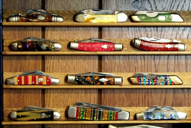

And there is a lack of color in this thread...lol...
here are a few of mine...
this one I gifted to Dad for Christmas...

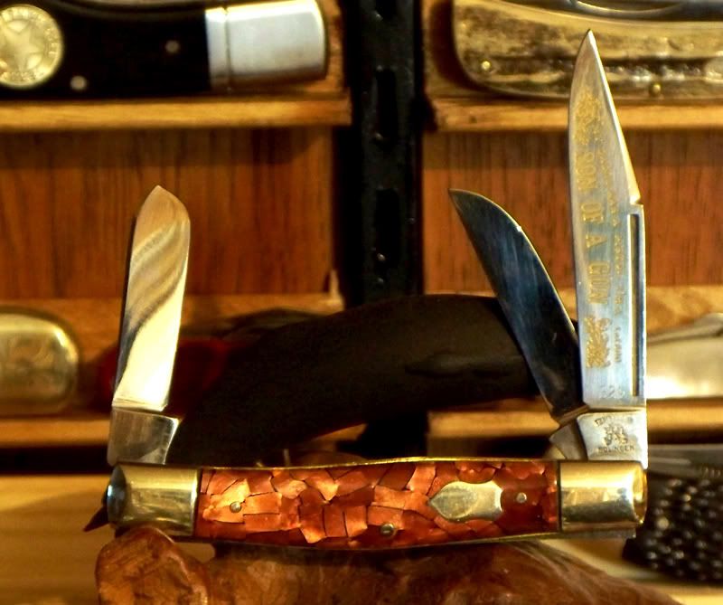

Here is same knife in thread above. Never handled or 'medicated' since the earlier photos were taken back in Jan. 08. (Yes, I go that long never handling some knives, many in fact)
Absintheur, I sure like that "cherry bomb" sowbelly with the club shield and match striker pulls. Is it a Bulldog?

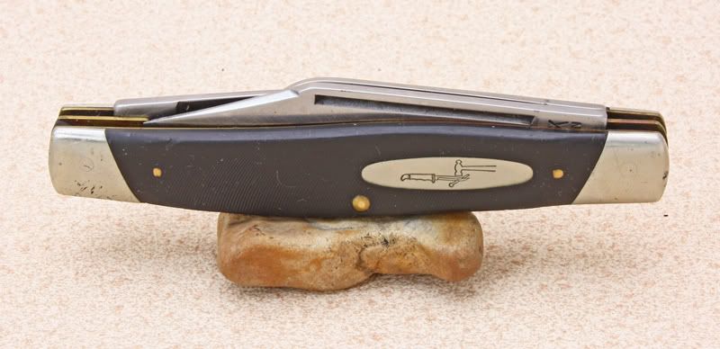

Ivan, I will find that reference to gassing out to quote. Maybe I should NOT have referenced an association with Delrin aging and metal destruction. Let me show you a picture of what I called Delrin aging and have recently read someone else calling it gassing out, more of a surface 'deposit' caused by age and 'light' effect. Seems to happen much much slower to Delrin protected from UV 'lights'. Also the oil of handling seems to stem any degrading. If you have this 'scum' on scales just lightly oil them up a couple of times... 300Bucks
wow so it "whites out":) strange but it doesnt look to be curling or pulling away at the bolsters or completely degrading, i inherited an old dunlap cattleman that literally looked like it had burned up, pretty bad corrosion to the steel too
so i rehandled it and cleaned it as best i could and it lives on, its a bit rough looking but its usable
thanks for the pict illustrating the problem!
