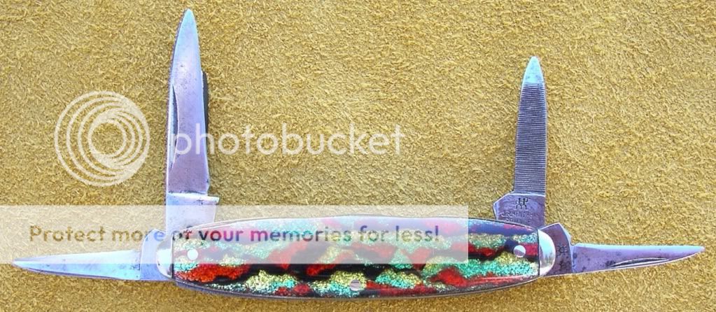

Here's an old Henckels 2 3/4" Oval Pen knife with what i think are celluloid handles (Antique Christmas Tree)
roland
