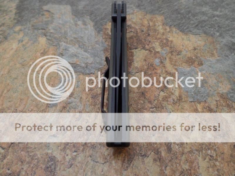

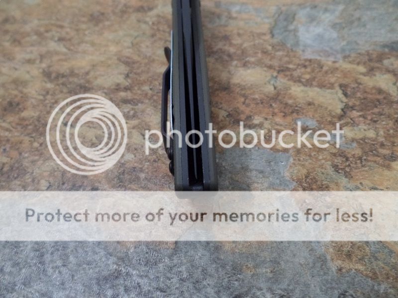

Very helpful Steve. I thought I had tried everything for my 710-801 but never thought to put the blade in a vice. I clamped it in there and torqued it over a couple times and centered it right up. Thanks for taking the time to share some knowledge.

Hey, nice to hear from you, -Corey- -Corey- , and thanks for the kind words. That's a sweet knife that's even sweeter now with perfect centering!
