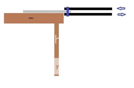

Try these steps:
Open the blade.
Loosen the screws.
Hold the knife horizontal, blade facing away from you, so you are looking down between the liners where the blade goes when folded.
Press the side of the end of the blade against a vertical surface, like the edge of your desk.
Put pressure on the side of the blade, to move it in the opposite direction that you want it to be shifted when closed.
While maintaining pressure, tighten the screws.
Let us know if this works for you.
I hope my instructions make sense. Good Luck!

are you referring to something like this?
Not even close!
I'm not sure how to explain what I mean. The knife should be in your hand with the tip of the blade pointing away from you. The edge of the blade should be facing up. You should be applying pressure on the side of the blade, as if you were trying to bend the blade. You aren't trying to bend the blade, so don't press that hard! Press the side of the blade in the opposite direction that you want the blade to move when it is closed. If the blade is too close to the right liner when closed, press to move the blade to the right when the blade is open. Tighten the screws while maintaining pressure. This will have the same effect as trying to centre the blade while it is closed, by pressing it to the left. The advantage of doing it with the blade open, is that you can apply more pressure and move the blade farther, without it hitting the other liner as you push it.

I have centered it :cool:
I opened the blade and then, like any caveman in rage i tried to bend the handle (below the pivot) in the desired direction. grabbed it with the fingers on the one side and bent it with the thumbs from the opposite side. Of course, I was rather gentle and did it in steps. Few bends, close the blade, check and repeat. Man, the grivory + liners are incredibly tough.
