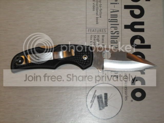

I decided to try some various stripping methods (shirt first, pants first, etc.). I got out two Spydercos that I've EDC'd in the past that have pretty banged up clips.
This is the first, a Golden Native. I stripped it with 400 grit sandpaper and I'm pretty pleased with the results. There's still some scratches that need to be buffed out, but I can't find any higher grit paper at the moment.
Pardon the photo quality, it's late and I just took a picture without too much thought behind it.
I've got the clip and barrel screw from my Endura soaking in some acetone right now, so we'll see which method I like better once that one's finished. The only reason I didn't go right for the C4 is, like the higher grit sand paper, I'm having some difficulty putting my hands on some torx bits at the moment (they're around here somewhere).
I've never really had a reason to care who knows I'm carrying a knife, so the SS clips don't bother me. Interestingly enough, my EDC BM710 has a really banged up clip that I have no desire in replacing or stripping... gives te knife character.
