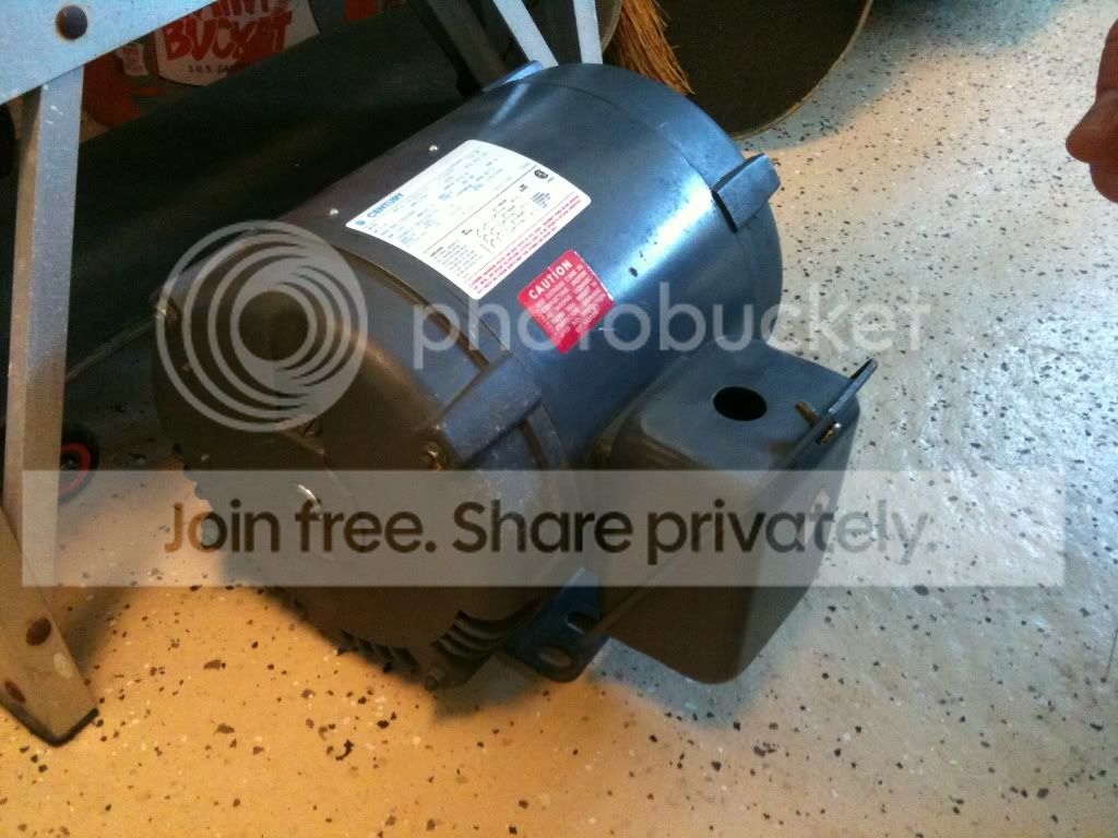

Century 3hp 3ph motor found (free!) - Good find?
Well except for the DP (drip proof) enclosure it would turn a belt pretty darn good. But it is a big deal being an open frame motor. Build up steel dust in there and short out across the coils would be bad. I think that would need somewhere around 2cubic feet of air space to be enclosed totally. But you want TEFC type for dirty grinding work.
-Xander
You obviously paid too much. Well, you will once the doctor bills come in for throwing your back out trying to lift it.
Hmm. Is there a way to build an enclosure for it? I suppose I'll start researching that now.

The downsides I see are
The open frame
The 3 HP VFD's are a fair bit more $ than the 1,5 or 2 HP ones
The heavier breaker and wiring needed to run it, probably 220 single phase 12 amp double breaker
The larger shaft needs a pulley, probably a standard size, but check it.
I would try do advertise it on Kijiji, Craig s list whatever
Try and do a swap for a 3 phase TEFC
2 hp if you have 220v
1.5 hp if you have 110v
That sort of swap is pretty unlikely it may take a long time to find that.
You can find other motors at decent prices 50-100 will get you a nice motor
Shiipping is high for the weight, local is nice
Everything I read (some being from this very forum) advise against using an open frame motor and holding out for a TEFC. I'm a bit upset now because I thought this was going to be the diamond in the rough haha.
12345678910, your advice seems to be pretty logical given my situation. I'll see what I can do.

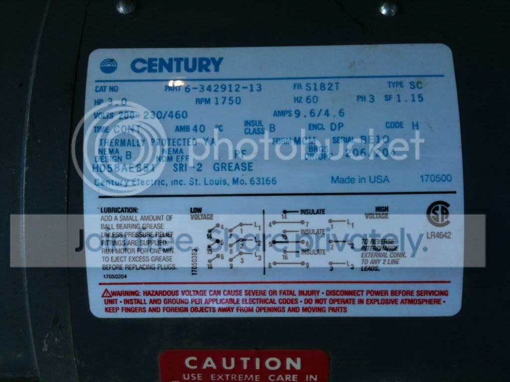

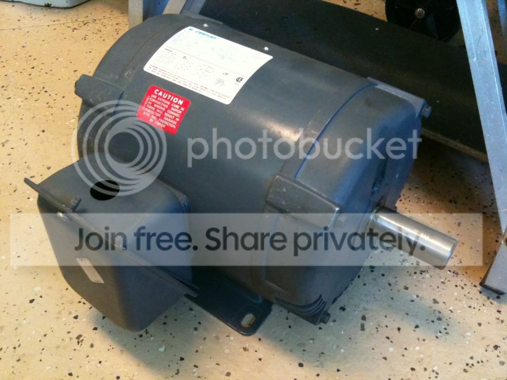

I am saving this one for a special project, probably my powerhammer when I finally build one. And you ain't kiddin' on the weight! I paid 60$ did I do ok?
That motor only runs 10 amps at 220. You wouldn't need that big of wire for your 3hp VFD. I find the extra wire and breaker are well worth the power yield. I run a 3hp 3phase Baldor motor with an open frame on my big grinder, I blow it out with the compressor fairly often when I blow down the grinding area. It's been running for almost two years with no problems. I use the TECO FM50 203, which is a very good Nema1 3hp VFD- last I checked it retails for under $200 from Factorymation.
That motor is nearly identical to what I have on my powerhammer. When I needed v-belt sheaves for the motor to run the hammer, Grainger had what I needed, no prob. I do recommend you shop at surplus center as well for the sheaves, if they have what you need it will likely be much cheaper than Grainger.
I'd use it for sure.
