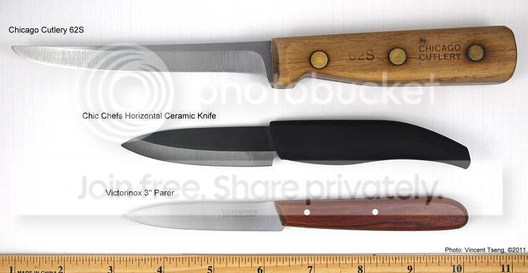

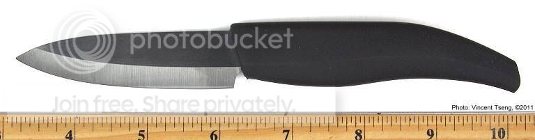

until today when I received a real cheapo ceramic paring knife
(shipped from Hong Kong - cost less than $6 shipped).
Pics:

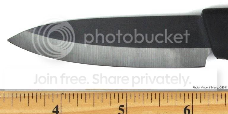

Blade detail:
This one seems a bit sharper - still not as sharp as I can almost any steel knife including real cheapos -
but this time this ceramic knife seems "acceptably" sharp and seems to do quite well in the kitchen cutting up soft foods - which is what it's meant to be designed for.
Despite the fact it is only marginal on cutting hanging paper - only barely acceptable - on foods it seemed as it holds its own even compared with my Victorinox 3" parer (one of the sharpest kitchen knives around) and my old Chicago Cutlery 62S 5" utility -
In that way I am quite impressed - it is definitely not the sharpest knife, no where near in fact - in the usual tests -
BUT - for using it as intended on soft foods it appears to match even my best knives.

Most, if not all ceramic knives are made of zirconium oxide, the same as your original Boker, it is just cheaper to make them in China instead of Japan now. They are not any tougher.
Your kitchen knife has better edge geometry than the Boker folder, so it will feel like it cuts better, but that is true for any steel kitchen knife v. steel folder.

I liked the looks of the black blade -
and surprisingly acording to the Wikipedia on ceramic knife
" Several brands now offer a black colored blade made through an additional hot isostatic pressing (HIP) step, which improves the toughness. "
So by the looks of it not much has changed from the first one I tried -
although the geometry of this parer is much better.

buy a Forschner
Most of the Forschner kitchen knives are actually Victorinox -
and I agree they are some of the best kitchen knives out there -
my main usage knife is the 8" Victorinox/Forschner chef -
and my pic showed the 3" Victorinox/Forschner parer with bubinga handle instead of the usual fibrox/plastic one.

I think/guess that ceramic knives may be using the "sawing" cut from micro-serrations to get its sharpness.
This cheapo paring knife seems to be a lot better than the Boker ceramic folder I had years ago. Probably due to better geometry and more acute bevel leading up to the edge - more like kitchen knife geometry rather than the pocket knife geometry - but I think/guess it may be the micro-serrations that's doing the cutting.
