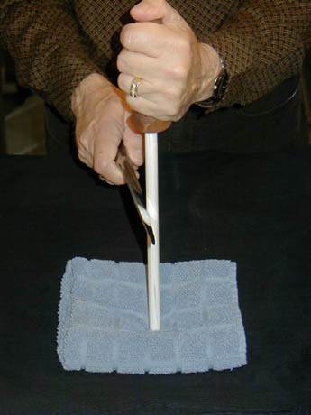

From my experience both steel and ceramic remove material, the question is to what degree.. I request all my customers use a ceramic, the hard part is finding them on a store shelf.
All ceramics for knives will remove 'some' metal, though not very much if used correctly.
But only a 'Butcher's Steel' will remove metal. A 'Meat Packer's Steel' will not.
The Butcher's Steel is basically a round file with the teeth running the long way up and down the rod.
A Meat Packer's Steel has a completely smooth surface, and does a far better job of reforming the edge rather than tearing off the burr of a turned edge. This is the same advantage of using Borosilicate glass rods for daily maintenance of kitchen knives.
There is nothing 'new' about Borosilicate glass. It is cheaper and easier to produce than ordinary window glass, and you already have it in your home kitchen. You know it as "Pyrex," the glass used for casserole dishes, pie plates, meatloaf pans, etc. It's also the glass used for most chemical laboratory test tubes and such, and so if you have a chemical supply shop in your area, you can buy a borosilicate glass rod for just a couple of bucks. Most chemical supply houses will make what you want to order. Just ask for a 12"-15" x 1/2" Pyrex rod. Probably won't cost more than $10. You can also buy them already made with a really pretty wooden handle for about $75 from knife sharpening shops. Or just use the rim of one of your baking dishes. The long edge of a meatloaf pan works great!
When used in this fashion, 'steeling' is safe enough for the clumsiest cook.

I wonder how many people can hold their hand perfectly vertical? Absolute 90°
Especially when shifting from side to side to side...
I'd think that if it were easy, they wouldn't sell so many T-squares, Plumb Bobs, and framing levels.

If it were actually measured with scientific precision on each pass, I'm certain the answer would be 'none'. And I'd also bet there aren't many people who could hold it within 2° - 3° on either side of vertical. Good thing is, it really doesn't need to be perfect, for the sake of what's essentially a 'freehand' edge on the Sharpmaker or other similar device. That's where the 'feel' aspect is important, so long as one can feel when the edge bevel is flush to the hone. That is what makes the difference. If you've ever tried to hold something like a flashlight or laser pen steady in your hand, it's virtually impossible to keep the spot of light from jumping & wobbling around as seen on the wall or ceiling. And that's just when holding still; expecting to duplicate it on the tens/hundreds of consecutive strokes on a sharpening device is in the realm of fantasy.
( It would be a real eye-opener, to affix a laser pen to the spine of a knife blade, with the 'dot' projected onto a line drawn parallel to the blade on the ceiling above, and see how much it jumps around to either side, during multiple passes on the sharpener. That would be among the best of 'reality checks' I could think of, if one actually starts believing their hand is that steady. If done with an open mind, it might serve as good practice. :) )
If you think about it, the 'precision' is only important when initially positioning the edge against the hone. If there is some movement away from 'perfect' during the stroke, so long as the movement rotates the shoulders of the edge bevel into the hone, as opposed to rotating the edge's apex into the hone, then you can still produce a very clean, sharp apex. A little 'convexing' of the bevels above the edge is not a big deal, and I even view it as beneficial.

I think you would be surprised how easily you are able to hold a knife vertically. If the instructions told them to move their eyeball laterally instead of trying to do it with your head still people would do better. As it is, it's a parallax issue of about 1/2* in my experience.
Look at how many people get good results with the Sharpmaker. They all have to be able to hold the knife vertically to get good results, IMHO.
Judging only by the numbers of T-Squares, framing squares and bubble levels sold in every home center all over the world, yes... I'd be very surprised.
My post didn't ask if people got good results. The post referred to the ability to hold a perfect 90° angle. Of course we get good results from the Sharpmaker. That's why we use it (and why I use mine every week to touch up my kitchen knives.) But no, we don't have to hold it vertically to get good results. We just have to hold it the same way each time to get good results. That's why clamped systems are so popular, and free-handing is a skill that needs practice to master.
