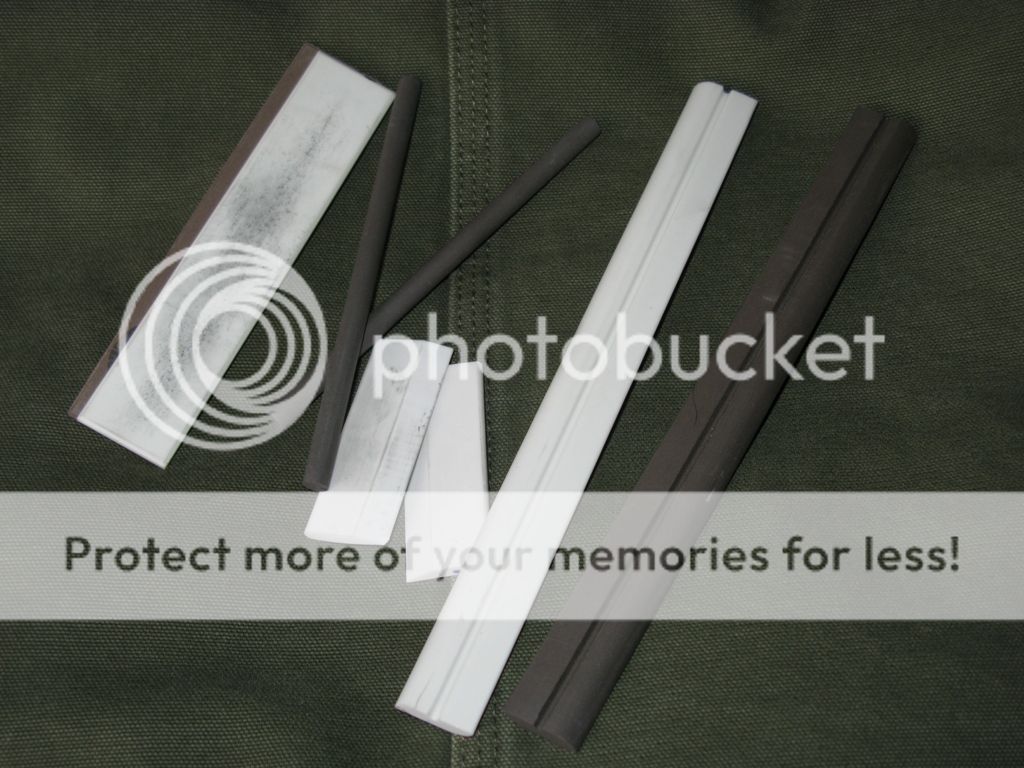

HOW do you know that? Have you used them? Spyderco makes some of the best ceramic sharpening stones, and has made a lot of different shapes over the years, round, teardrop, etc. (I have quite a few of 'em) and yet the triangular sharpmaker rods remain. Why do you think that is? Maybe because folks obviously more educated in the field than you are made that decision. Think about that for a moment.
(The shape on the right might look familiar if you followed 1234's link. The tri-angle stones work better. And that an experienced opinion.;))
