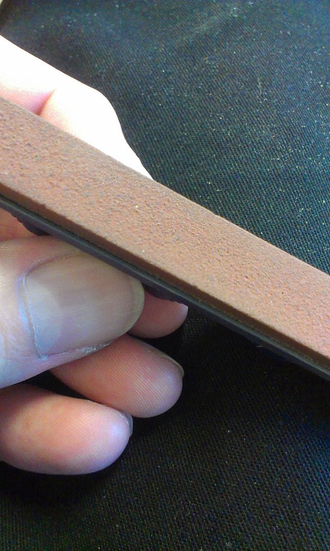

Okay I just got done media blasting my Lansky ceramic. I took a quick before shot but I'm having trouble uploading to PB right now.
Before blasting the surface was super smooth. Running my finger nails across the surface (very scientific, I know) it almost felt like a very smooth chalk board. That's the best description I could think of.
Now... Well, the blaster here at work uses glass media. Pretty safe stuff. I've blasted several knives and came away with a nice satin finish. The ceramic now feels very aggressive. I'm actually surprised at how aggressive it feels. I have a pic that I'll upload in a bit. Can't wait to try it on a blade to see how it cuts.
I'm wondering what the binder is in these. Almost feels plastic-y?
Pics in a bit.
If it's the same as the Lansky ceramic I had years ago, there is no binder when it's finished. The Aluminum Oxide (Alumina) particles are sintered and bonded together that way, like CPM steels, but with more temperature and time.
Before
After
Thanks for those pics! I have some spyderco pocket stone i'm going to be getting in hopefully and will have to find someone to do that for me. What grit glass did you use? If it's rated that way. Never used glass before. And as far as i can tell, me2 is right. "Ceramics" don't use a binder. Similar to ceramic knives, too. I think ceramic stones have a lot of untapped potential.
Duh on the binders! I must have been really tired. ;)

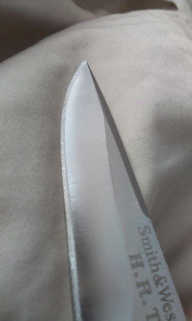

So I ran an old S&W over the ceramic. It's just as aggressive as it looks. I thought that it might immediately level off, but it cuts the steel just fine.
Here's a pic of the edge. I had my usual trouble of getting a decent shot. One of these days I'll pick up the expensive dslr that I bought months ago and put down the phone! :D
I'd say it cuts about the same as a coarse Norton SiC. Maybe even more aggressive actually raising a very quick burr.
Keep in mind, that stone would put a very polished edge on a blade before blasting. More so than my 1500 white ceramic. It was rated at 600 grit, but it never cut anything like that.
It's an entirely different stone now!
