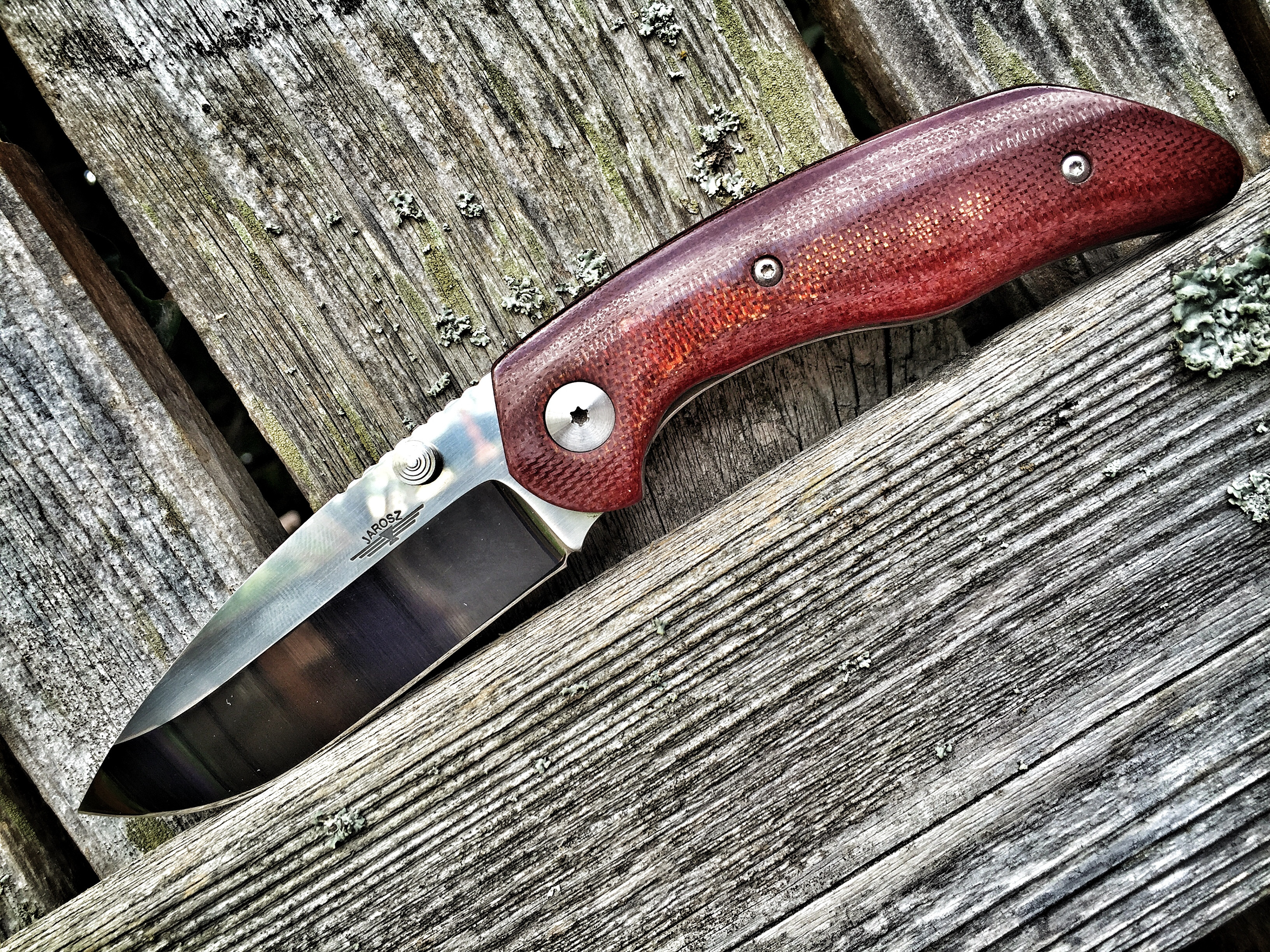

Wow aleforme...that's G10?!? I take back what I said about it looking "cheap"...that stuff looks amazing. Are you sure that's not Micarta or some sort of dyed exotic stabilized hardwood? Did you Google this &-or learn about this in a college setting?? That stuff is beautiful.
No Google but I did go to college.
This is from Jesse Jarosz, the knife maker. I actually bought this used from an individual but I do have a certificate from Jesse saying it's G10. He does some amazing stuff. Here is another photo. Looks like leather to me.
