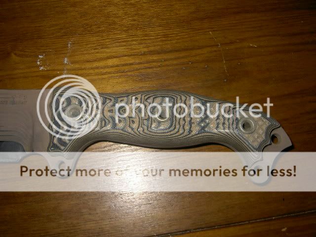

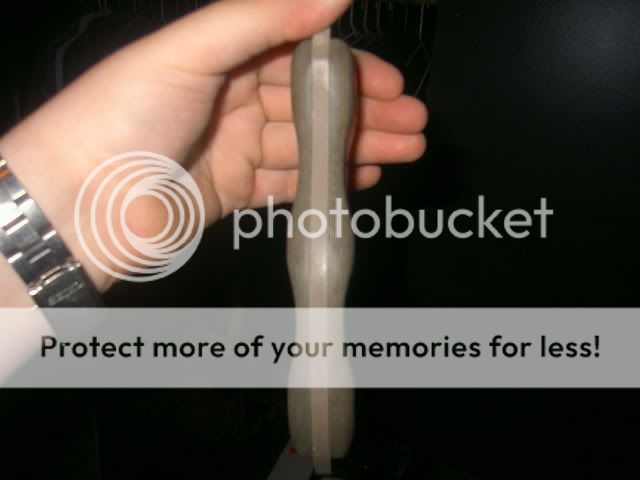

I got my FBM a while back after some grief. Some of you may remember the thread I made when I finally got it. Anyway, I've been using it a lot. I've really beaten on this thing, and through my beatings, I realized that the handles were absolutely devastating to my hands. The texture carved into the slabs were like a chainsaw on my thumbs.

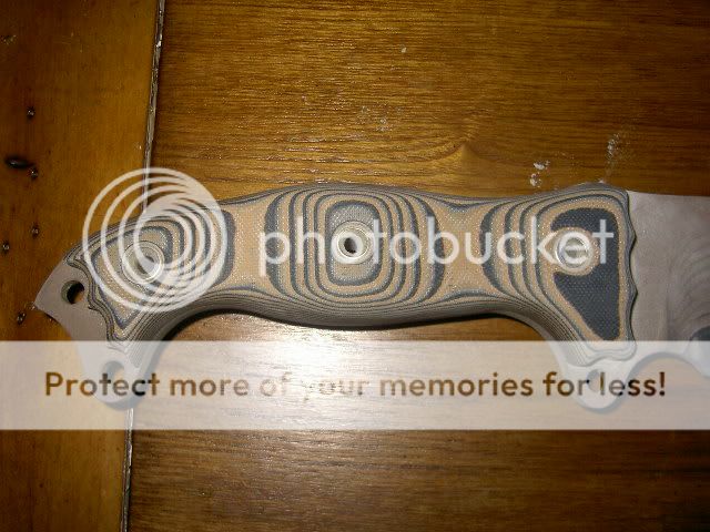

Anyway, I called the shop and asked about some options for getting a smooth handle, but I had no interest in turning it into a custom piece, so I decided to take it upon myself. It took almost four hours with breaks. I only used 120 grit sand paper and my hands. I used a sanding block on some of the flats on the handle once I realized one was available, but it was mostly all by hand. I'm really pleased with the results.
Here are the pictures:

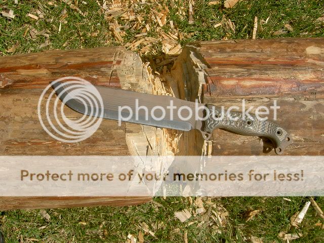

Here is is brand new, no mods:
Here with a lot of use, still no mods:

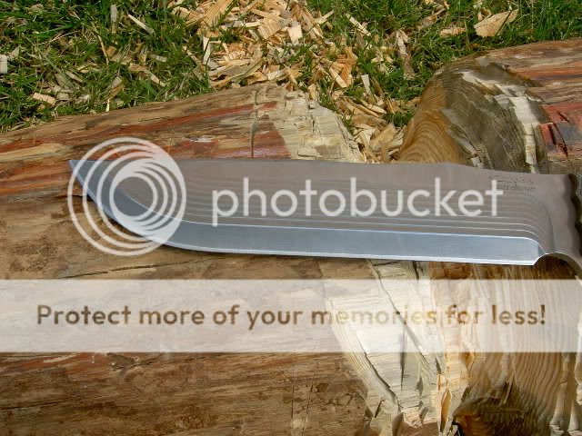

Up close of the blade:
After the handle mod:
Other side:
Closer:
Up close:
And the old way they looked up close for comparison:
It feels 1000x better. I couldn't be happier.

Yeah, I just focused on the CNC texturing on the slabs and sanded it all away, being careful not to alter the actual shape of the handle. It's still very contoured, and doesn't feel any thinner than it did before I smoothed the scales.
The grip is much, much more comfortable and isn't any less secure than it was before. Even with the aggressive pattern on the handles, my hands would slide all around during heavy chopping and the texture would just tear my hands up. It's much nicer in use now. I can even hold onto it better because of the lack of irritation during use.
If anybody has a G-10 model that is giving you problems, I really recommend this treatment.

Here's a shot of the spine, showing that the shape of the handles is still intact:
