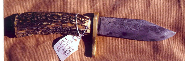

i don't know if it qualifies as damascus, but I do know that the end result is very nice to the eye. I've seen several examples where people have used old bicycle chain or chainsaw blades in the manor you want.
Not my work. Just borrowed the pics.
