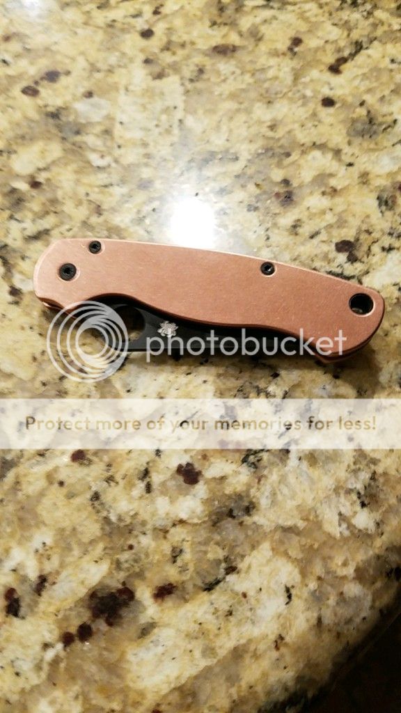

Anyone know what torx bit they use? And I had a pair of flex cuffs somewhere, but I can't find them. Will the regular zip ties work? I've got a set of copper scales from Flytanium arriving tomorrow and I am extremely excited.

Again you guys are awesome! Zipped some additional zip ties onto the one between the scales and liner and then tossed it in the freezer.. about 20 seconds of working it and they popped off... reassembly was... tedious... took me about 2 hours to get it out together perfectly, but it was so worth it... free dropping and everything is aligned and centered... I love it
