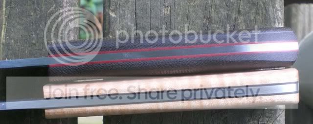

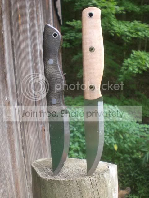

I actually ordered this knife a year ago as a prize for a forum I was on. However when I left I couldn't get the owner to continue the contest so I figured I'd just keep it when it came in a year later.
Anyway I had ordered light curly maple. I tried to get him to contour the handle, even to just make it egg shaped (ie wider across the spine than where your fingers curl around) but the only thing I could get was just for the scales to be made fatter than the stock model.
However when it came while the knife had a demon blade, and was a great size and shape The maple had almost no figure in it and also the scales were thinner than my other Charlie May, my Swamp oak, which is one of my favorites.:thumbup:
You can see here not much figure.

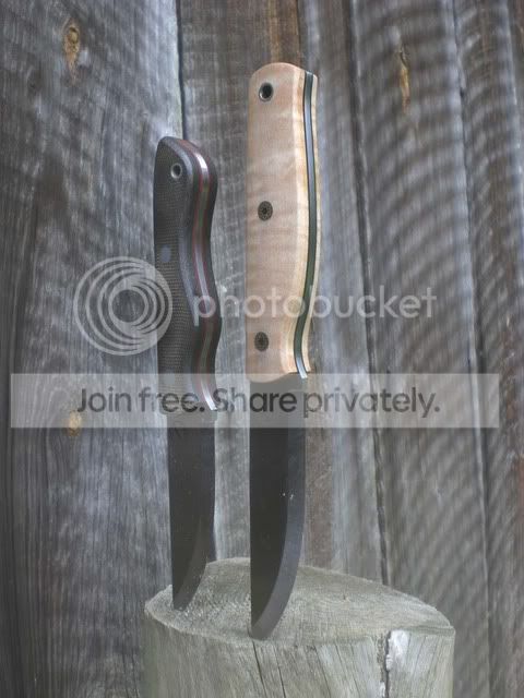

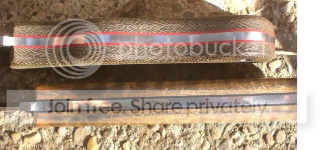

Here's a shot showing the thinner scales compared to the Swamp Oak

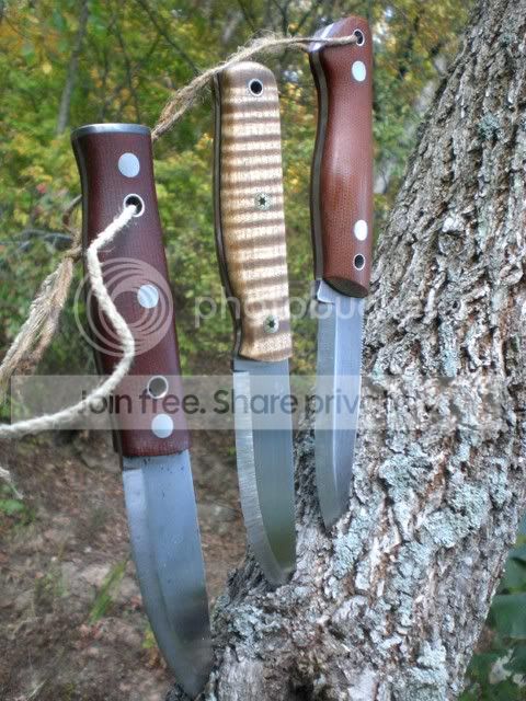

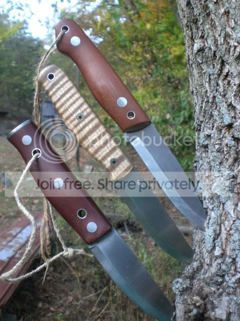

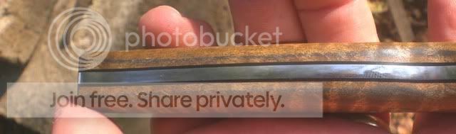

I got it back today. This is MUCH better!

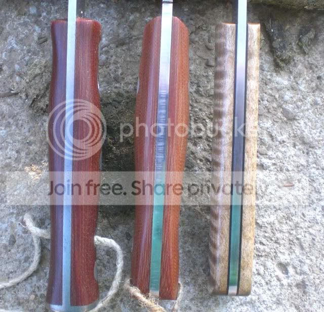

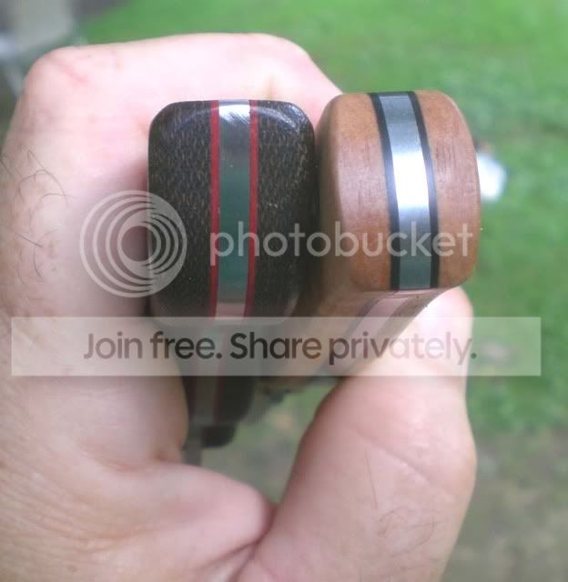

Not sure if the pics show it cause it's evening and there's shadows but the scales are about the size of the Swamp Oak now.

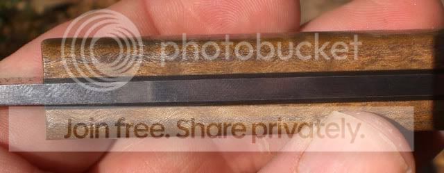

My only criticisim and you can see it in the previous picture too is apparently rather than sanding and steel wooling the maple handle looks like it was buffed smooth on a dirty buffing wheel. Can you see the dark stripes on the spine and belly of the handle?

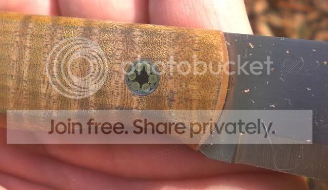

Also I guess where it was belt sanded then buffed that way it forced the dark metal filings and buffing compound into the wood grain. Not sure if you can see the dark specs around the mosaic pin in this pic.
So this evening I spent a little time sanding the whole handle lightly with 600 grit woodworking sandpaper and then polishing it out with ultrafine steel wool. This removed all the dirt off the handle. It's got a coat of Minwax on it now that really brings the 3d out and I'll steel wool that down and re coat it till it's nice.

Yeah I tried and tried to get him to contour them for me. I mean I don't think with the shape of the handles they don't need a palm swell or anything but a slight rounding of the scales and wider across the back than around the fingers would be nice.
I think where he get so many orders and is so booked up he has to make the handles the quickest way without a lot of hand work and that's why he won't contour them. Luckily with the handle shape just the fat scales seem to make them comfortable.
