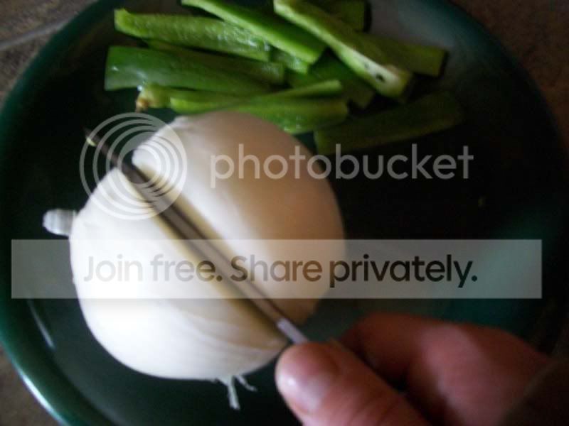

"Smooth", I muttered as the scandi edge sliced through the white onion almost effortlessly. Smooth is a term I would use to describe the entire knife that Mark Wohlwend, maker of Charlie Ridge Knives, sent me. Perfectly ballanced, light and quick in the hand, and one of the sharpest knives I have ever recieved from any maker. A Scandi bushcrafter has been a labor of love, and a long time in the maikng for Mark, and he got it right.

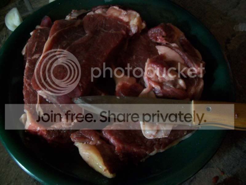

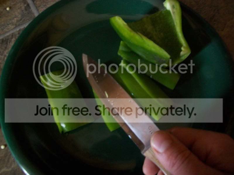

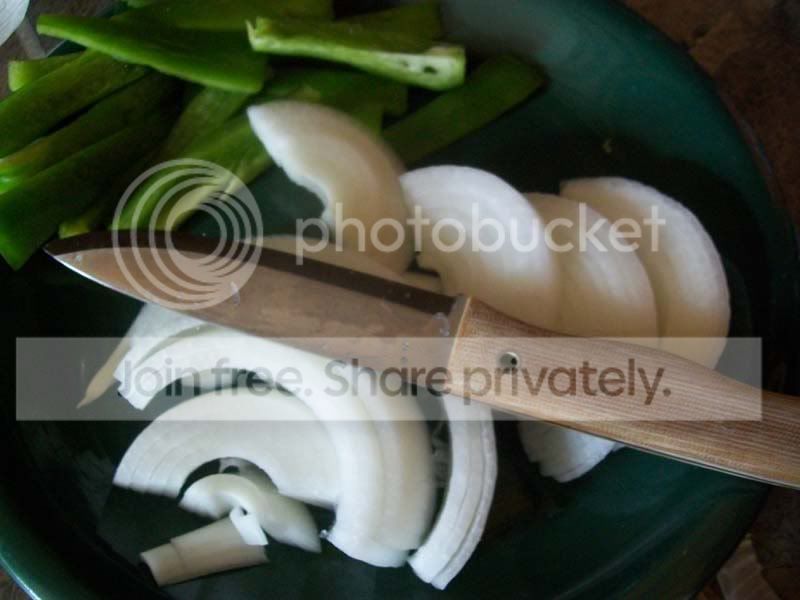

I figured what better way then to get a feel for theknife in the kitchen. I put it through its paces slicing onion, mushrooms, and peppers for Fajitas. It sliced very well for a blade pattern that is not really meant for kitchen duty. I sliced up 3 Ribeye steaks as well, and had no issues with this. It cut through the meat with the precision or a scalpel. I wanted to see how far I could push it before it required a touch up on the edge. After kitchen duty, it still was able to shave hair off my arm with little effort.
Pics of the Kitchen trials.......

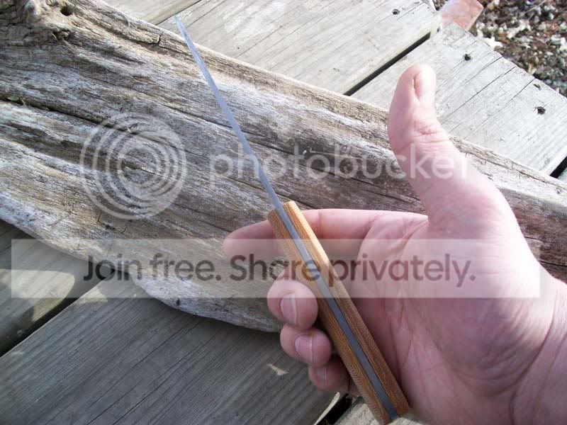

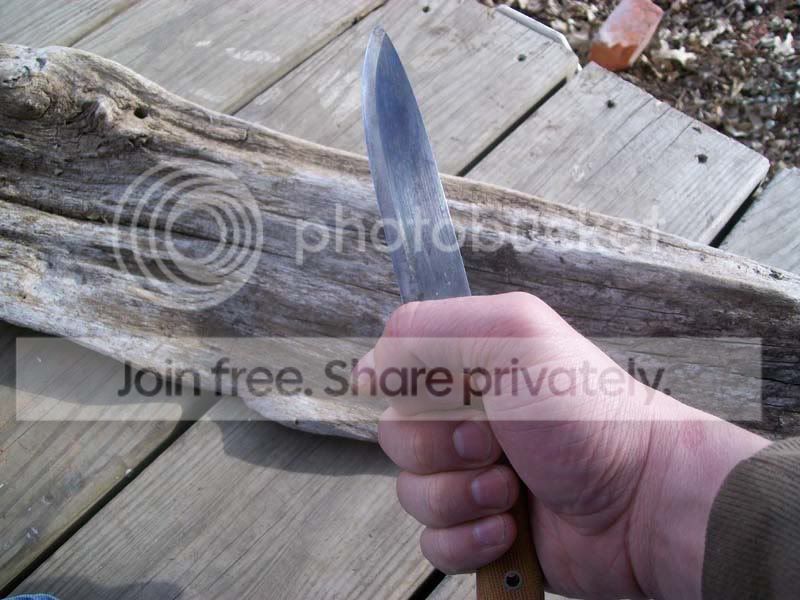

I sat down in my favorite outdoor chair on my deck, smoking my pipe, and just examining the knife. I noticed it has picked up the start of a very nice patina. I just love the pin combination in the scales. I looked at the tip of the blade, and thought to myself, that it looks very pointy, and wondered how strong it was. Mark has his way wth a heat treat, so I doubted with any type of regular use it would be an issue. Te knife fits my hand very well, and the blade length is spot on for what I usually look for in a knife. I do think that thi knife would benefit from thicker scales, as I like em a little more "filling". That is something easily accomplished though, as Mark is a pleasure to deal with and has a whole variety of handle materials and thickness to suit the customer, including Stag. Man, Stag would look cool on a bushcrafter.
I retrieved some wood to perform your average tests that we see so often in knife reviews.
Fits the hand well. I have avg size paws. Kinda skinny with long fingers. Piano playing hands as my grandmother used to say. I wish we could figure out a standardized way to list hand size here, since a hand is so differant from one knut to the next.
Design could benifit from thicker scales, and maybe some contouring, however it was not a need for me, as much as a desire.
Fuzz sticks were a breeze. I reall enjoy "fuzzing out" with a scandi. The bevel really puts the edge at the perfect angle to create wonderfull, easy to accomplish curls.

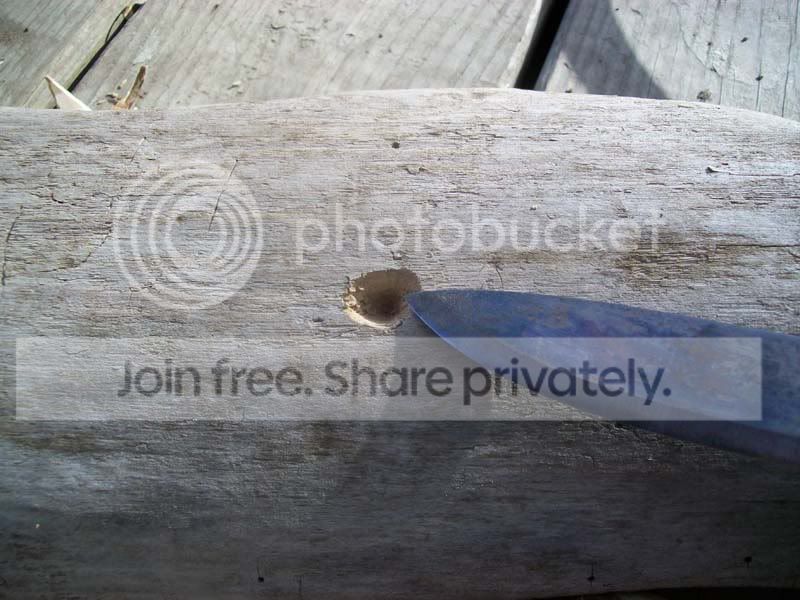

Used the tip to drill a bit into some wood. Very easy. Tip strength is very good. Stronger then it appears.

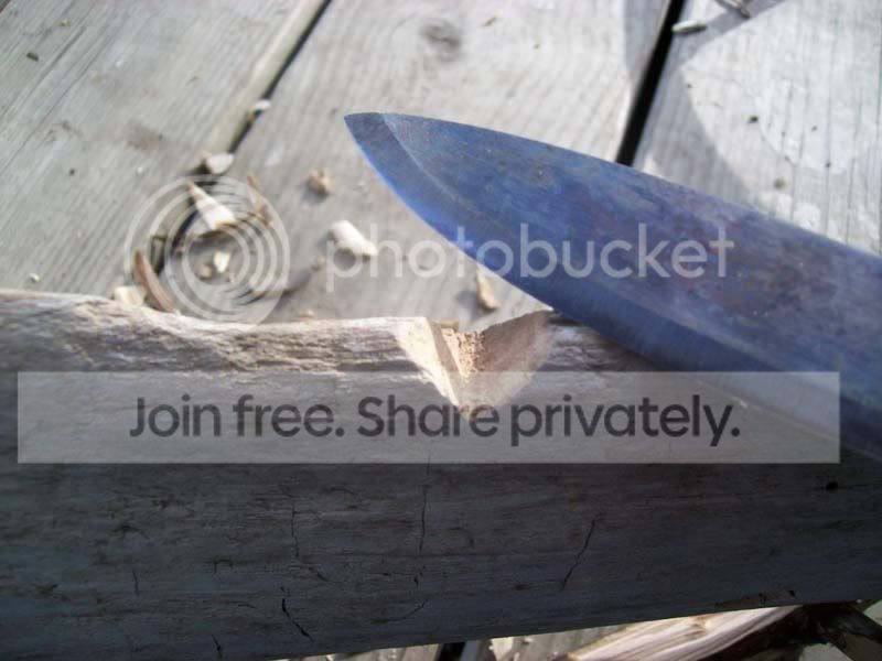

Notching was easy too. Sunk right in with little difficulty.
I am really impressed with the workmenship of this knife, and the ease of a Scandi when it comes to woods chores. This design really lends itself to bushcrafting tasks.
