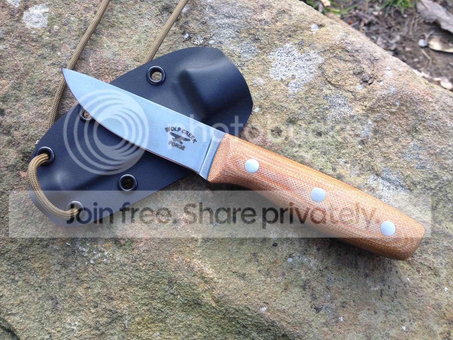

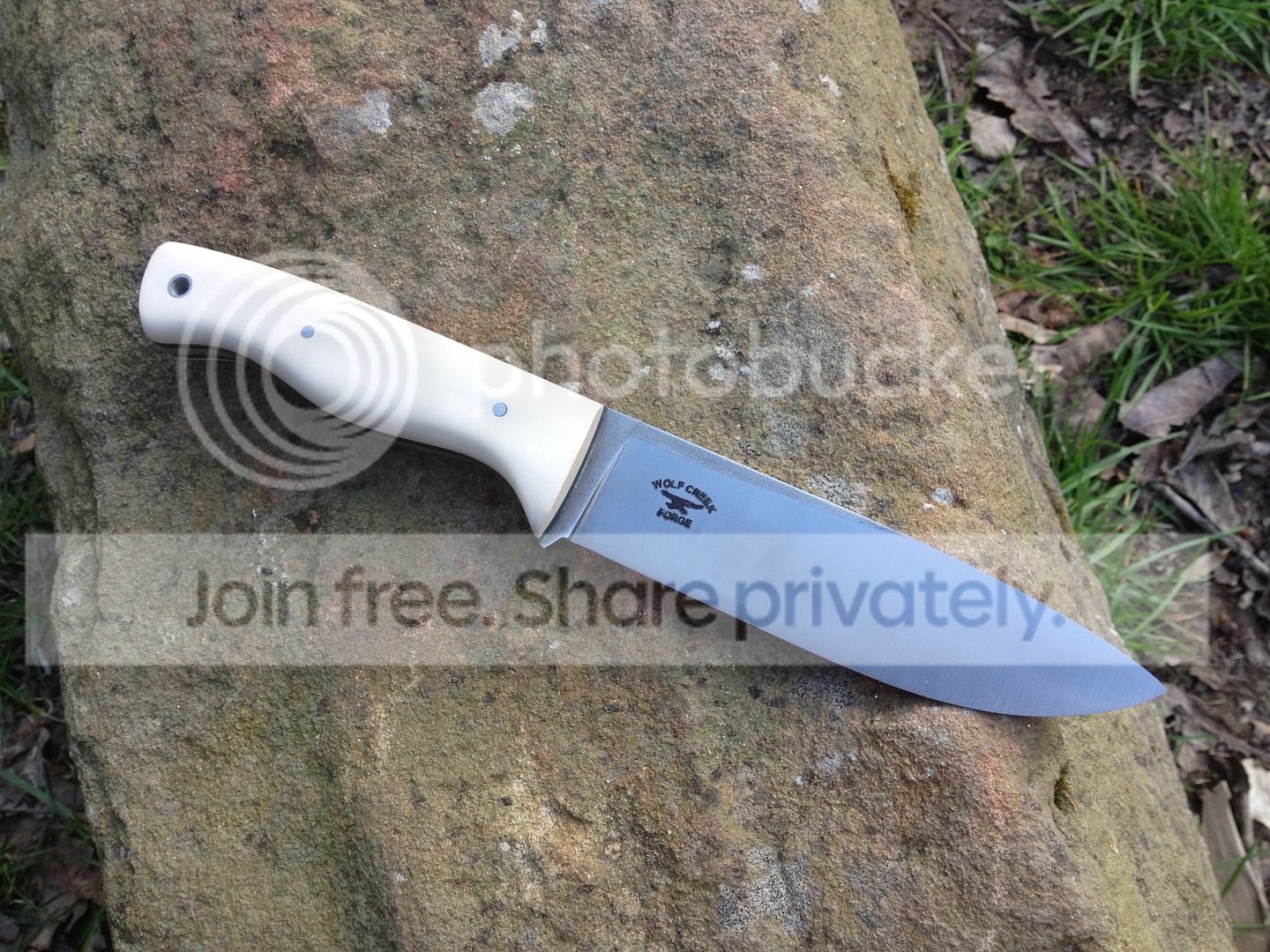

Alright, I need a clear head on this one..We have a monode 45 etching machine. Its a good quality machine and in the past has always worked perfectly. I use img stencils and #94 electrolyte..I do have a homemade handmarker..I use cotton pads on the homemade marker..My electrolyte is old and down to the last few drops so I need to order more..
The last several knives Ive etched, Lisa has had to grind away the etch to redo..It is not coming our right now for some reason. Its not nearly as deep as it was is mostly the problem. It seems to be gunking up the stencil worse than before..
possibly the hot or ground cable needs replaced? not good contact? It seems like its not getting the volts to the steel..Before if I put the etcher on the highest setting (C) it would make smoke come off the etch and make a mark so deep it looked like a stamp..
Im sure its something Im doing wrong but Im too dumb today to figure it out..Any ideas?
Heres a pic of a knife with the etch like it normally was..Very deep and dark..
