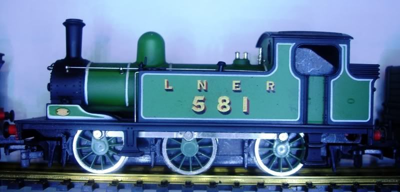

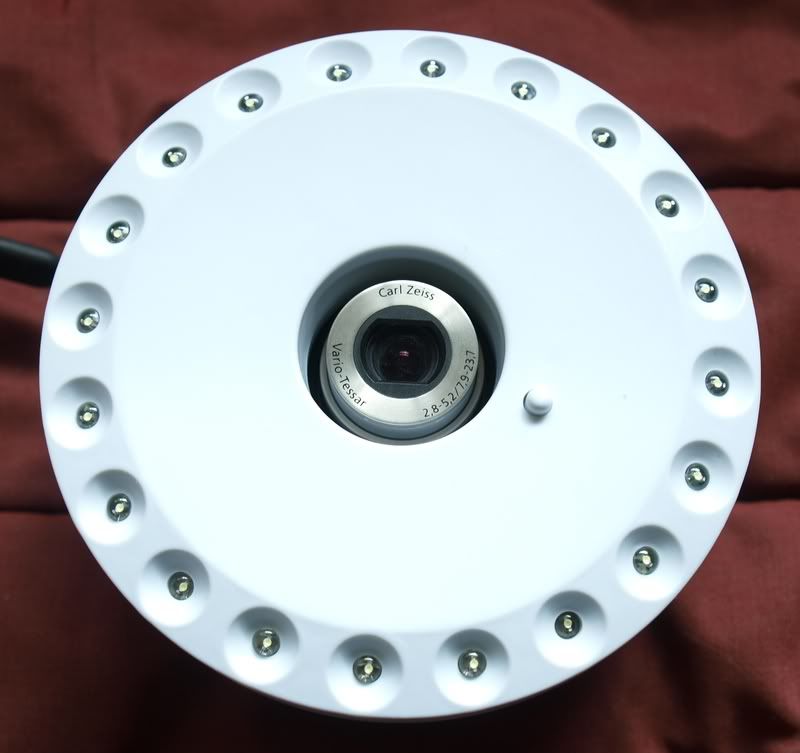

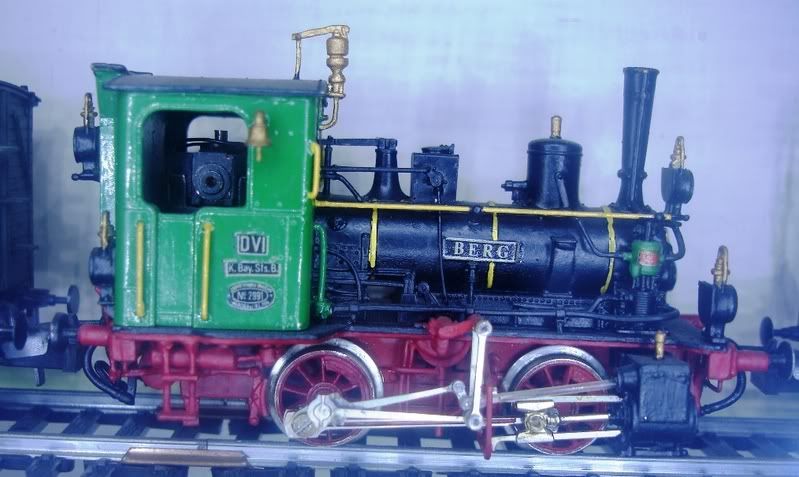

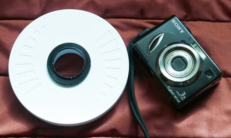

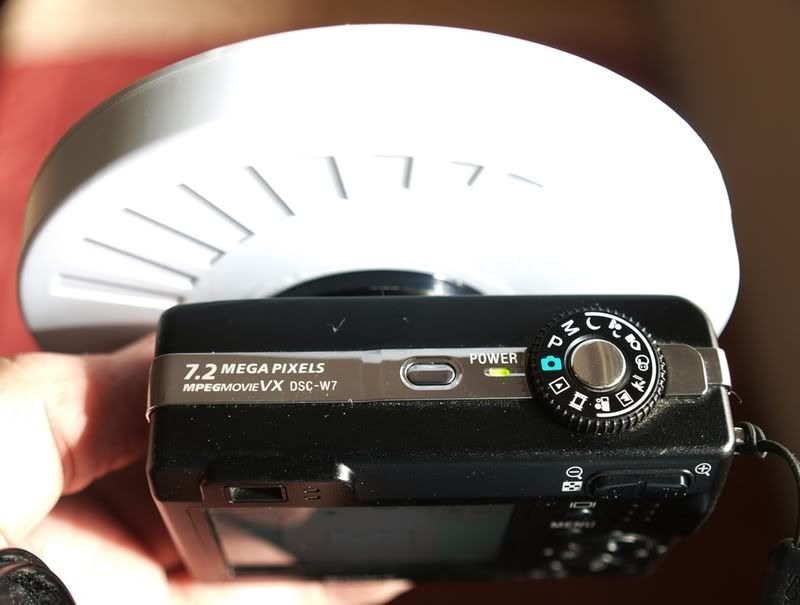

Here pictures of the 20 LED ringlight with a screw mount for my small Sony W7 with which the loco and safety razor were taken!!Not bad for such simple gear!!
I hope it will give some ideas to someone!!

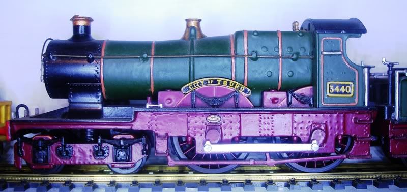

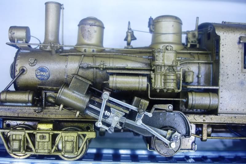

Here some more pictures with the small Sony W7,and 20 LED ring light!!
Detail cropped from above picture to see the details!!

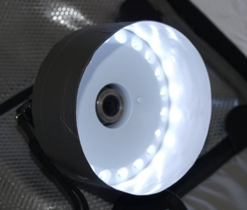

I added a refinement to keep stray light in on the ringlight,and with step rings I can use the small W7 Sony also on the 84 LEDs light!!
Regards:
Albert

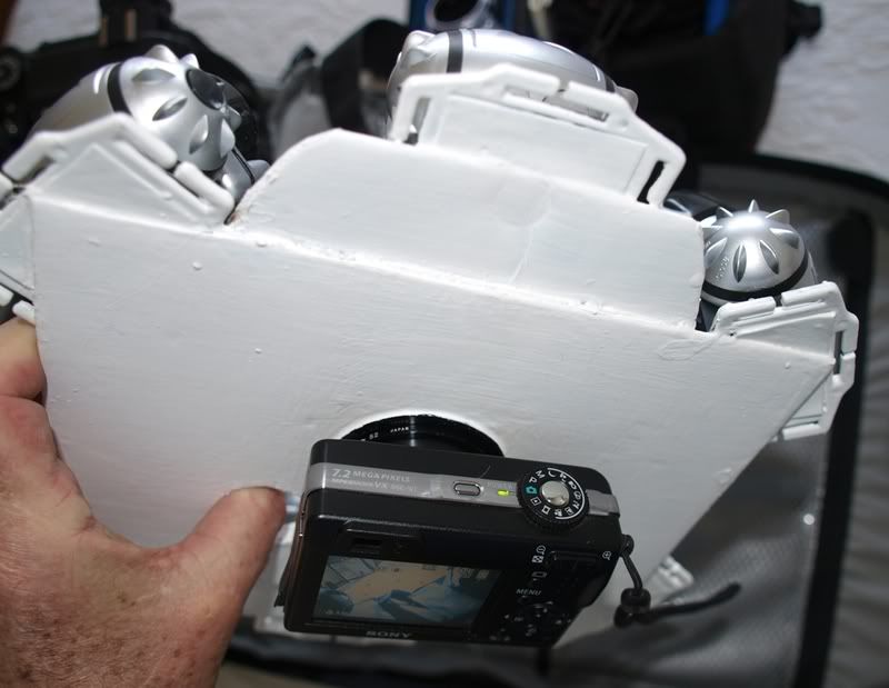

Here is my CHEAP macro lighting
You should feel the heat the ORIGINAL lamps put off :eek:
That flash ring thing you built sure is UGLY
But
It works great!!:thumbup:
A lot cheaper than the retail ones
Thanks for posting your project

That rig you have must work much cooler with those new lamps!!And my rig sure IS ugly!!But it works ok!!Even away from mains!!
Have fun as I do!!
Albert

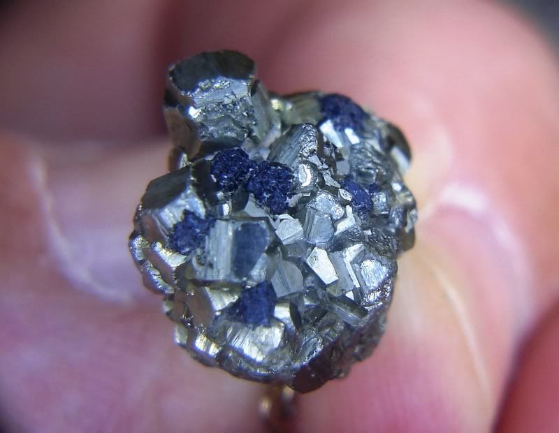

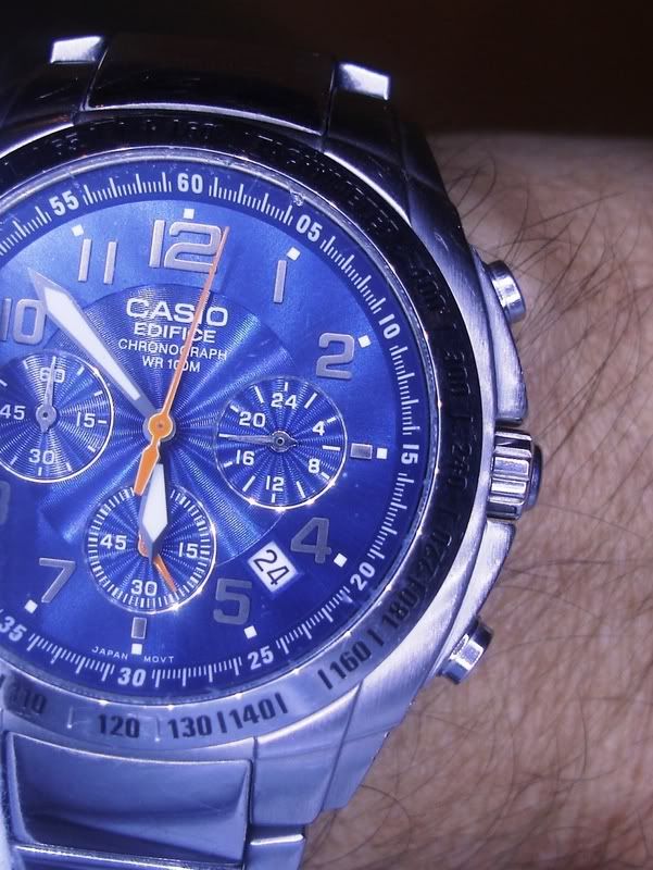

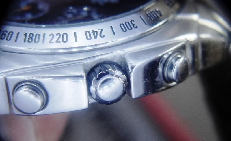

These two are with the ring of 20 LEDs and the W7 Sony:A pyrite cristal made into a necklace hanger,and a closeup of a watch!!
