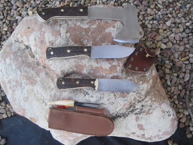

What do you think of my Trio of sharp stuff for my woods roaming?
I know that Nessmuk liked his little axe, and his fixed blade knife and his 2 bladed pocket knife. I could live with that but give me 2 fixed blades and a little axe and I am even happier lol. I know most if not all of you know about the rule of 3s. 3 cutting tools are like having really 2 cutting tools and having 2 cutting tool is like having really having 1 cutting tool lol. having a few sharp cutting tools is really a great way to roam in the woods.

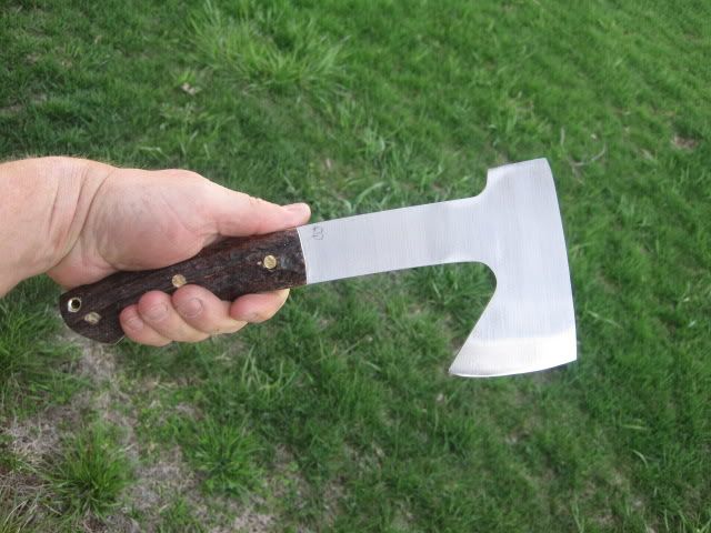

I just finished up the hatchet this evening. It is made out of 5/32" thick
0-1 steel and has elk antler for the handles it is about 10" long. Here is a in hand shot. of it.

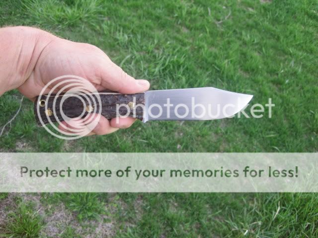

The middle knife is a version of the knife that old time Camper, E. Kreps liked and used for his woods roaming. Kreps liked a clip point on a 4.5" long knife. He liked a little thicker blade though 5/32" thickness. I made this one out of 1/8" thick 0-1 steel. the handle is flared at the end some.
Kreps says in his book on camping skills. That he liked to have a fixed blade that fit into a deep pouch so that only the little bit of the handle showed. He liked the flared end because it was so much easyer to grab with 2 fingers and pull out even if he had gloves on.
Kreps writes that when on the Trap line while checking and setting or resetting traps it is so much easyer to have and use a fixed blade. Kreps really liked to be able to keep his gloves on when he needed to use his knife for a cutting chore. Instead of having to pull off his glove to reach into his pocket and get his pocket knife out and then open the blade do his cutting and then fold his knife back up to put in his pocket and then have to put his glove back on. Any of you who have ever trapped in cold weather know taking your gloves on in winter even for a short time sucks lol.
Here is a in hand pic of my Kreps pattern knife.
And finally my version of Horace Kepharts knife ( seen here with a couple of monster suzz sticks I made for fun)
that I made up a few weeks back. the Kephart knife I will wear on my Belt. The Kreps knife I will put on my pack strap and then the hatchet i will carry inbetween my belt and pants on my left side. I have carried some of my other hatchets that way and just love it. It works for me.

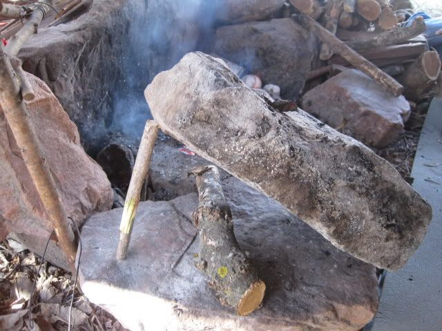

I wanted to work on some 2 stick dead fall traps that i seen on another forum. here is the 2 dead falls that I made up using that 2 stick set up. It really is a quick freaking dead fall once you get the 2 sticks carved up right.
A log dead fall set up.
And then a rock dead fall set up.

Very nice set of tools. You are a very talented man. I really take interest in all your posts. Looks like a great time. Be safe.
I really like the look of this one Bryan, I bet the handle feels great with having the flared butt eh !:thumbup:
I always love seeing and reading your posts, I only wish I was close enough to join ya for one of your breakfasts !!!!!:(
I know very little about traps, but with a setup like that isn't there a much better chance of the critter not triggering it vs. a figure 4?

Awesome trio Bryan, and I know there are actually four because I'm sure there is a little bitty one there somewhere lol. That Elk handle looks great, and that Clip point is sweet!! Now I'm wanting some darn bacon and eggs...thanks a lot!
i really like the fact that you chose relatively thin stock on the blades, brother.

LOVE the Kephart Bryan - love it.
Off topic - where is the trigger on your deadfall?

damn it i can never go more than a day or two with out your torturing me. that is a great all around set up. i truly believe you can cover pretty much any thing with that set up. very well put together sir
now sell me the kephart lol i love that thing. sorry for hijacking all your threads but its something i am just going to have to keep doing until you either sell me that bad boy or make one for me lol
again no bs that is a great set up you got there sir. keep up the great work

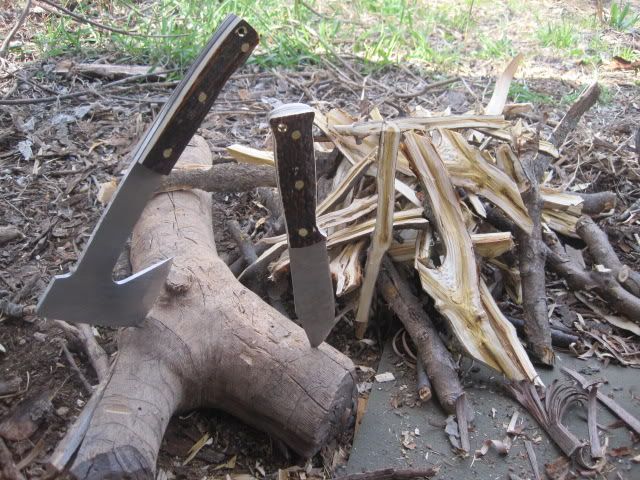

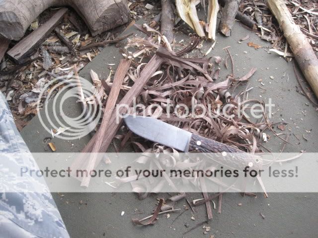

Pitdog, thanks, Yes that handle does feel very good to me. I really got to use it today. I made up a bunch of shavings and a few little fuzz sticks.

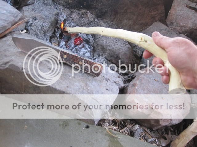

It also helped with carving up a new fire poker stick.
My other just got burned down to short lol.

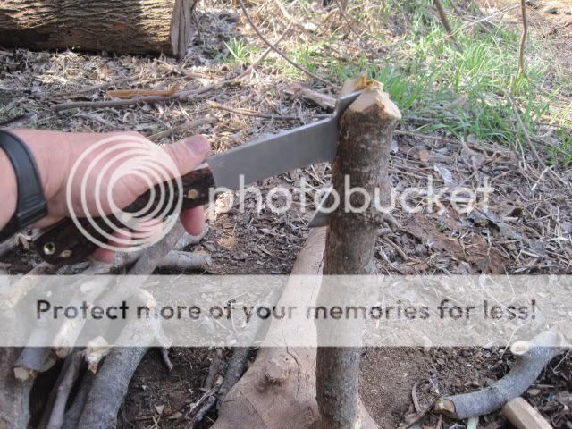

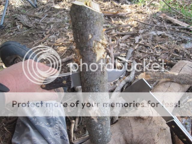

I did do some battoning and then some spliting with it too.

Remmmm, I tell ya if you get a chance to work with this trap set up do so. it is very fast.

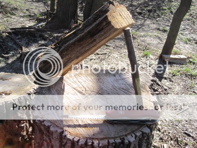

VA27, thanks i really like that little axe to. today it helped me spilt some wood.
It also helped me start this.
