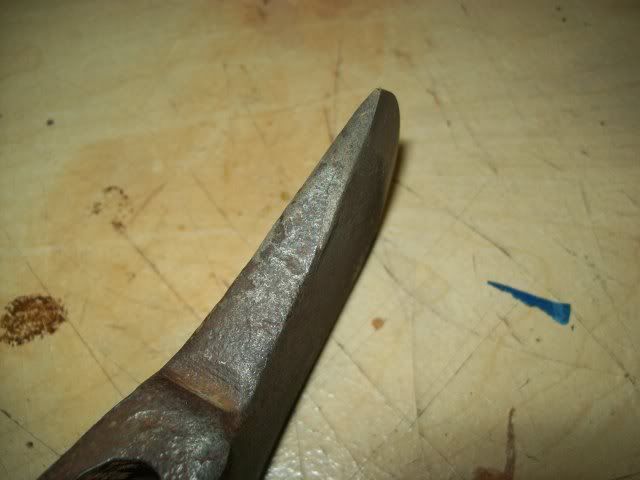

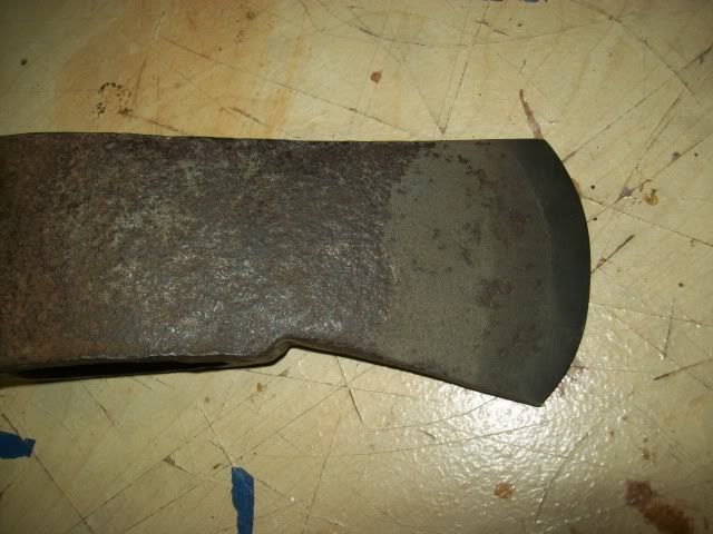

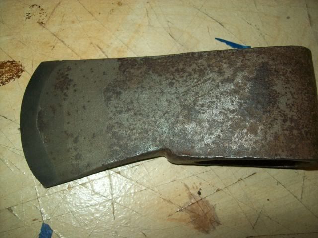

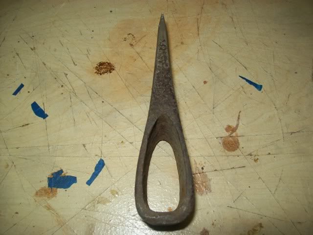

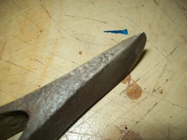

I bought this old axe head for $5 the other day..I dont know why it just kinda called to me..After a vinegar clean up you can see that some blacksmith had either re-steeled this axe or added the cutting bit by overlapping the bit around the outside of the blade instead of between the checks which was a more common way(if you look close you can see the weld seams)..Ive seena couple like this in museum texts but never in person..Kinda cool, Im glad I spent that $5:D Oh and yes I had to grind on the bit a little:grumpy: It was nothced badly but I didnt have to grind much and i followed the original shape exactly..I may slap a handle in it and put it back to work :thumbup:

That bit looks sort of thick, on the heel, almost blunt or flat. Is that just the lighting in the pic, or?
