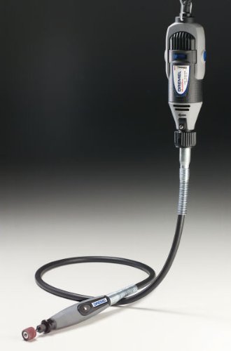

Touching on that point...
Dremel does have an accessory handpiece for finer control; it's called a 'Flex-Shaft'. It makes a big difference in how the tool can be handled and controlled, and will allow the cutting disks or whatever bits are used to be oriented more precisely to the workpiece, such as vertically orienting the cutting disks for jimping. Searching the web for 'Dremel handpiece', there seem to be other aftermarket options to fit the Dremel as well.
Here's a pic of Dremel's current version of the Flex-Shaft attached to the tool:
