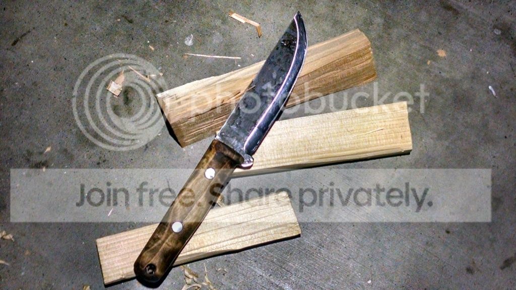

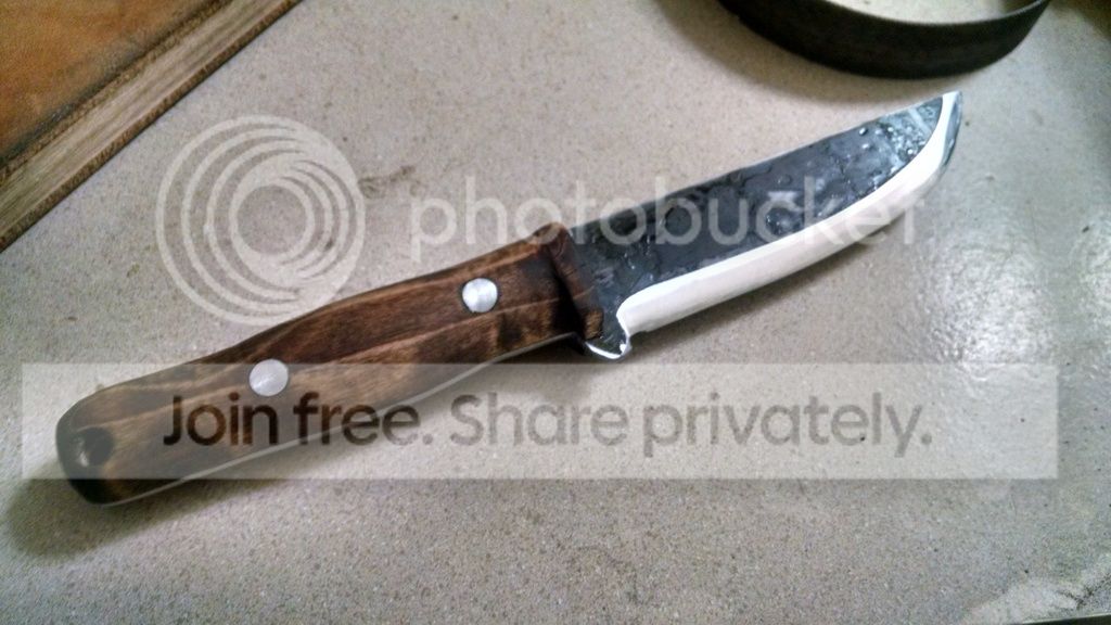

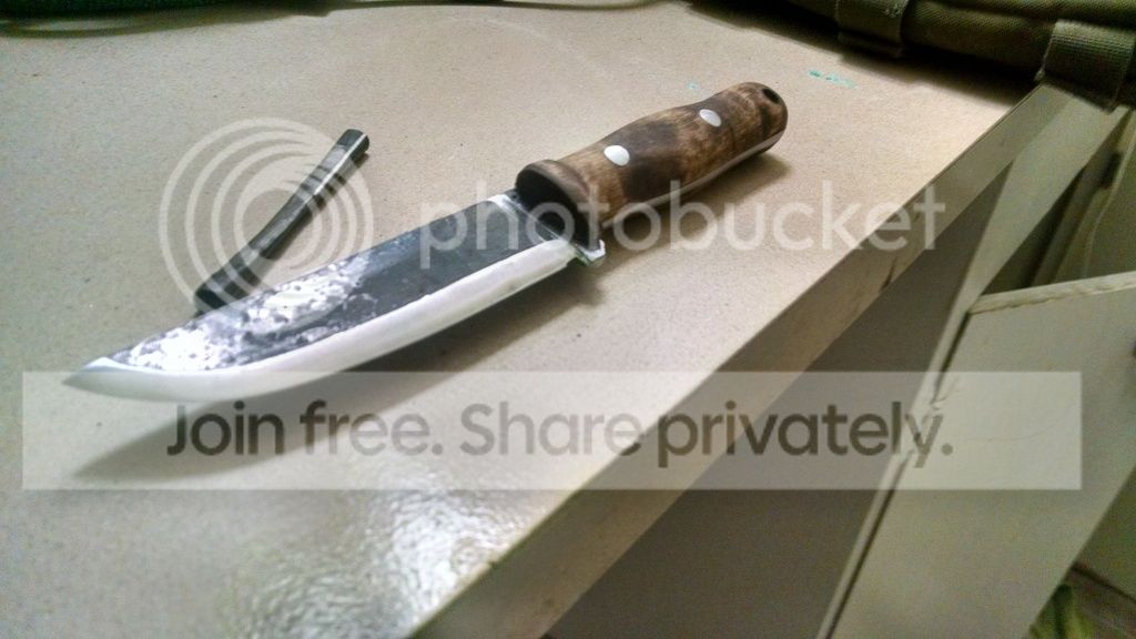

First off, thank you Stacy. That O1 recipe is awesome.

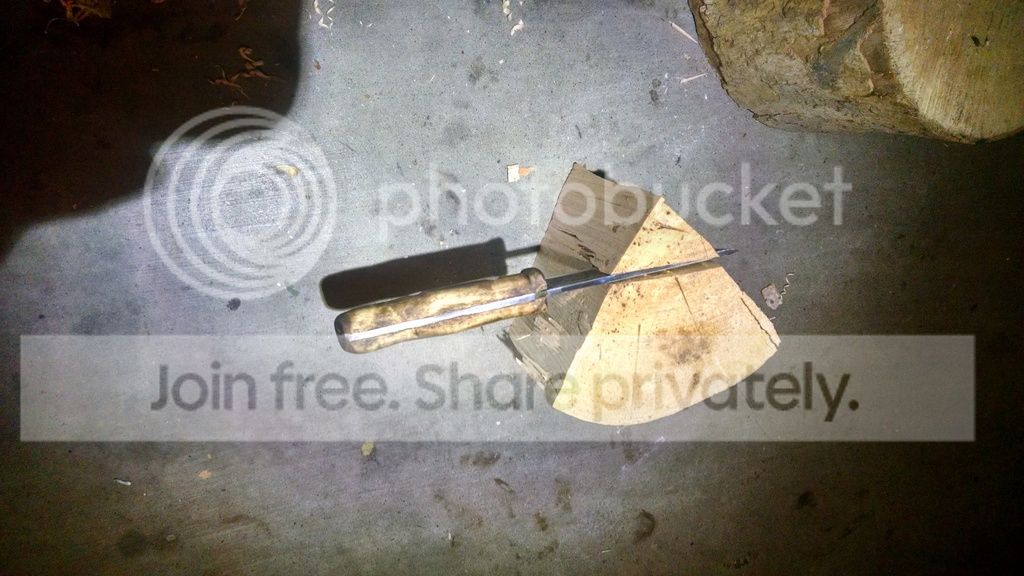

Here it is, O1 tool steel ~60hrc with a scandi-convex grind with a 18° micro bevel.
Full-tang with birch handles with walnut stain and lightly seal with boiled linseed oil.
The pins are aluminum and held with epoxy.
The spine has a 90° edge for a ferro.
8in overall 50/50 blade to handle ratio.

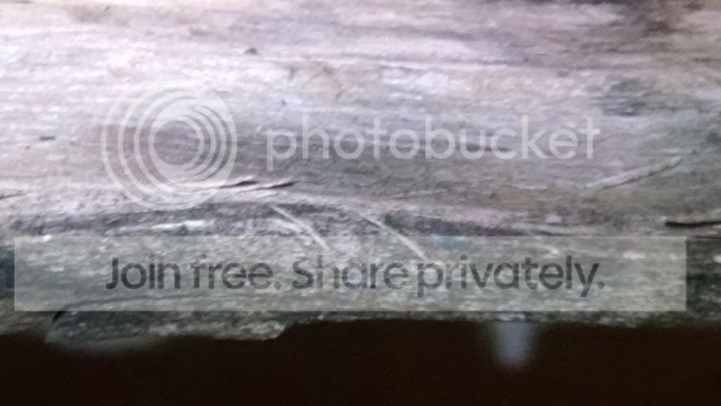

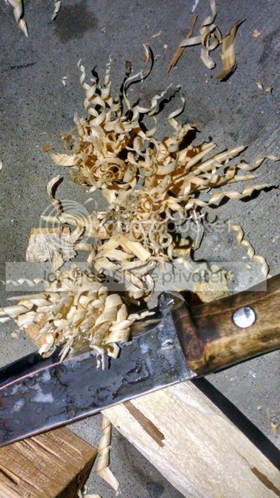

Some testing.

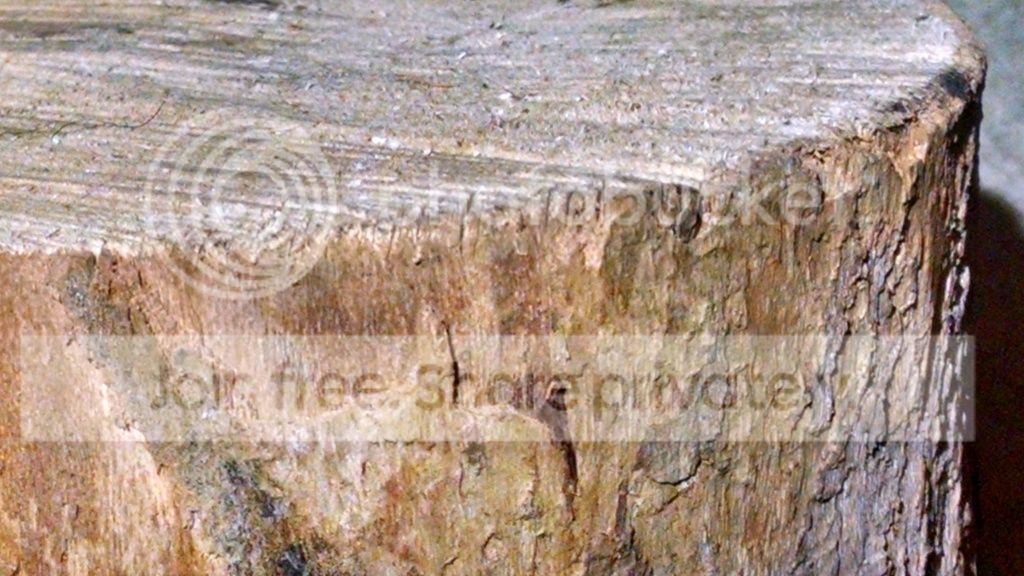

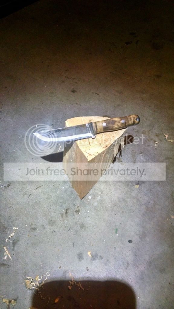

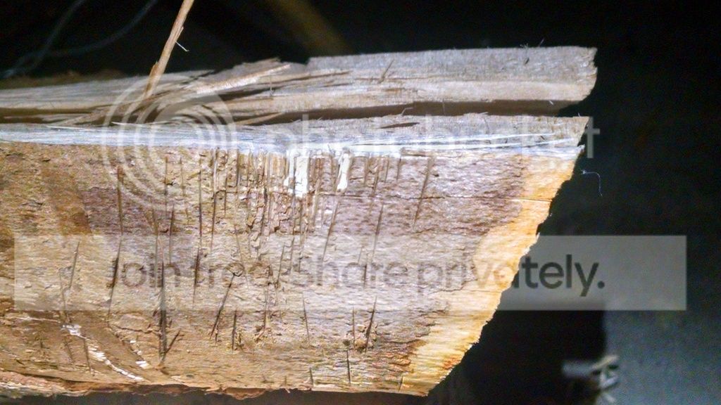

I then whacked the edge on some different woods full strength 25 times on a piece of birch and a very hard sycamore round.
Even a piece of water logged mystery wood that's super hard.

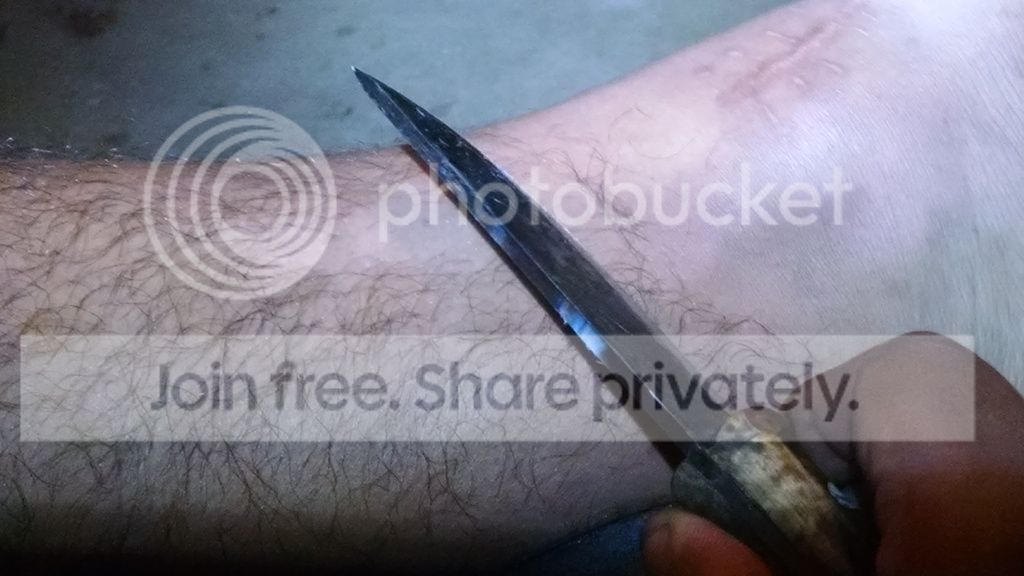

At the end, still razor sharp! Success!

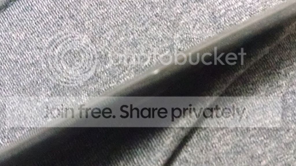

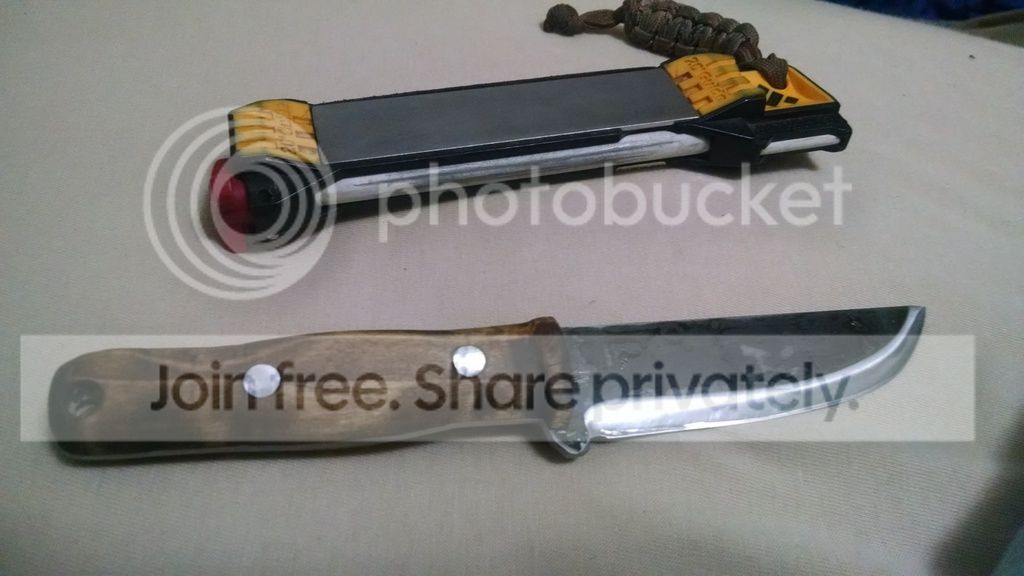

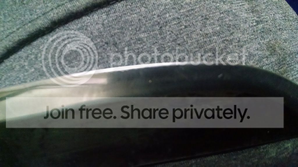

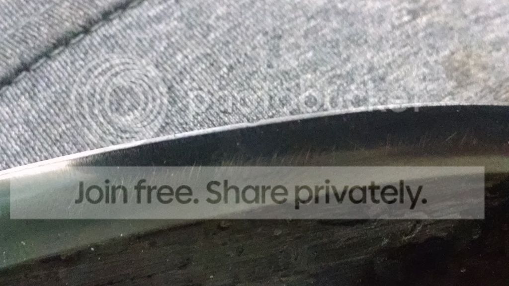

Up close damage. She took a roll

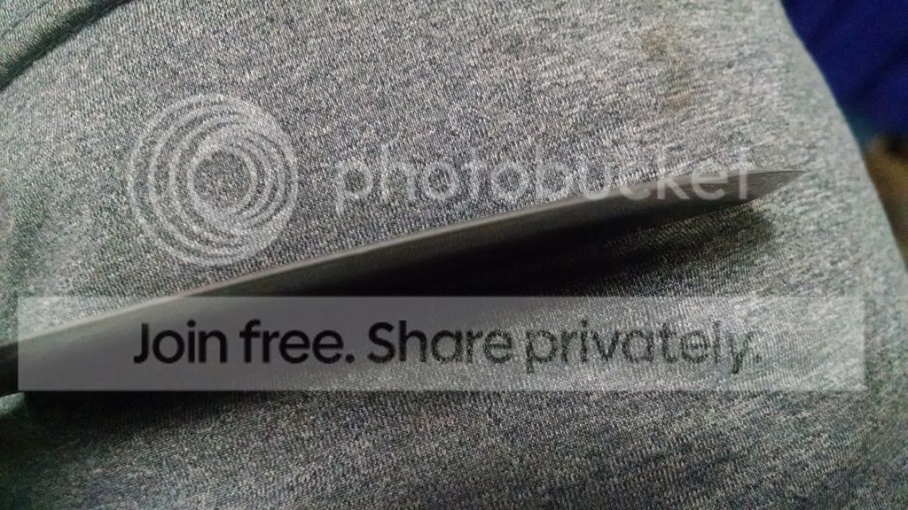

Time to see if she'll field repair
I used the fine diamond stone and stroped the roll back into piece with a few light swipes then I touched it up on the ceramic.
And the results. Perfect.

On the next one, try for a bit of handle shape and curve. Also see what you can draw without the nib of metal sticking out at the end of the edge. Look at some bowie and large camp knives for inspiration and ideas.

You mentioned that you did 1600°F for O1 tool steel. That's a very high austenitizing temperature. I do 1490°f with a 20 minute soak. After I posted, I noticed what you said above ^^^^, heated to nonmagnetic, held for one minute. Just FYI, non magnetic is about 1414, and we know we need to be around 1500. So if in that minute the blade did heat up some, you probably were very close to target temp. However, no soak was employed. So basically you have a 1084-like blade. Quenched at just above non magnetic with no soak, or quenched AT non magnetic with a 1 minute soak?
That's why we don't usually recommend O1 for that type of heat treat set up. O1, for O1 performance, gets a solid 20 minute soak at around 1500°f. But for your "bush" application, your heat treat should do well.
