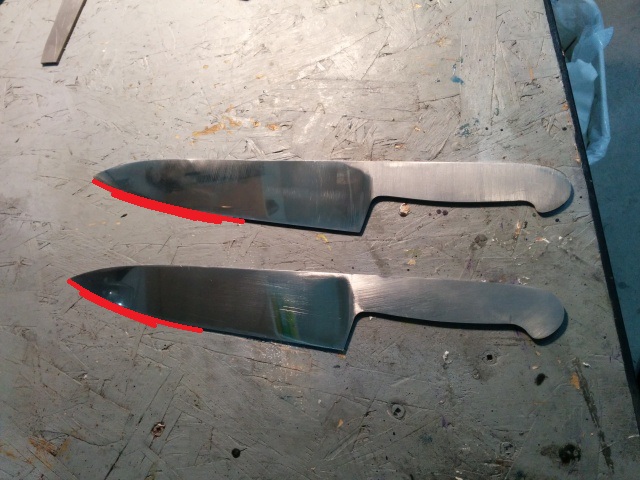

Here are 2 rough ground although not ready for HT. Don't mind the finish, I was trying to get a couple deeper scratches out on the disk without accidentally reducing the edge.
The one on the bottom feels more nimble in the hand. I'm thinking about reprofiling the top one to be similar.
Anyway, definitely more challenging working on these larger, flatter and thinner blades freehand on the 2x42.
Can't wait for my esteem grinder I ordered to come in! I'll wait for it to do the post HT grinding.
Haha, what's up with the broken blade in the top picture?
Here's my take on a smoother profile. The belly you have in the top one is very sharp and dramatic; something brought further towards the heel and more gradual looks and feels nicer.

I break a production knife as sacrifice to the knife gods. :)
It's a broken kitchen knife my wife asked if I could "fix"... I think it's beyond help.

Anyone have an opinion on the spine on the top or bottom one better than the other?
I think less metal on the bottom one makes it feel more nimble.
