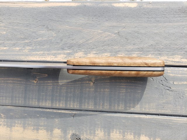

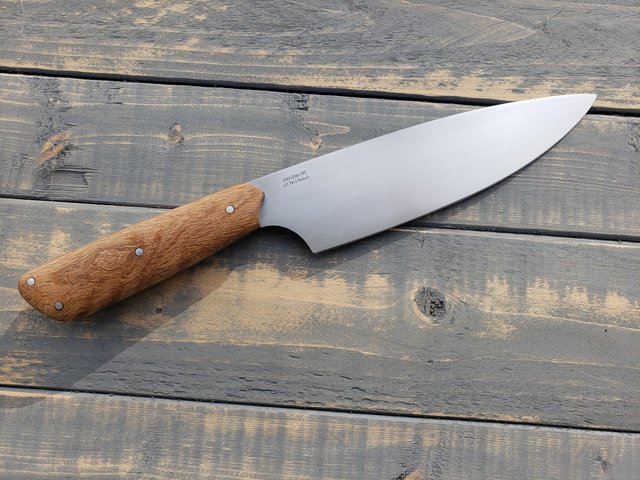

Forged from 1084, this chef knife (gyuto) is 11 1/8" (283mm) overall with a 6 1/4" (160mm) cutting edge, and 1/8" (3mm) at the spine. It features a convex grind, and has a hand rubbed scotchbrite finish. The handle is stabilized curly oak with black G10 liners and stainless steel pins.
This one is already off to it's new home, but I thought you all might like to see it. As always, questions and comments are welcome. Thanks for looking.
Travis
looks nice and clean. :thumbsup:
Thanks. I don't normally make knives this big, but this one was fun. The new owner is the guy I purchased the wood from. It was cool to be able to use locally sourced materials.
