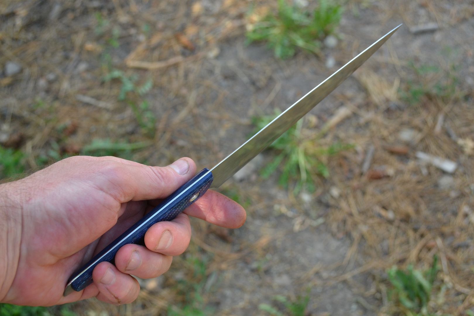

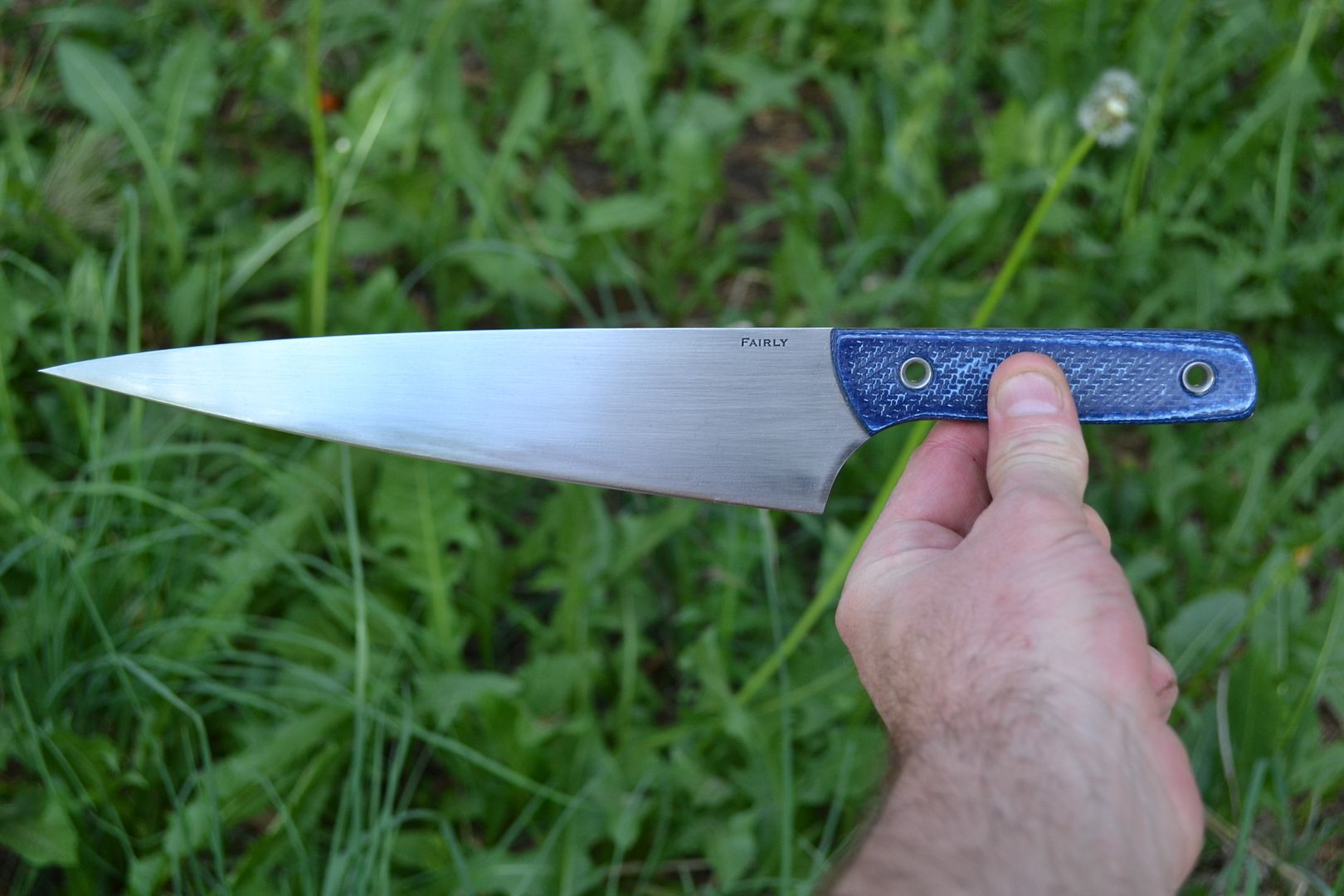

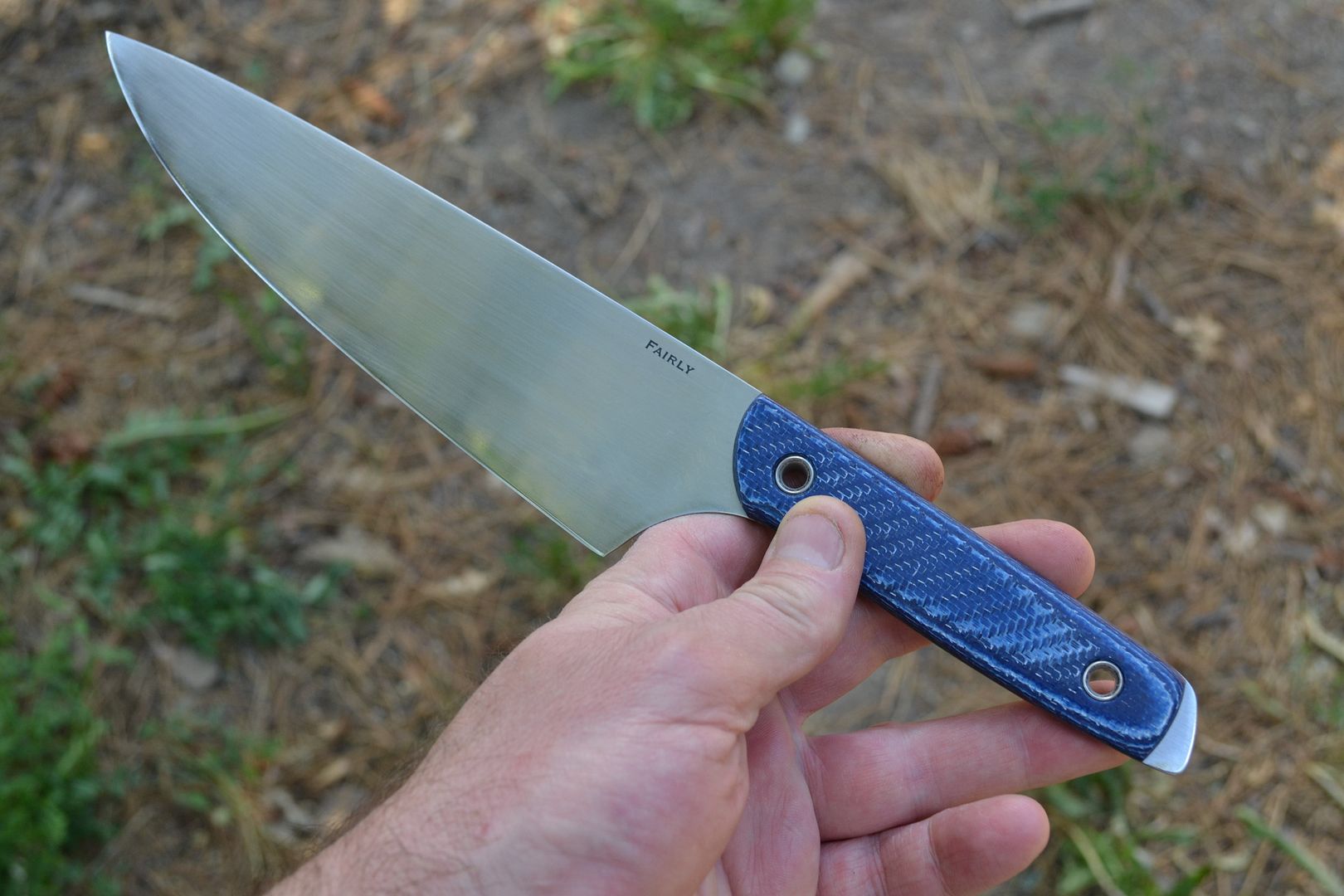

Enjoy the pics!
Both are spoken for...
.045" 15n20 Steel and Blue Twill
Close Up!
.060" O1 Steel at 62 RC!
You can see that there is some belly to the blade...

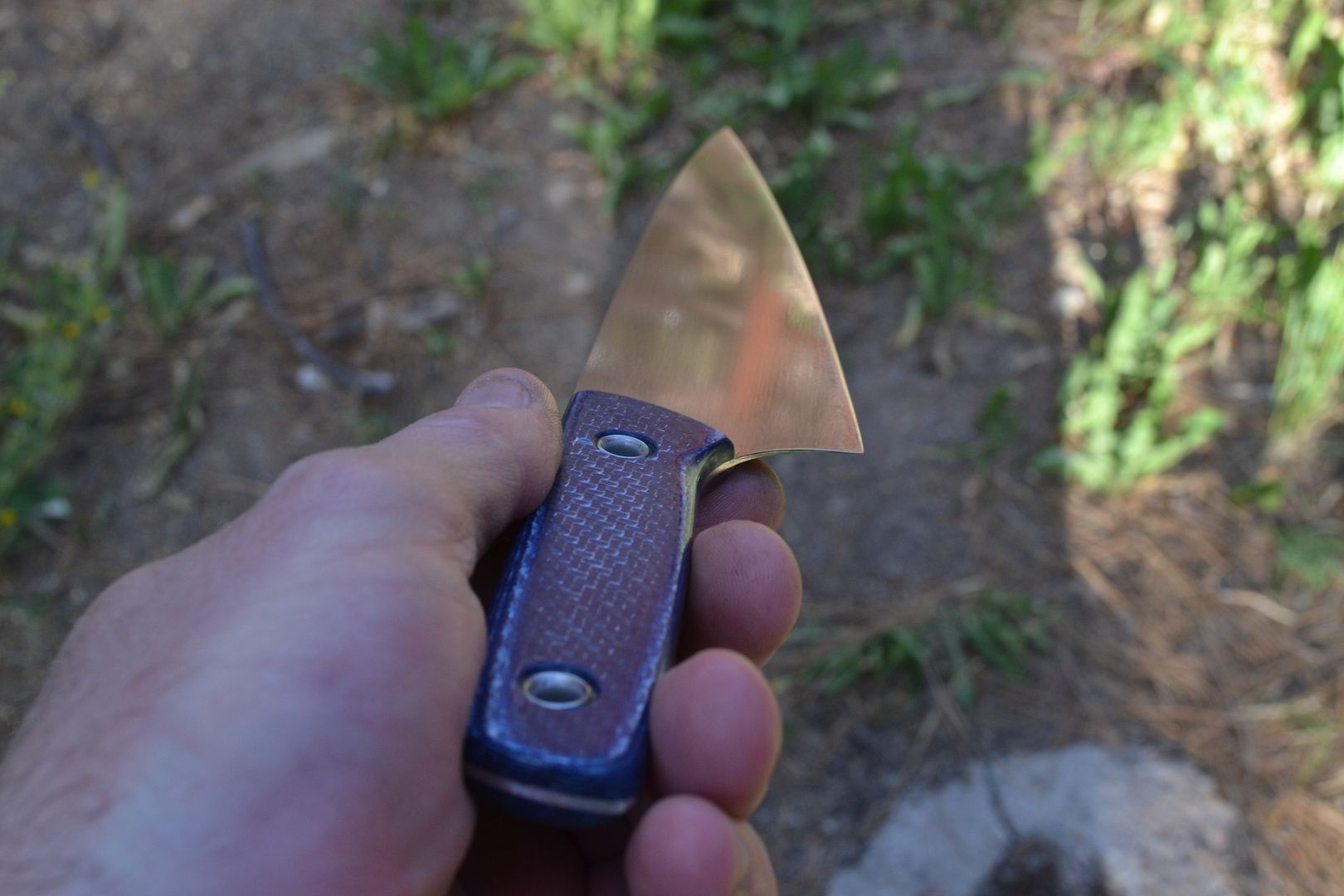

Hey Daniel, nice work(Again!) Is the knife in the top pic different from the rest? Tip of that blade and shape look slightly less "pointy" than the pix below that. Just curious.....
Thanks! Yes the top two are a a different knife than the latter pics. I plan on more in the style.

What are the specs of the first one? And what is the price... :D
It is already spoken for, my next ones will be in the $250-325 range depending on finish, materials etc. I'll be making more in this same general style but with .093" 52100. Everything on them will be done to a high level of finish.

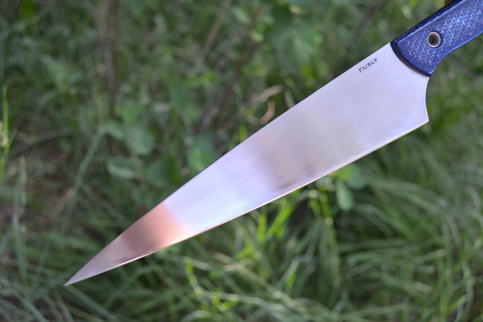

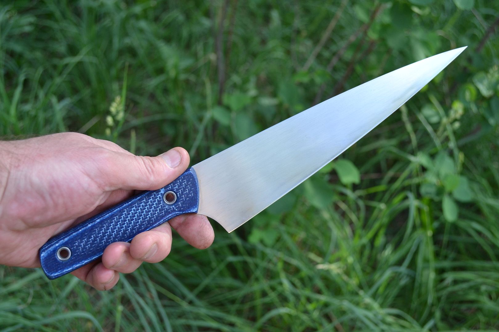

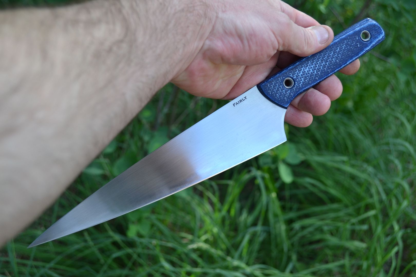

12" long, 2" tall, .045" at the spine near handle, full distal taper, full flat double plungeless grind
