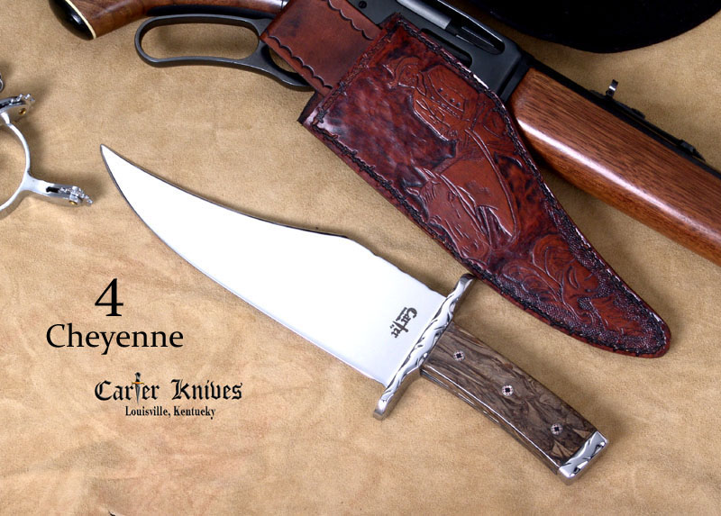

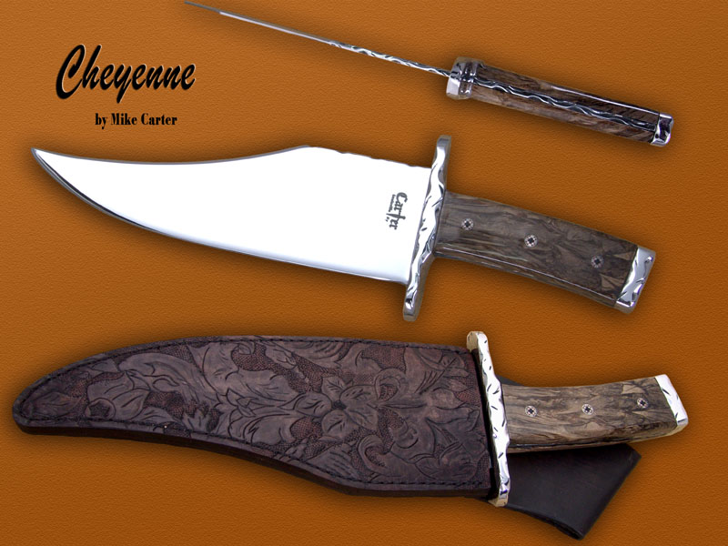

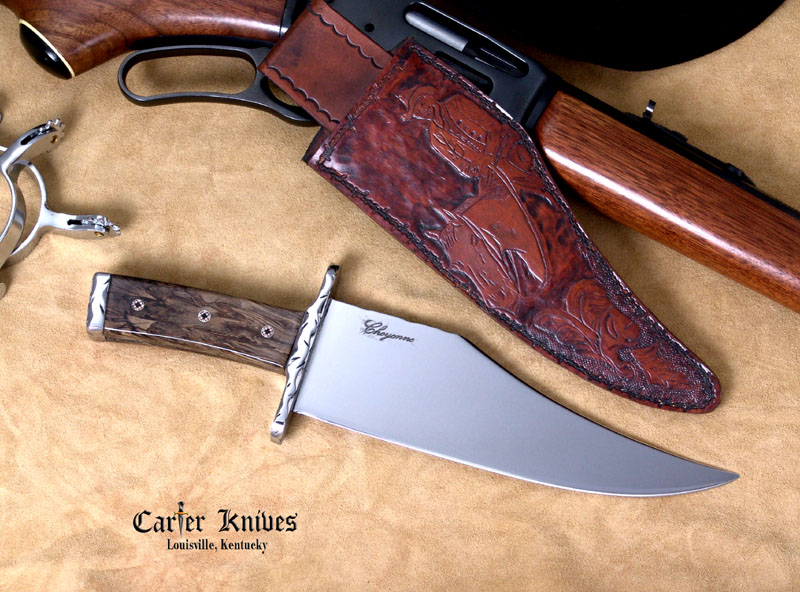

This was another custom project for a great customer who has ordered several knives from me. He wanted a special bowie as tribute to his friend Clint Walker of the old "Cheyenne" TV series.
This bowie was made from 1/8" 440C stainless steel. The 9" x 2 1/2" blade is a flat grind with a convex edge and sharpened clip point and mirror polished. Overall length is 14". It has fileworked stainless steel guard and end cap and silver vine handles with mosaic pins. I also fileworked the blade spine and both edges of the handle tang.
I made two sheaths for this one. In addition to the carved cowboy sheath, he wanted a cross-draw sheath which would be worn with the knife hanging in front of the left leg and drawn across the body with the right hand.
The customer was very happy with how this one turned out and so was I. I put a photo essay about the development and making of this knife on my website at Making the Cheyenne Bowie
Thanks for looking. Mike
