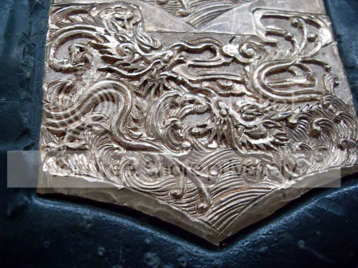

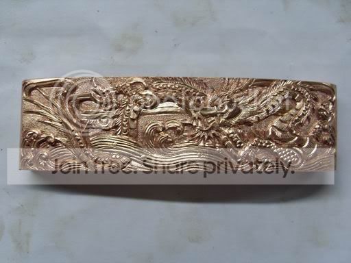

Here i will update the sequences of the chinese sword fitting making's by traditional metal carving. hope you can catch a general view of the chinese traditional metal carving. it is not many keeping untill today. hope you leave the questions or comments here. thanks.
Here is one part of the sword fitting
Sequnce *
Sequnce **

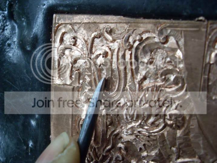

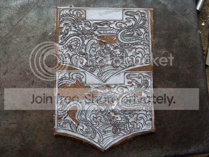

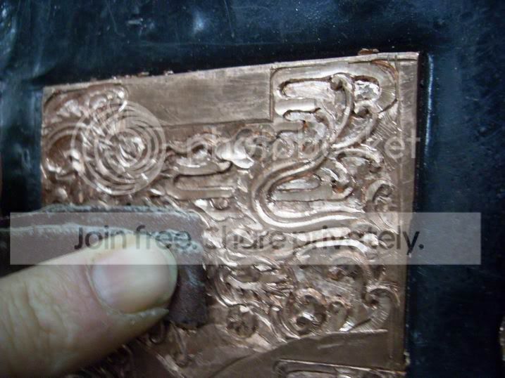

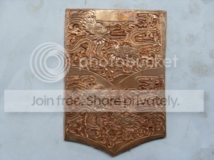

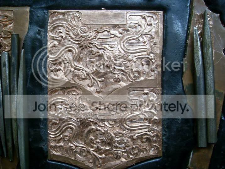

Here is another part of the sword fitting,
You can see some process about the carving
P1

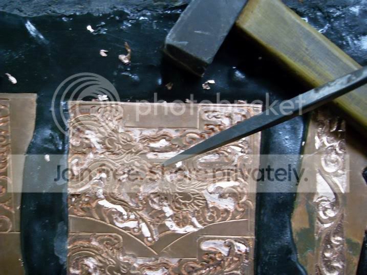

Hairline Carving according the draft glued on copper plate.
P2
P3

Can you explain something for me? What metal is that sheet you're carving? Is it a sheet of silver that had a copper plated overlay on it? Or something else?
Thanks, Phil
PS - Whoops, I see you stated you glued on a copper pattern. Can you explain that further? Thanks.
Xie xie Phil,
Thanks your exaggerated praise. hahaaaaaaaaa
For the carving metal here is a 3mm thickness copper sheet!
Copper is a chemical element with the symbol Cu (cuprum) and atomic number 29.
It is a ductile metal with very high thermal...
It is not a silver sheet with the copper plate overlayer.
Yes, you know that, for the silver, it will be more easy to carving.
brass will be more dificult than the copper. and the brass is more easy than the steel.
Hope this explain is clear for you. if not i will try more.
Sorry, one replying part missing

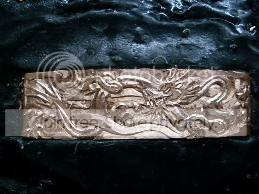

Just for the pattern's shift. from paper to the metal.
The sequence, Draft Paper glued with copper sheet tightly, then start the hairline chiseling following the Draft Pattern.
aim to get a copy draft pattern on the metal sheet.

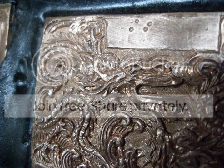

Hello Wu,
I see the reddish pink look of the copper in your beginning photographs, but the metal starts to look more silvery white in the photos of the progressively more carved metal. I guess it must be how the light hits the carved metal that makes it look that way. Thanks for the explanation, and once again for the sharing your work with us.
