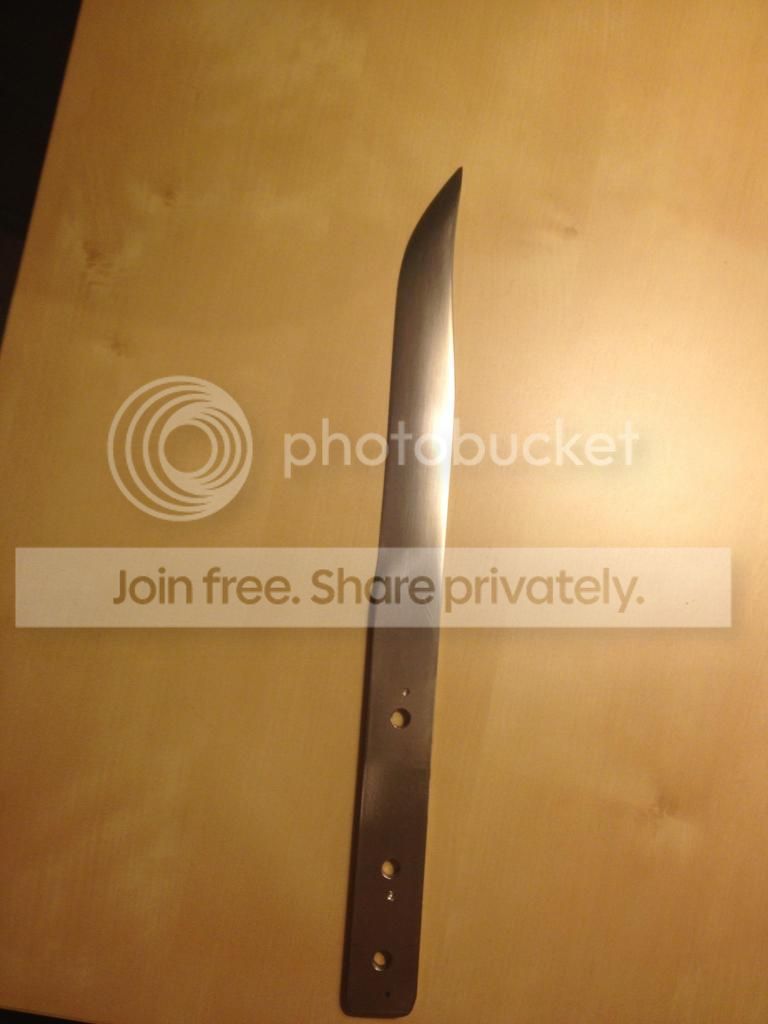

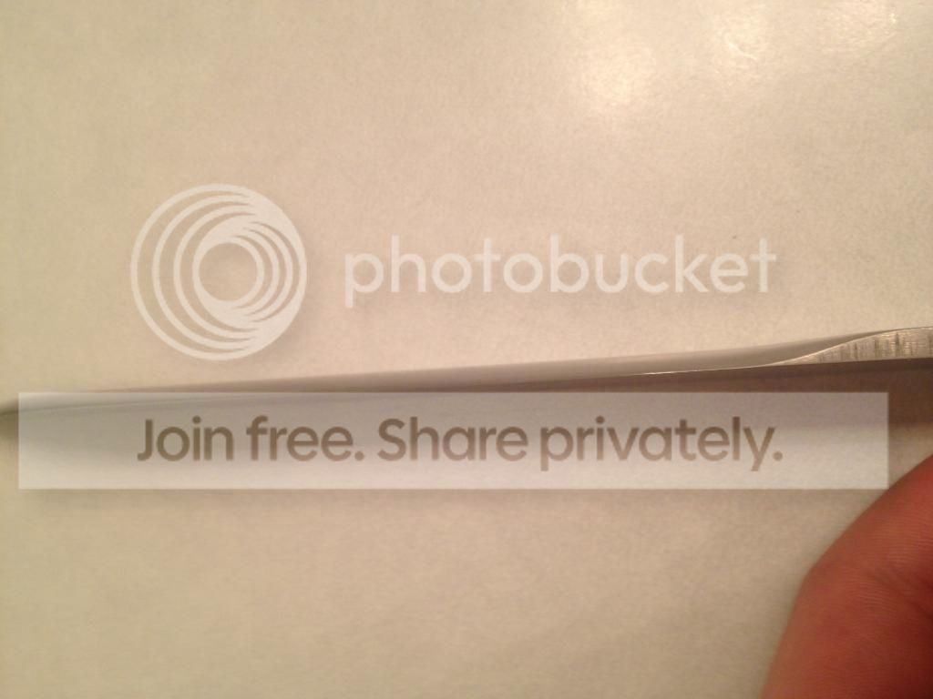

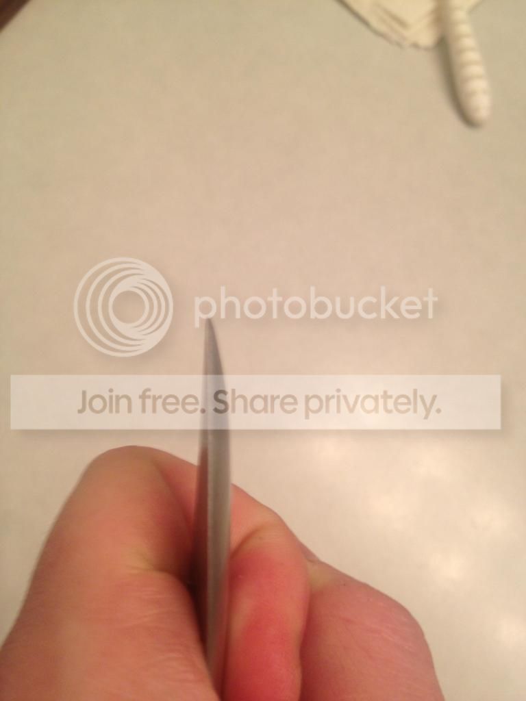

3/16 s30v
12.5 OAL
Chisel convex ground on the left for ease of sharpening.
blade will be 7 from scales to tip, handle is 4.5, extended but 1 (100% true to the original I have [same with the non centered pins as well and unfinished butt])
This knife IS a stabber/Fighter. Not utility. Just like the original. I thought I could improve on its usability by using stainless, convex chisel because its strong and easy to sharpen. I did have a strong influence from my Friend Fikes.
This is the first time working in S30V for this kind of knife so I don't know it's capabilities.
Based off the pictures should I grind the convex more shallow? (more thin)
I kept the point pretty steep and thick.
