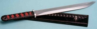

I made a chiseledged Tanto of A2 steel, 3/16" stock removal,
making it zero edge bevel and actually took that to cutting
several limbs off of some offending trees that were in my
path to the mailbox, sweet! and it didn't hurt the edge at
all...Chefget now has that knife...Blade is 11 1/2" long
with cord wrap over red sting ray, thanks to RJ Martin as
I had to redo the epoxy, went overboard and RJ was kind
enough to let me have a small section of sting ray...
Here is a pic of that knife, been thinking about making a
short sword from the same stock but haven't gotten the urge to grind lately...
