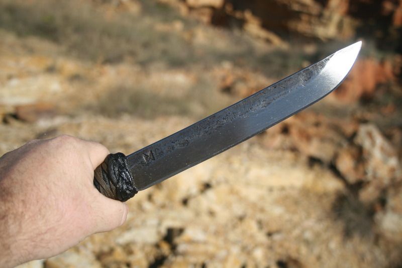

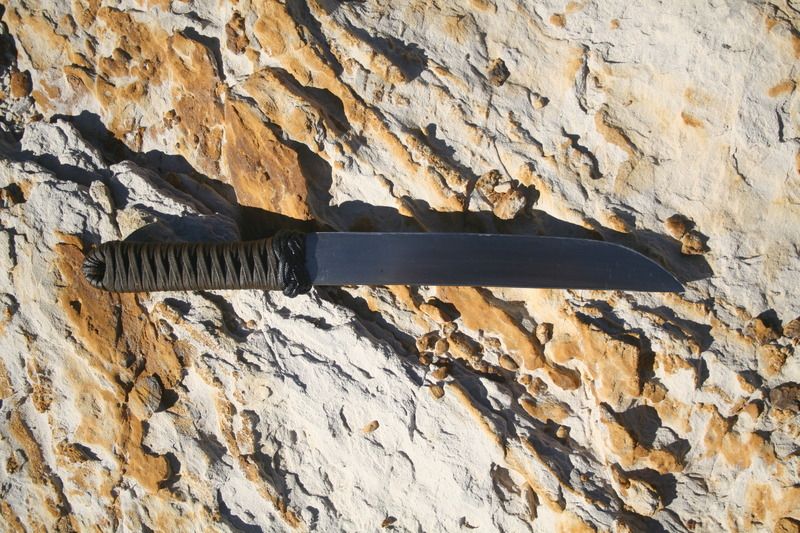

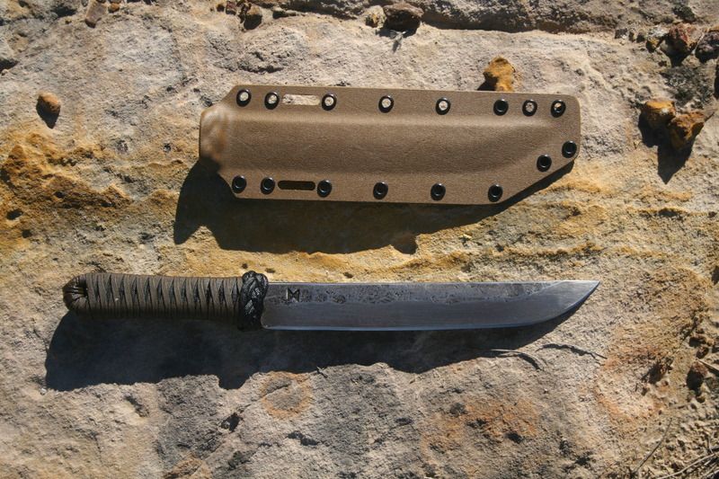

This was a request from a fellow who really likes the work of Phill Hartsfield. Which meant he wanted a chisel-ground tanto with a cord-wrapped handle. We were originally thinking of it as an aikuchi, meaning without a guard, but I tried it with a Turk's head prior to applying the epoxy and we decided to go with it.
This project took way longer than it should have. The issues were largely mental on my part; there were some aspects that were more difficult for me with it being chisel ground, but not that bad. Still, I kind of feel like I should have included a certificate with it like Bob Loveless did with his one Damascus knife. :D
The blade is 9" long, forged from 1/4" x 1" 5160 steel. The spine is rounded. This is a chisel edge for a righty, and I'm a lefty, but I think I did all right. :)
The handle has a foundation of neoprene, followed by black paracord and coyote tan paracord, with a two-strand Turk's head knot, all impregnated with West System marine epoxy.

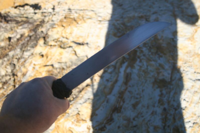

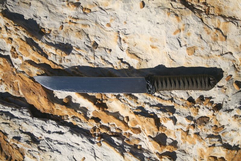

With the lighting and my camera acting wonky, it was kind of difficult to catch the bevels well, but I think they show up better in these in-hand shots.

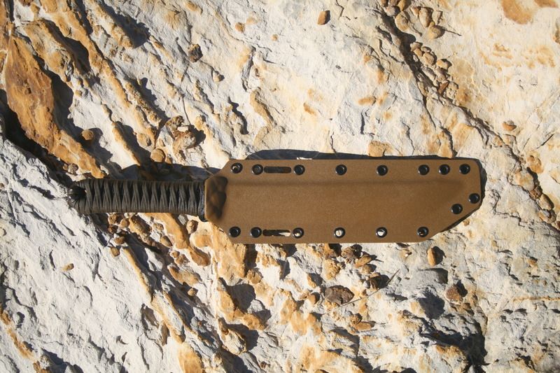

And finally, a coyote tan Kydex sheath to go with it.

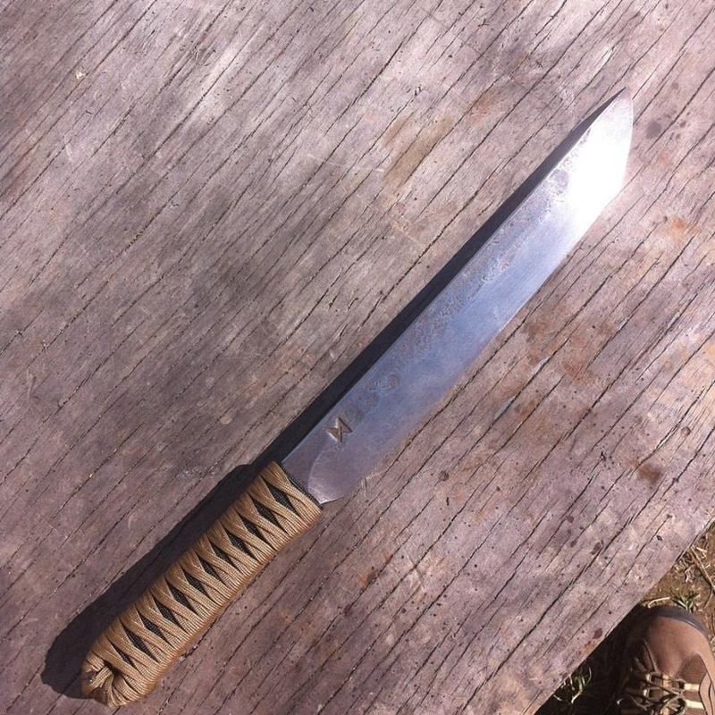

Joe, I sent a length of the same tan paracord with it in case Rolf wanted to rig it with a static line like you do. :)

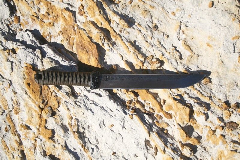

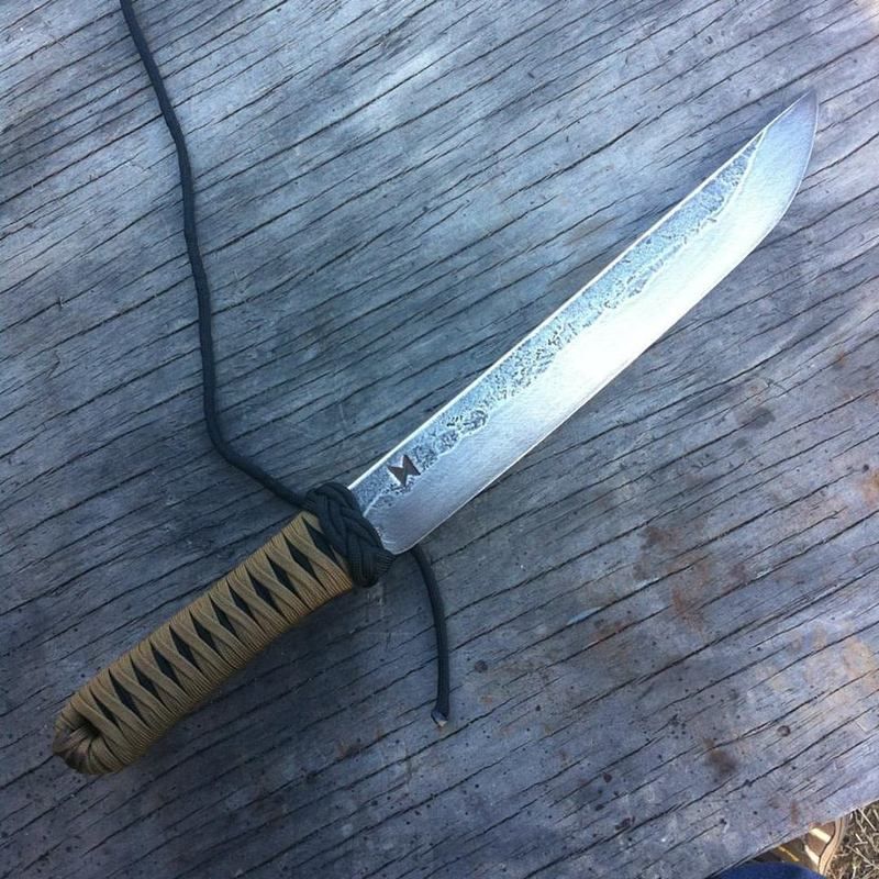

I've been posting my work on Instagram and from there onto Facebook since back in the summer. I knew that Lycosa was following along on Facebook and we had talked about the possibility of going wither with or without a Turk's head. So I posted a picture without and asked what he thought.
He had me try it with a black Turk's head knot. I did a two strand to keep it small since aikuchis are supposed to be guardless, and he approved.
You can see how much the epoxy darkens the color of the paracord.

Hi Rolf. What are your thoughts with and without the Turk's head knot. I'm liking it both ways. The knot definitely looks good, adds character, and will help prevent the hand from slipping forward. But I like the simplicity of not having the knot also. Tough call for me. Mike
Mike! Both do work but the knot gives the blade that Japanese style look.
Buy using a palm-loaded grip, the hand will not slip forwards while thrusting.
Makes sense, and I do like the Japanese influence. Thank you Rolf. Mike
