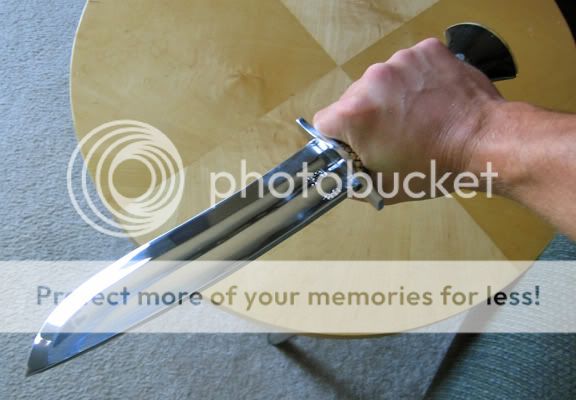

Here are a couple of pics of the first prototype Chitlangi Bowie in my hand. It is a pretty good sized blade, mine is a little larger than Steely Gunz, measuring in at 15" exactly. The handle really is large. I have medium sized hands, and it offers enough room to choke up on, or down for heavy chopping.
And as you can see in the pics below, it has about the same length handle as my 20" Chitlangi, which it was based off of.
HI should really consider making it a regular offering, I think it will appeal a lot with the general American public, and others (like me!!).

I agree with you. This particular blade has a real "feel" to it. I don't know how to describe it. I've handled well over 50 or 60 HI pieces from blades of 3" in length up to over 25". Straight, curvy, light, and heavy. I have never handled a piece that balanced so...well, powerfully. It's like Vim figured out how to compress the raw power of an 18" khuk into a sub 15" framed straight knife all the while keeping the balance on par with my very coveted Cherokee Rose.
I have always liked the look of the Chit Bowie. However, I had no idea that it would take the raw chopping power of my beloved AK bowie or Munk Chunk Cleaver and the stunning balance of the Cherokee Rose and roll it into a blade that is so capable yet so compact.
Lefthandblack set out to design an all around big camp knife. He succeeded. It chops, but it's controllable. It slices and cleaves, but the balance makes it feel like the blade is doing all the work. You just WILL it...and off it goes:D
Personally, I think this blade is PERFECT at the 14"-15" range as far as size/weight/packablity (<--my contribution to the English language:D). While some of these bigger monster Chit Bowies look great, and I'm sure they are fearsome, this knife at around 15" will handle nearly every camp job with speed, control, and do it efficiently.
I just sharpened the blade up after destroying 2 pallets and several thick cardboard boxes. It takes a MEAN edge. I used a little NuFinish to polish it up and put some wax on the blade. Man...it is awesome:D
