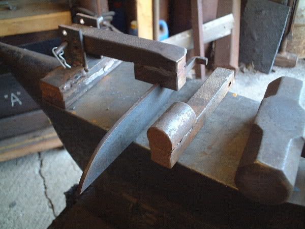

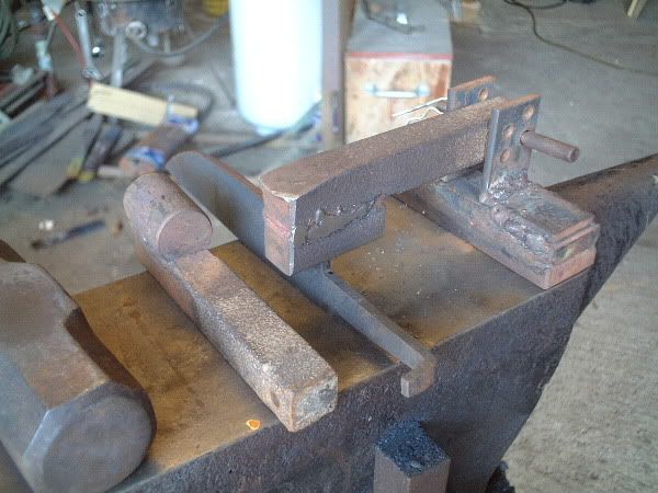

In an effort to continue Robert Dark's post on a "neat tool" I thought I might post one that I use on nearly every knife I make.
No, my anvil is not shiny.
It has an adjustable height by means of a pin in the shaft of the "banger".
This allows the head to always remain parallel with the anvil face and not shape the choil irregularly.
A post welded to the bottom for the hardie hole.
Head will flip back out of the way is anvil face is needed.
I have a few different configurations to accomodate different choils.
Made from scrap, and has a zillion uses. All sorts of different shapes can be used.

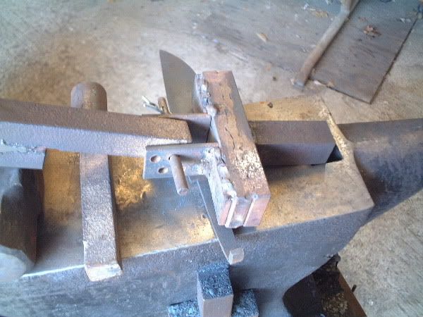

That's a "neater" tool for sure :D . I couldn't understand the use of it at the 3rd pic. Can you explain a bit. Is the tool just lying on the knife or does it do a job there :confused:. Thanks for sharing...
I just pulled it up out of the hardie hole to show the post welded on the bottom.

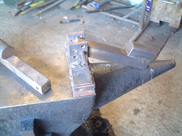

Really good info. I do have a couple of questions.
The portion that goes into the hardy hole (the post) is it quality steel or something like a black iron?
I assume that the striking portions, where you hit and the underside making the indentations has been hardened, and what kind of steel did you use to make those parts from.
I happen to have 1 inch square 5160, that I think I used for this, but none of it is hardened.
In making fullers and other metal moving tools, it is unnecessary to harden them. A piece of warm steel is already many times harder than a piece of 1800F steel.
