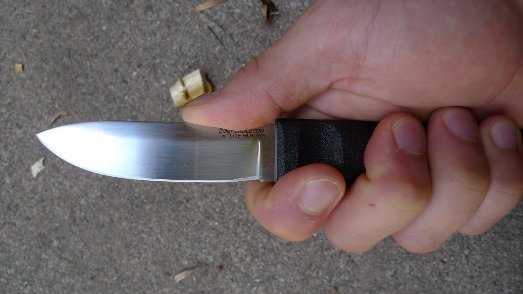

Here is an example of a SHSJ I sharpened the choil on, which ended up being not worth it because when things caught in it, I ended up having to reset the edge anyways. To get over the corner you'd have to pull hard, and the material would jump out of the edge with the built up pressure and it just wasn't worth it. I don't want to have to think about my knife when I'm using it, and I don't want to have an edge in my choil if my finger is going to be in it. (Ignore the top knife, it's a thin NICK I cut down and further modified later on)
In order to get it to not do that, to get it so the media would simple slide into the edge as though it were choiless I would have to do a drastic reprofiling of the choil to create a straight line or a very shallow slope, something like what I did on the pendleton hunter from CS. I really don't want to have to carve into the knife this much, I'd much prefer to just avoid it all together and go with the choiless version. Back when the SHSJ was around I didn't have an option, but now theres no way I'd ever buy or carry a choiled version. It's just not worth the hassle for me.

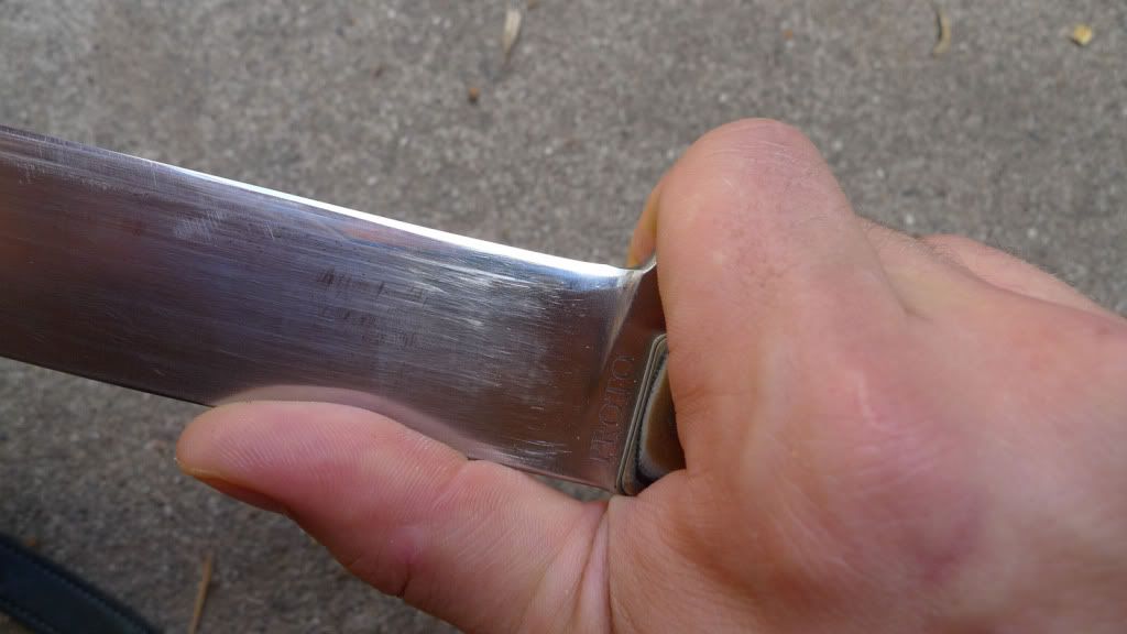

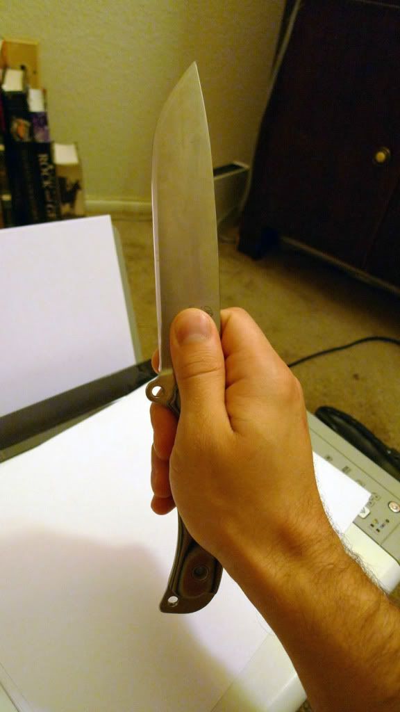

Look at how far away the edge is from my index finger:
This is most important when your exhausted and your hands are shaking from exertion. Look at how the edge creeps away from the hand in this series of knives:

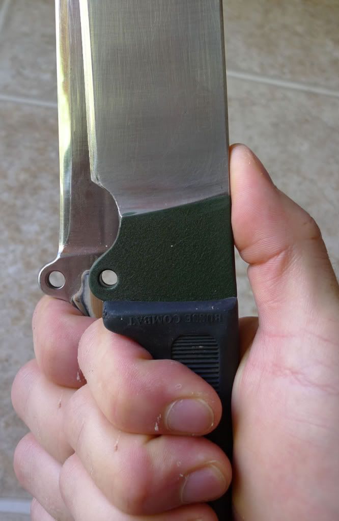

The comparison isn't fair to the BJ vs. CBJ since the B11 has extra handle material in it. so heres an edited photo to show a gaurd to gaurd line up of the two

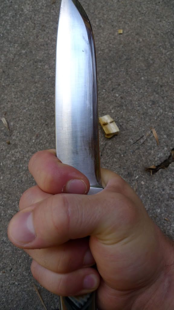

That 1/2"-3/4" distance is significant when your trying to shave hard wood shavings. Also, I've never had a problem getting my hand closer to the edge on the choiless version:
