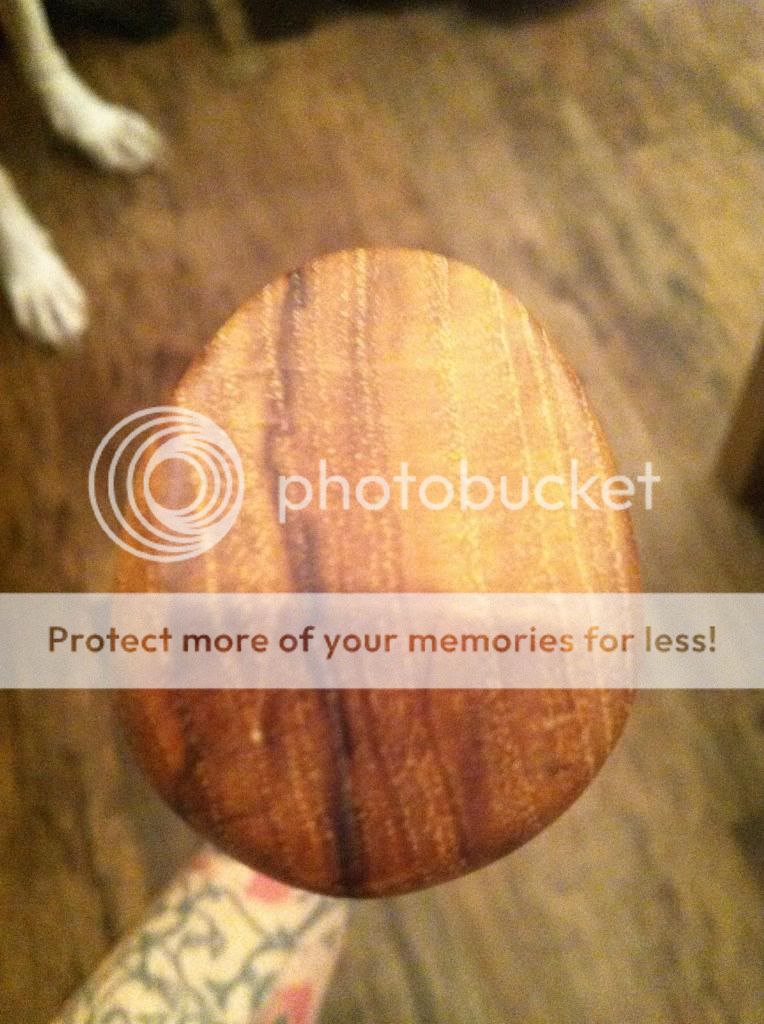

I hope that grain doesn't fully cross the haft. Grain run out is the 2nd biggest cause of haft failure after over strikes.
It does run out but comes nearly the full length. A good deal of the grain doesn't run out so we'll see how it fares. I'm guessing it'll do just fine with just a two pound head. Not going to see daily use anyway as I plan to use it for camping which happens at most every other week. If worse comes to worse I'll have a new project on my hands.
My dad's axe, which has been around since I was a lil one, has much worse orientation and run offs than this and is still going strong. He heats with wood in the Adirondacks so it sees a lot of use. I believe he just avoids the knots as I plan on doing as well.
Can't disagree here at all but most ordinary folks are unaware of such deficiencies and as long as the axe is not abused or over-used is not likely to surface as a defect either. And if it happens, by gosh, they then get to rehearse all of the 'ten commandants' of optimum haft selection and re-hanging of an axe so as to truly make it 'theirs'.

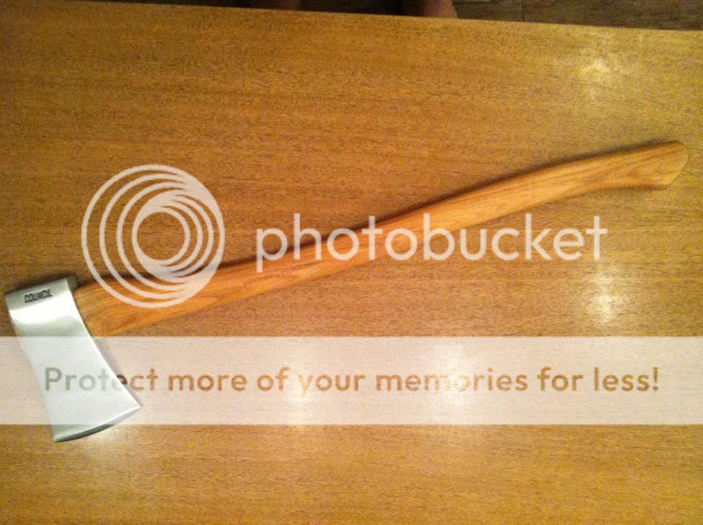

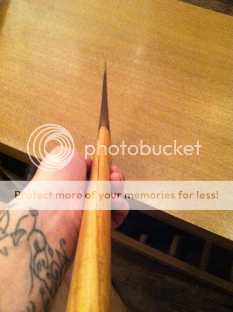

Thanks MrV, nice shots! If I knew I'd get one like that, might have to go for it.
I am not a photographer, obviously.
Ya done fine. The profile looks really good. I gotta hand it to Omaha Knife for a job well done. The most that could need is a touch up. Likely fine just as it is. And I'm being picky.
