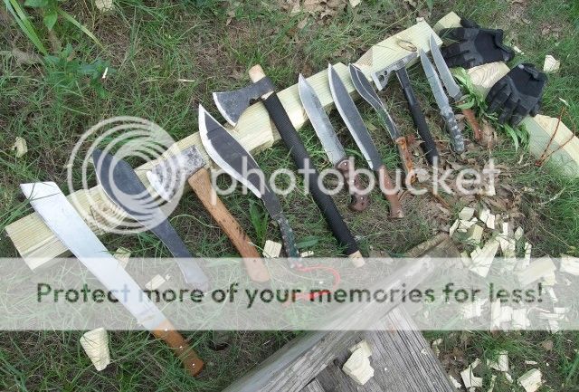

Had a few questions asked, and had a few thoughts I wanted to resolve in my own mind. So I pulled out all my knives/blades I consider ''Choppers'' and did a lil informal test. This isn't scientific...it aint very conclusive, and I hope if you don't agree with my findings that you maintain civility. This is what I found and what I think....you may have totally different findings/rankings and that's fine, I hope that all of you test for yourself and see what works for YOU

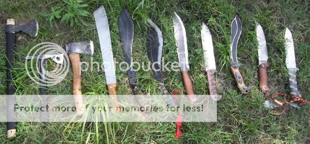

The contestants
Wolf Creek Forge Tomahawk
SOG FastHawk
Plumb Hatchet
Modified Tram machete
Crimson Falcon's MegaChax
Thai Enep Size 0
Fiddleback Forge 12'' machete
and for the Becker portion...

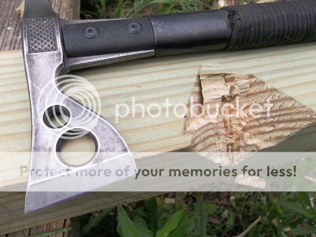

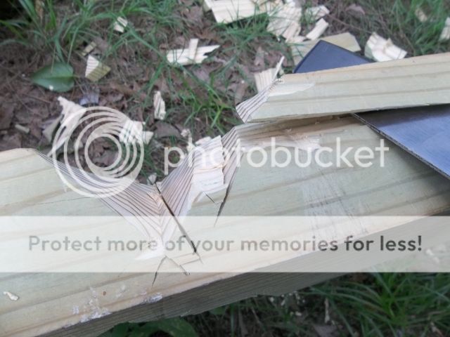

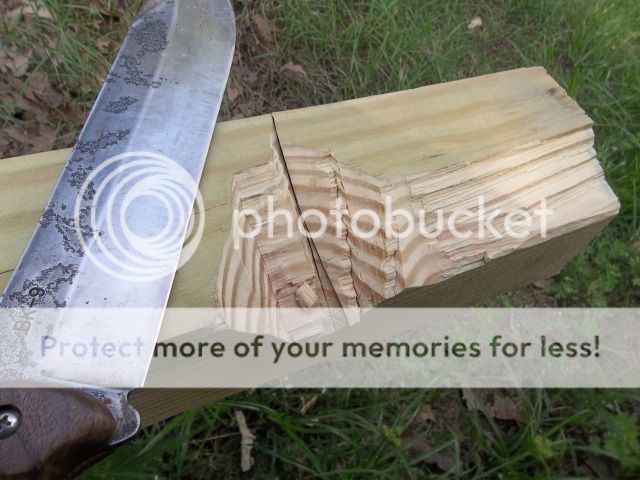

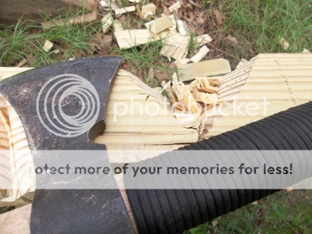

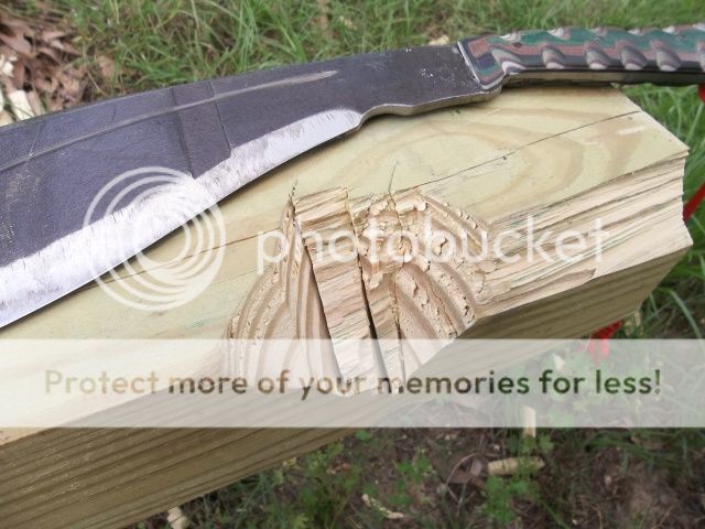

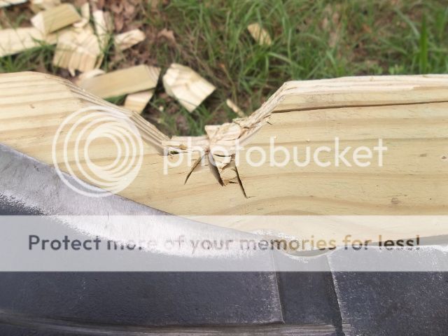

I went in random order. The knives I haven't chopped with yet got one practice run, then the ''real'' one. ~10 chops per blade (maybe 11 on some who knows). I rested and made sure I was at same strength for all the blades.

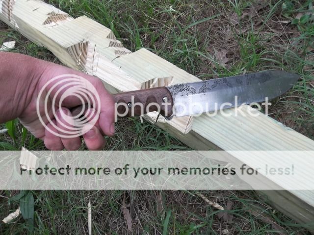

This is the hold I used for every blade...as far back on handle as I could, usually 1-2 fingers and a thumb grasping the handle. I used gloves and a lanyard when possible.

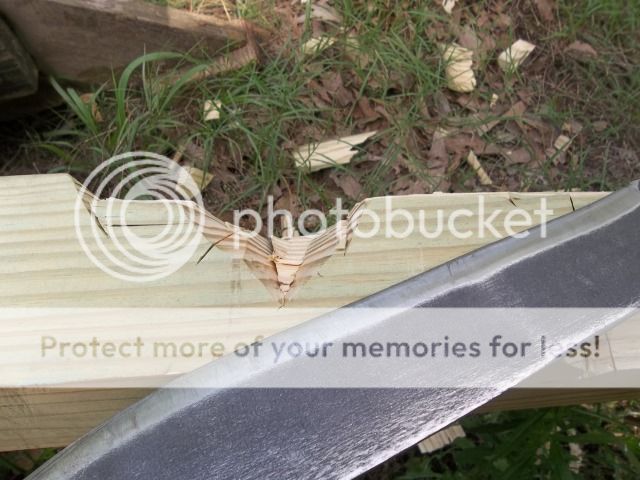

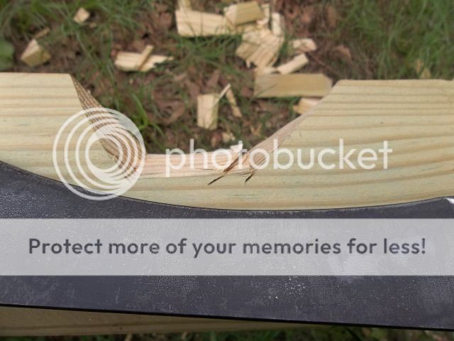

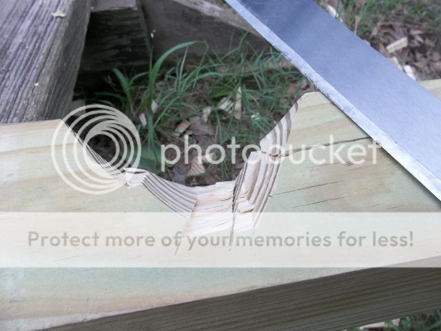

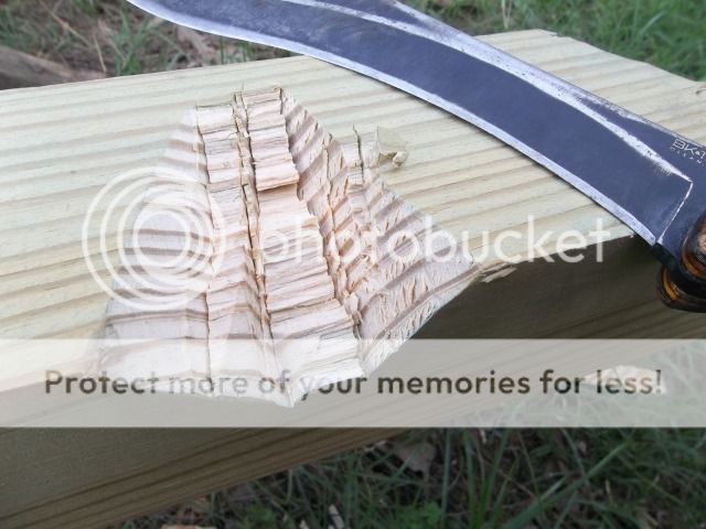

medium is a almost new pine 4x4. I took two pics of each knife's notch...one from each side/angle

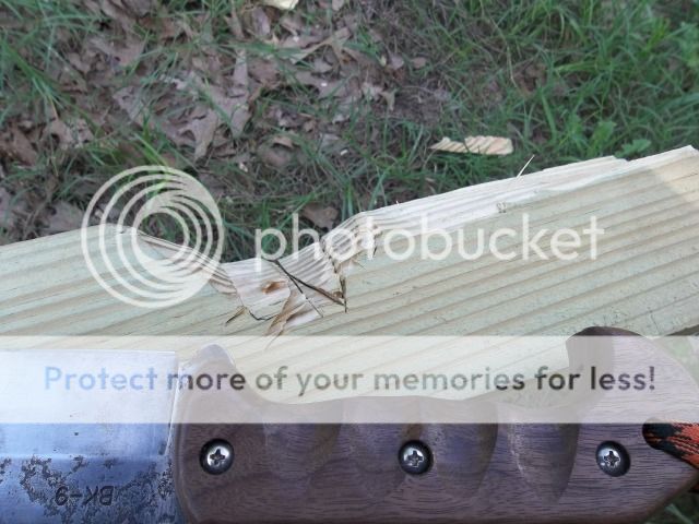

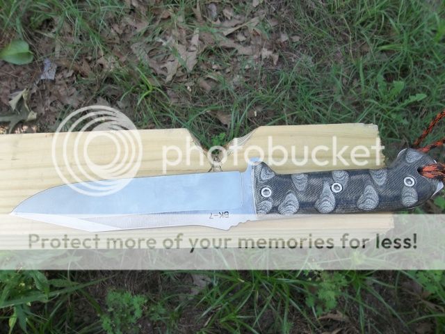

The BK7
BK9

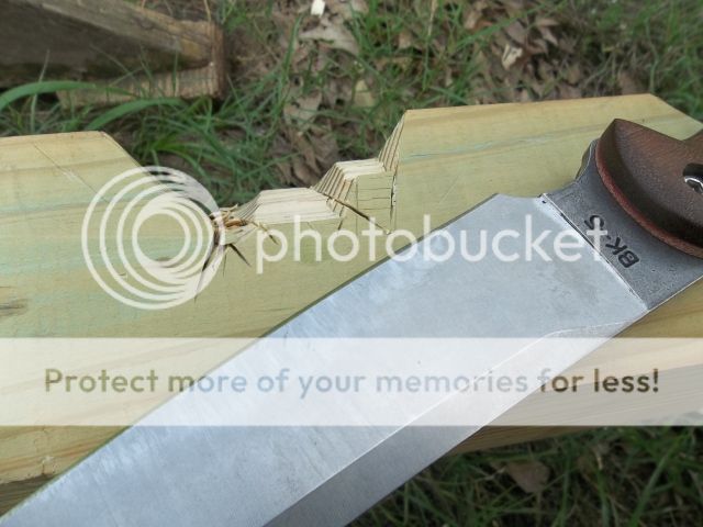

BK4

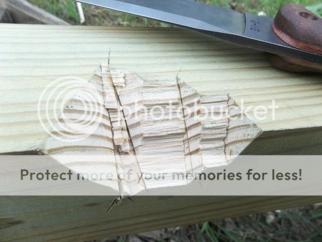

BK5

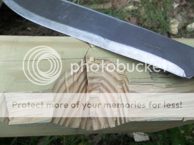

FBF 12''
Enep
MegaChax

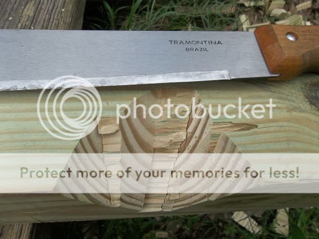

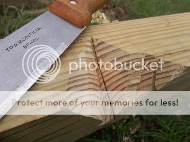

Tram

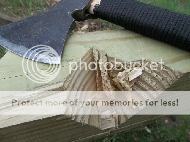

Wolf Hawk
Plumb

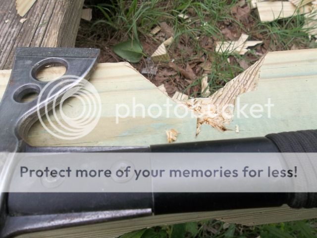

SOG
The Tram won without question, I was expecting that. I was a lil surprised about some of the others and how they placed. The WCF hawk was VERY unwieldy to chop with, as a matter of fact both hawks are kinda difficult....not much area to hit and the straight handle dont help. The lil Plumb surprised me, chopped well and with accuracy. The 7 was pretty nice, not as deep as the 9 but held up well. The 5 sticks....very deep cuts but not much ''break-out'' or chips. I find it easier to do THIS kind of chopping with straight knives then the 3 curved ones.

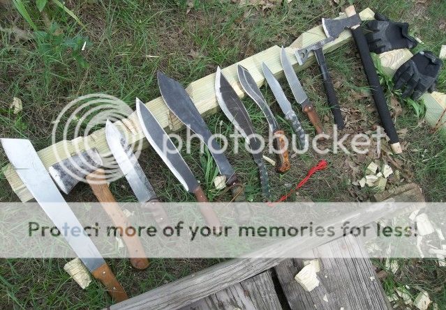

This is a pic of how they performed...based on notch depth
This is how I ranked them by OVERALL use....ie notch depth, plus comfort, ease, and accuracy.
These would be my first choices to carry in the woods for just power chopping.

The scales on the 9 are the new Xtreme Chopper scales by Tommy The Who. I will be testing/reviewing them more in depth at a later time.

Those are the new Xtreme Chopper scales from TommyTheWho

I know the way I ranked them at the end doesn't seem to bear up by the chop results...but a large part of a knife's real-world usefulness is in how it handles/feels not how it performs in a controlled test. I just feel more comfortable with a straight blade....and part of my choices were based on actually Packing the blade around and not on how it worked. The Enep is a chopping beast, no doubt in my mind..but it is very heavy. The same is true for the Wolf hawk, heavy and long.
Part of it is value as well. I really enjoy the Fiddleback....but at a price point of 110$ shipped, it just dont perform to it's price. IMO, no intent on starting a flame war. The 9 is ~30$ cheaper and I would trust it better for many tasks besides chopping, and the 9 and FB were almost neck-to-neck in chop power. I'm sure the 18'' Fiddleback would perform much better....but I could buy a LOT of Trams or Imascas for 110$ (the FB is a Imasca with better handles and grinds)
The Tram is long...but very light. I need to buy a digital scale, but I doubt the Tram at 18'' weighs more then the 9. It packs easily.
The 7 jumped so much because it is a powerhouse for its size. Not that far behind the bigger choppers...yet highly portable. The 5 stayed low on the list because it sticks so bad. I like to see large chunks flying when I chop....not to see a blade sink deep but just leave a small groove in the material. Also uses more energy yanking it out for the next swing.
