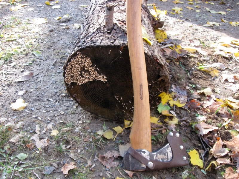

i start with a log. this one is hemlock i think...

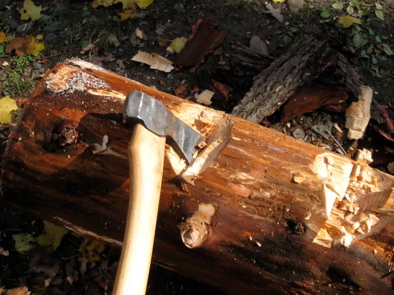

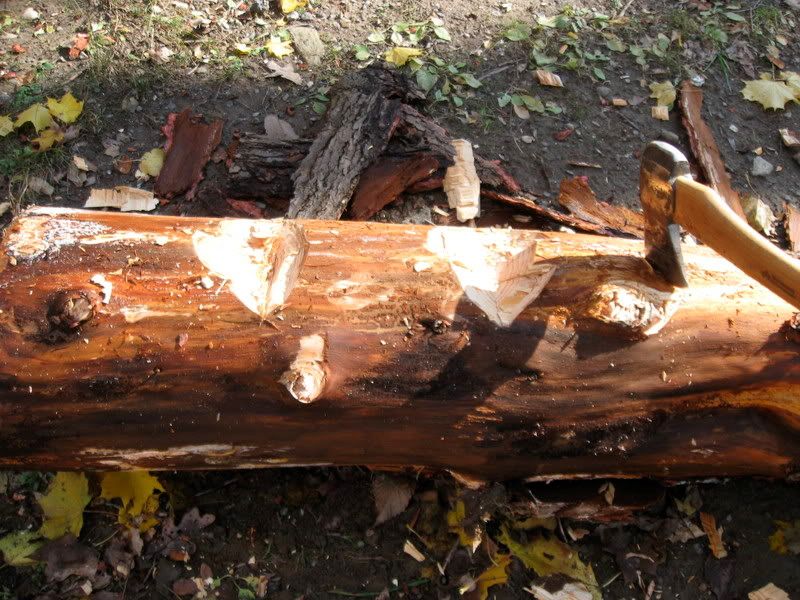

first i strip the bark and start two small notches a little farther apart than the diameter of the log. take note that these notches are a little too close.

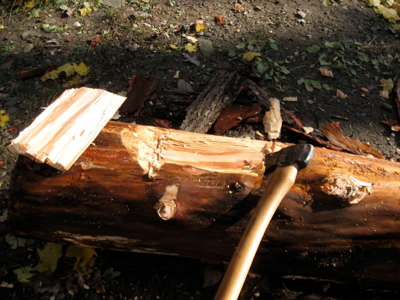

take several swings all along the sides of each small notch into the middle. keep swinging until your first chip pops out.

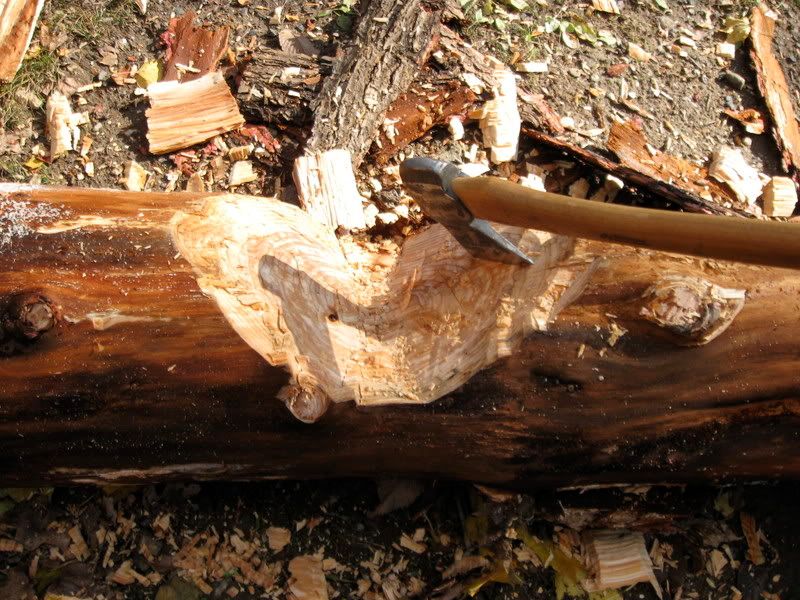

keep going at the same angle, swinging along the same lines. keep popping out more chips.
keep going until your notch bottoms out. at this point you could widen the notch and keep going from this side, but it is easier to just roll the log over. if you are bucking up a whole tree like you probably would be in the woods, i would suggest you keep going from the same side or chop your notches on the sides of the log instead of the top. chopping on the side of the log is far more dangerous though, and it keeps you bent over the whole time, which hurts...

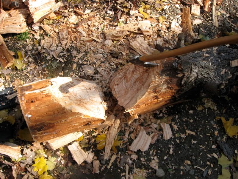

roll the log over and start the whole process over again...
(five characters)
eventually you will cut all the way through.
