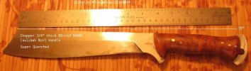

Bladesports + flares specs: Incidentally made knife
1/4" 80CRV2 (src from NJSteelBaron)
16.5" OAL, 10" edge
Ht with Super Quenched, final hardness 59RC
Polish sharpened edge angle between 23 to 25 inclusive degree
0.018" thick behind the edge
1 lbs 9 oz (716 gram)
Coolibah Burl handle
Chop: 2 times 2x4 Douglas Fir board
Note: Time & Chop-count can be improve with more practice (this is my 4th tried). And a better setup would help too :)

Thanks Jay!
Nice chops!
Reminds me of the Martindale Golok and O'Katz handmade handle.

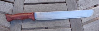

Here's my thinner chopper
Forged 0.14" CruForgeV (src from Alpha Knife Suppy)
17.5" OAL, 11.5" edge
Ht with Super Quenched, final hardness 54RC
Sharpened edge angle around 30 inclusive degree
15 oz (426 gram)
Figured Bubinga handle

17.5", 15Oz. Wow that's an excellent combo.
I noticed some nicks on the edge. Could it be that the edge is too thin?
I'm surprised it's only at HRC54.
Thanks!
The nick/chip caused by bad hammer blows & perhaps overly cool edge while forging. It was micro chipping at 58rc when cross grain chops knotty dry olive branches so I temper it down toward 56rc, brain decided to add 40 minutes temper time, dumb finger pushed 40F degree increased :o Oh well, since edge stability & retention are excellent, so a handle got put on without hesitation. My next CruV choppers will aim for at least 58RC. My smaller CruV knives ran & stable around 62-63rc.
