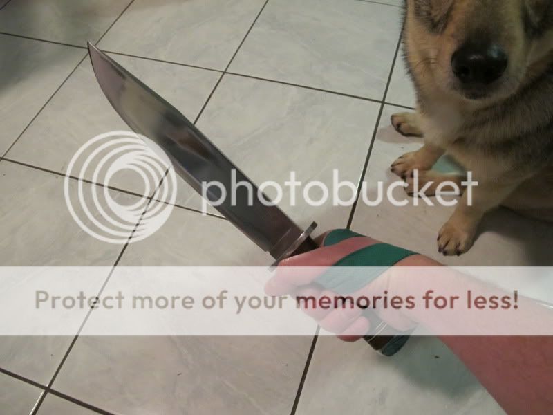

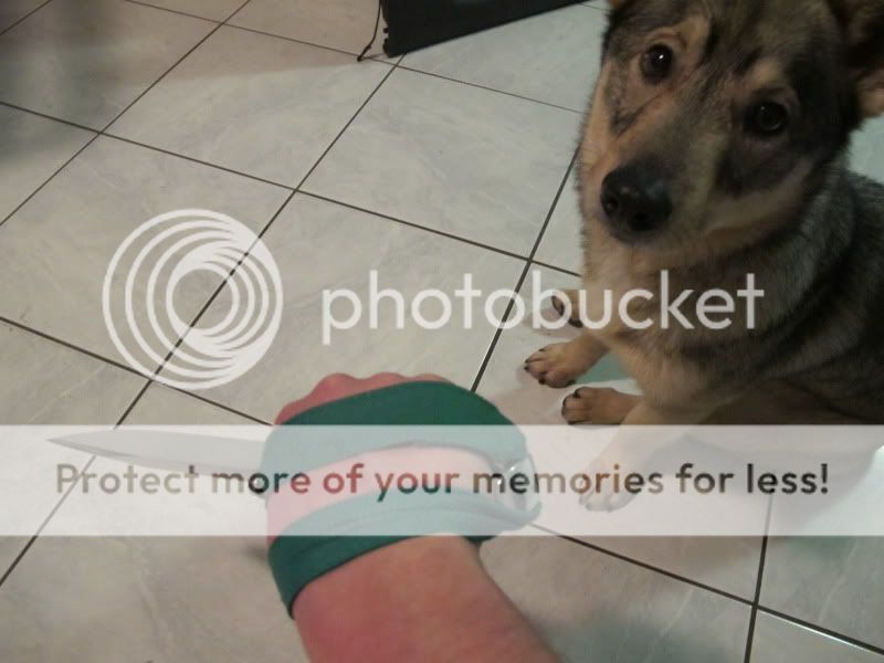

For those who haven't seen this idea (I saw this here on BF), here's a couple old pics of mine showing how I use a lanyard, when you get it the right length, you don't even really have to grip the blade, the lanyard pulls the handle into your hand and prevents it flying out the hand. Also, you can let go of the knife anytime and the lanyard, being hooked around the thumb, will fall over the back of your hand, keeping the knife out the way while you use both hands, when you're ready to go again, the handle is right there when you rotate your hand, very easy to use.
I normally use paracord or leather but this was the strap from a shopping bag!
